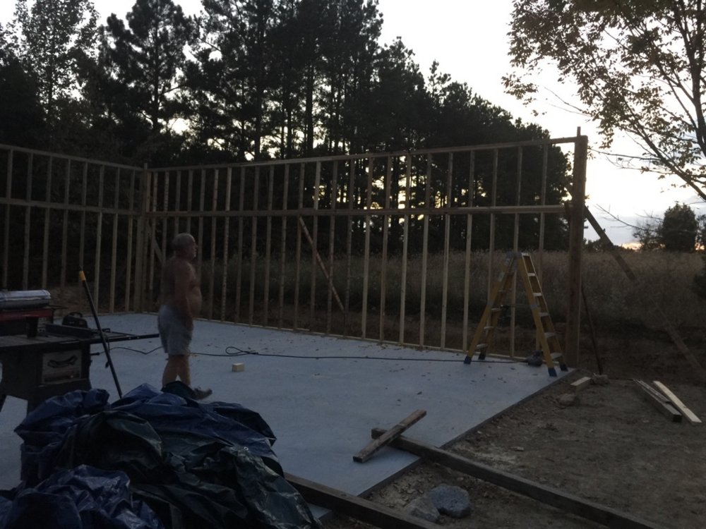

Me and my stepdad are building us a workshop. 38x42 with 12 foot lean to on each end.
12 foot ceilings so i can add a lift. 2 doors etc etc

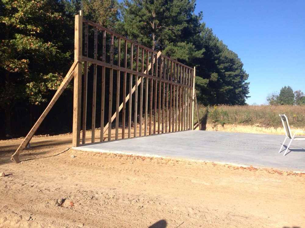

Really easy... We bought a pole barn from our neighbor. Eng rafters with tin roof for $600. We are doing them with 12' 6x6 With 2x12 headers.

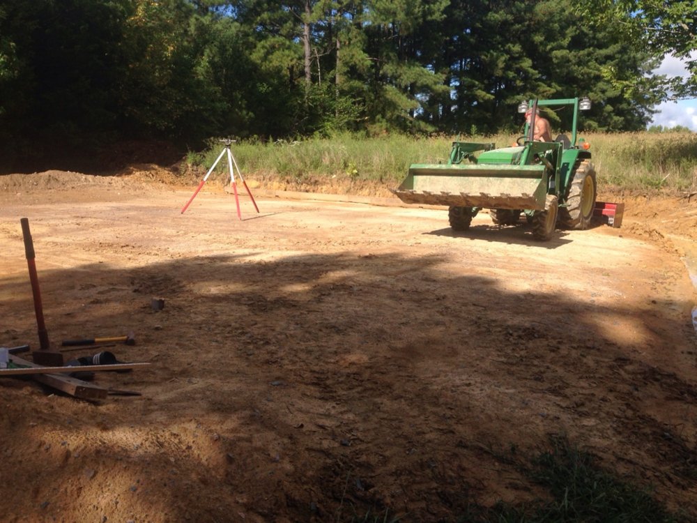

Ok asked dad and he went back and leveled it all to 5.5". I was not here the day it was poured. He used 2x6 for the form and went back and dug out the rest with the tractor and used the transit to check it all.
