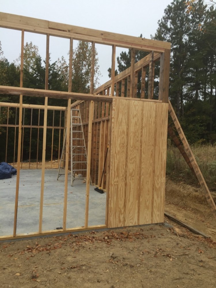

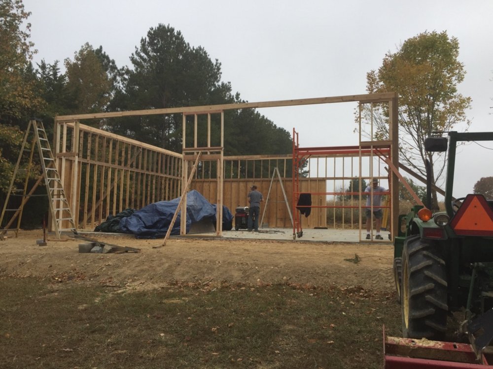

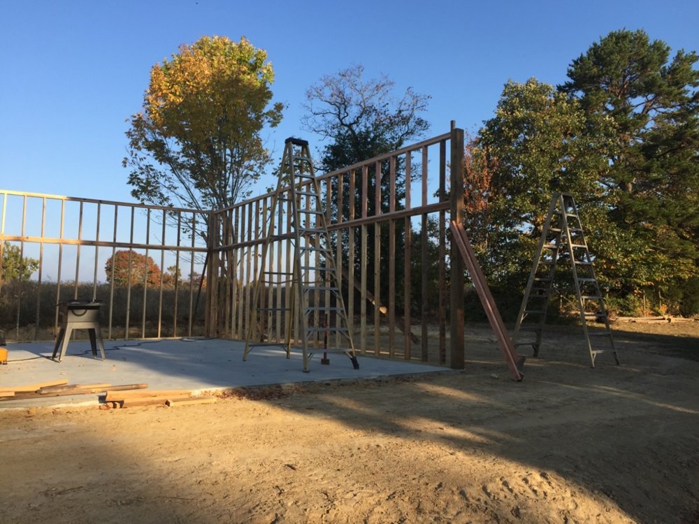

Wall 3 up.

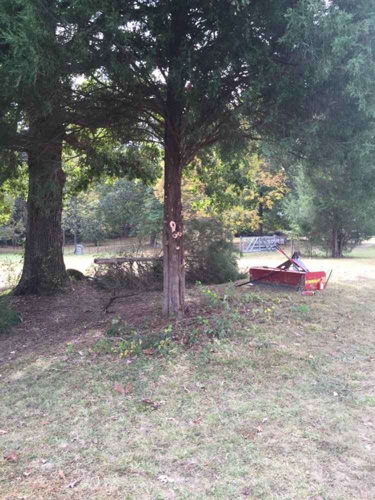

I trimmed up the cedar and took out about 5 little trees..
Another run to lowes and $150 for blocks and more 2x4

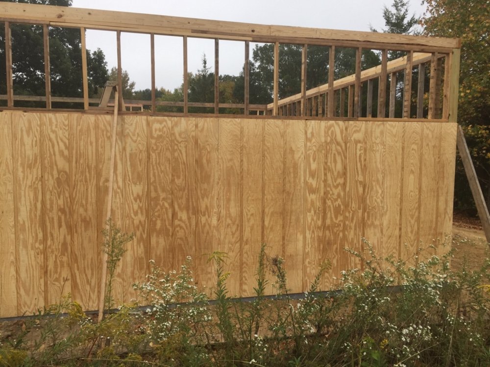

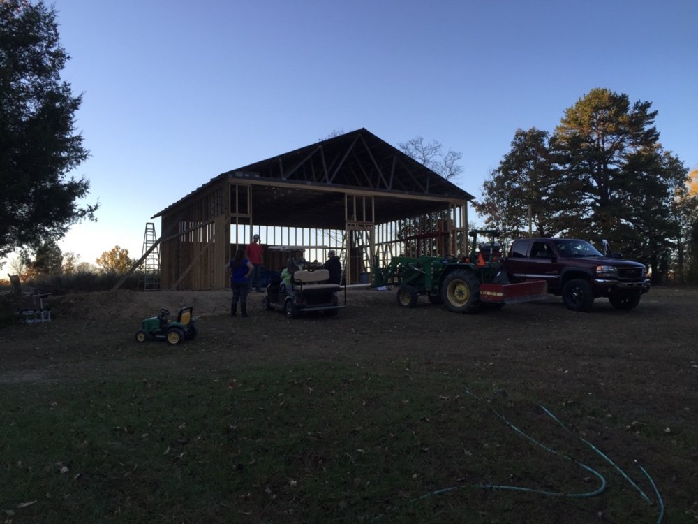

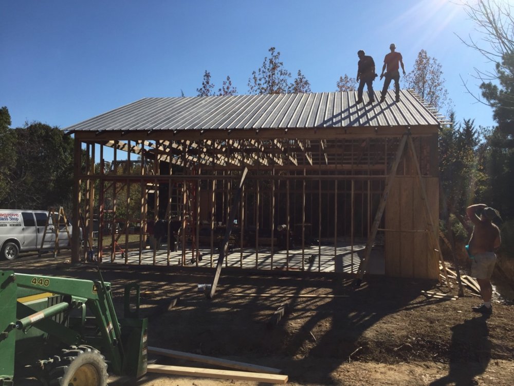

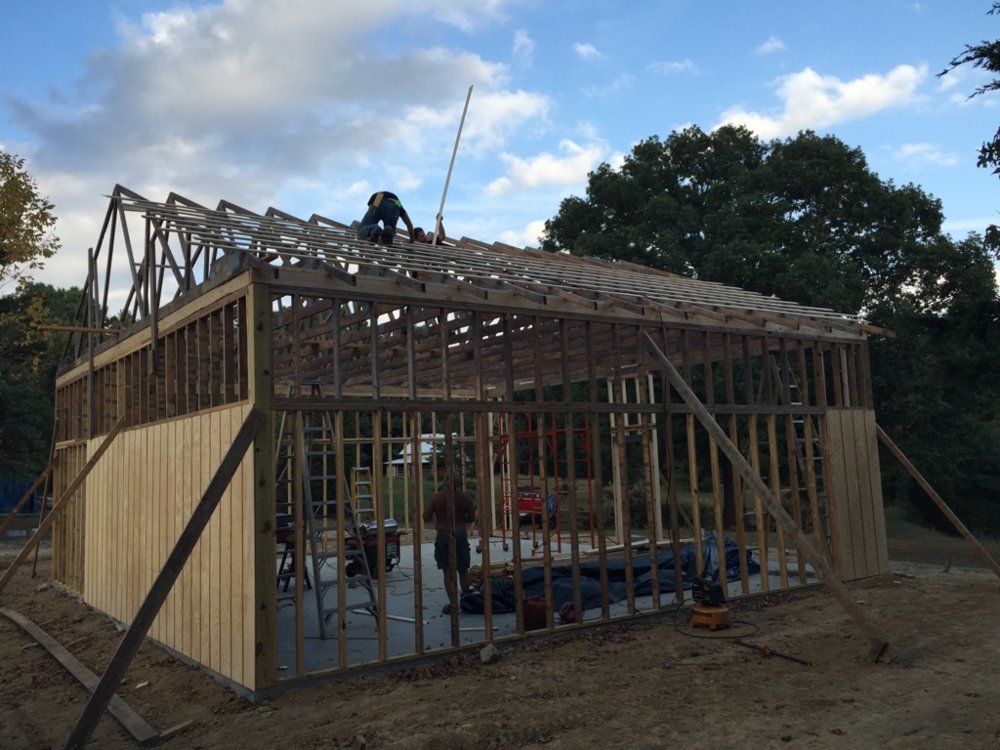

More work done this weekend! Got the 4th wall(most of it) up, headers all around and some siding up. Boom truck hopefully will come by tomorrow and dad and my brother will get the rafters set.
We added the siding on each corner help with bracing till we tie it all together!

Willie and my dad are one in the same. We helped build his house, he has helped us on many projects. He and dad hunt and fish all the time.
