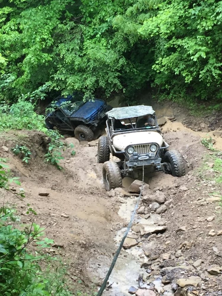

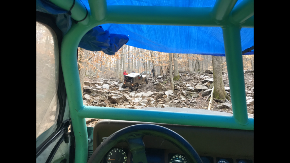

Not the best but a cheap tarp and bungees like you said kept us somewhat dry in Harlan a few years ago. I used some sticks running along the top bars of the cage to extend the tarp about 6” past the end of cage. If I stopped the tarp even with the top of cage water would just run off edge and in my lap the way may cage is shaped. I been saying for at least 3 years I was going to build some type of roof but never have got around to it.

Dig that build. Sprung over front and rear? What leaves and any wrap issues?

Bestop full length bikini top for YJ.
Used hose clamps across upper windshield bar to secure the factory YJ windshield channel. Used the factory style straps to hold it on.
Even tow with it on.
Also use YJ fabric full doors with square corners for wet trips and the cab close out behind the front seats.
It’s far from sealed but makes a huge difference.

Curtis is my good friend and I spent years helping him build that.
It’s a CJ5, cut in the middle of the doors and stretched 13”, placed on a Scout II frame. XJ leafs with a mixture of Dakota leafs. The rear had an anti wrap bar, no issues. But the front would trash the springs in a couple trips.
It originally had a ZJ 5.2 wit trans and a D300. Then went LS/TH350 Doubler.
Literally just now, he’s finishing up a 4link rear/3 link front with coilovers at all 4 corners and full PSC double ended ram steering. He won’t do a build thread, but it’s a sweet rig lol
