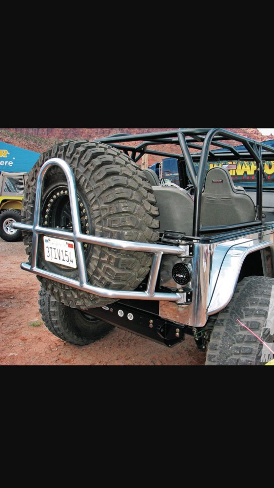

Thanks! I have never seen the "exogate" but, I'm not particularly wanting to mount it that way just seen a cheap way of doing it short term before going to Harlan. I would love to make a stinger style tire Carrie later, similar to this.

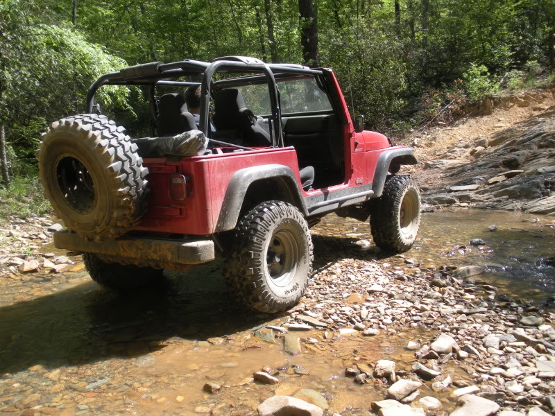

I ran one of those for a while early on in my TJ builld. Honestly it is quite a bit beefier than the stock carrier and while not ideal, isn't bad for a temporary solution. I landed on mine a few times hard enough to bend the mount and it did damage the tailgate a bit as expected, but I never had any issues with the sheetmetal just supporting the extra tire weight of a 33" TSL. A 37 on beadlocks may really be pushing it though. I did still upgrade to a bumper mount carrier as soon as I could. On a side note, you can tell how old this pic is by the fact that that part of URE no longer exists
Exogate is far from a cheap solution. It's quite beefy, and tied to the rollbar in addition to the entire length of the tailgate and corner
Thanks! I am also thinking it would be pushing the limits of the bracket and the trail gate!
I may just have to brake down and spend the money on some Tube and plate and make a bumper and tire carrier!
Yes I agree, I don't think that is a cheaper way Togo. I was referring to the $50 set up of a beefed up stock mount. I like the "Exogate" it's well priced compared to some others I have seen that are the same style.
