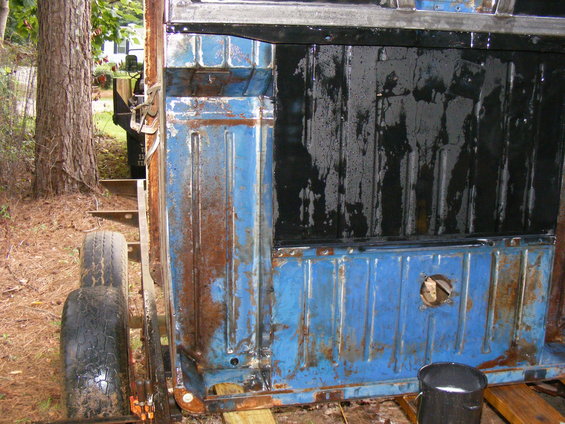

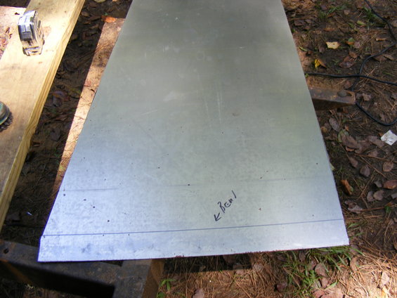

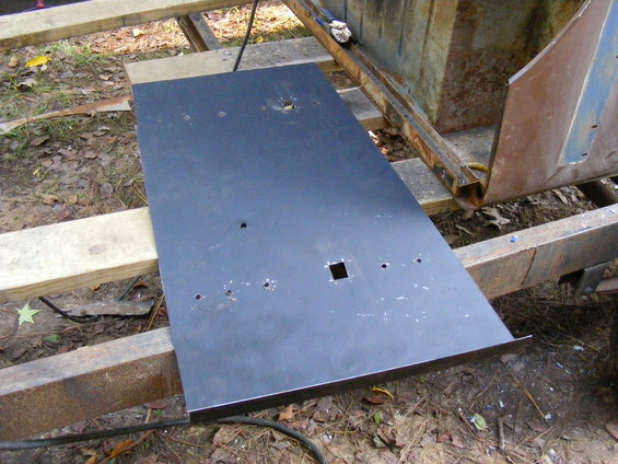

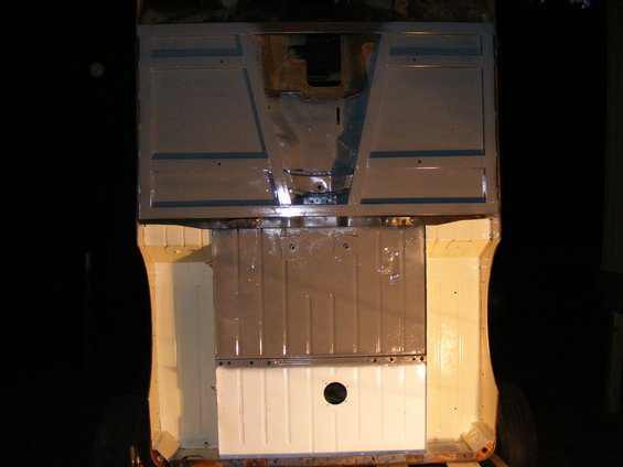

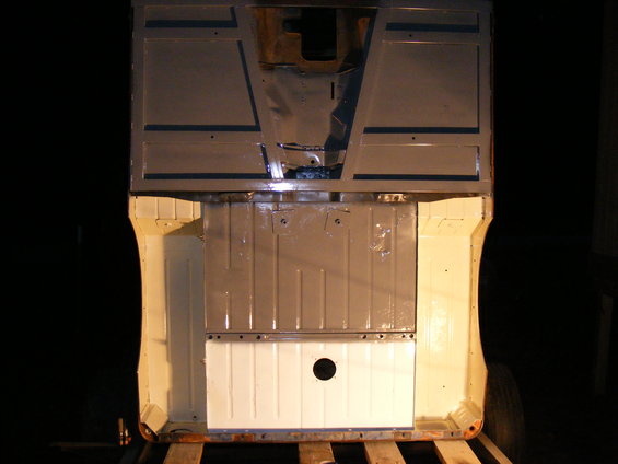

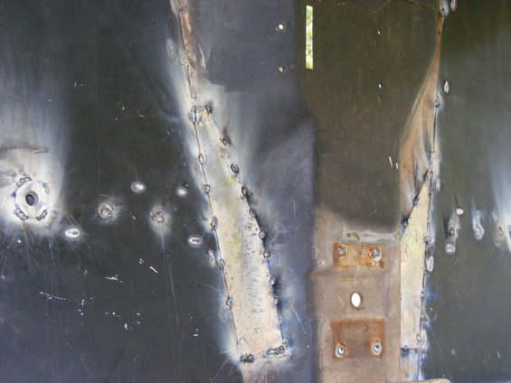

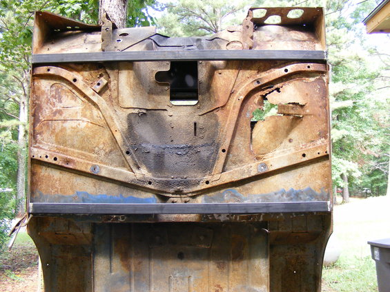

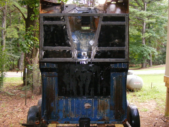

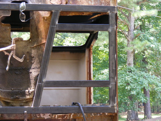

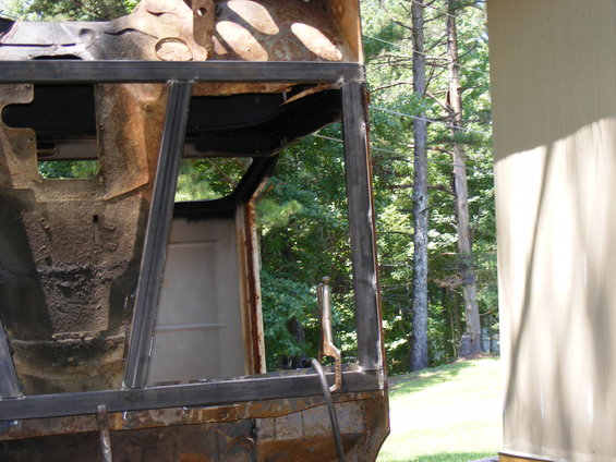

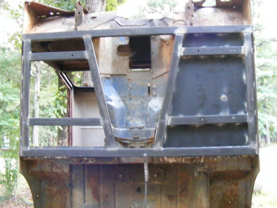

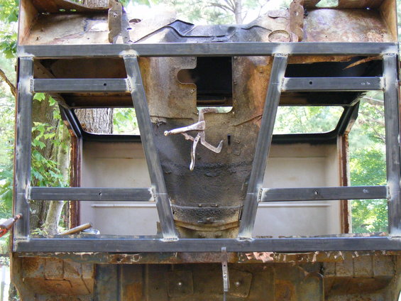

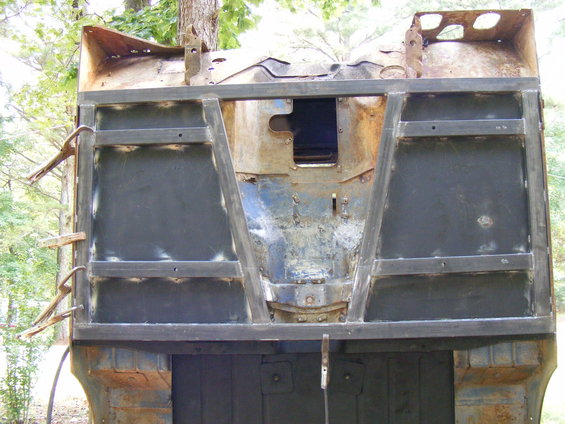

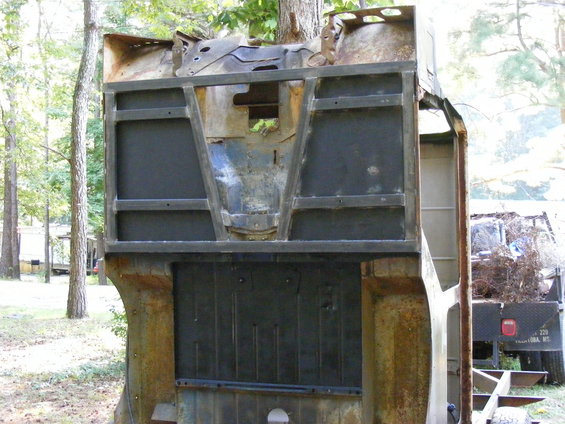

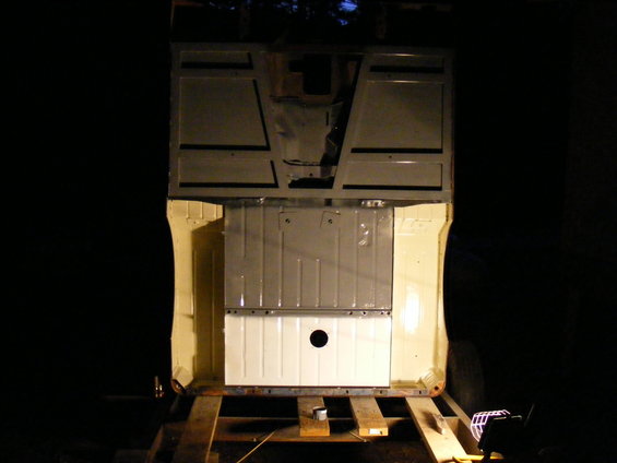

ok so here is pics from progress made today...
start of day...

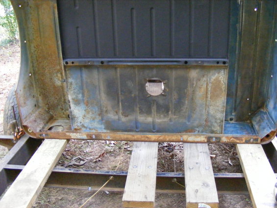

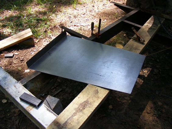

well thats about it for today...long as sunshine holds out plan on getting other floorpan in tomorrow...as well as the few misc pieces that require hammer shape/fitment....then a full cleaning/paint prep on bottom then after that on to paint, seam caulking, and undercoating...well im about wore slap out so night yall....

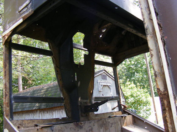

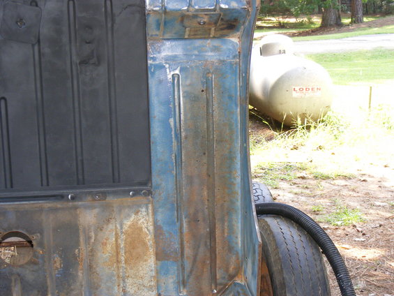

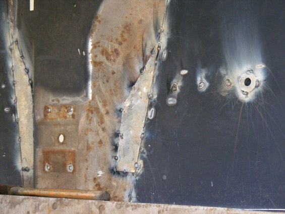

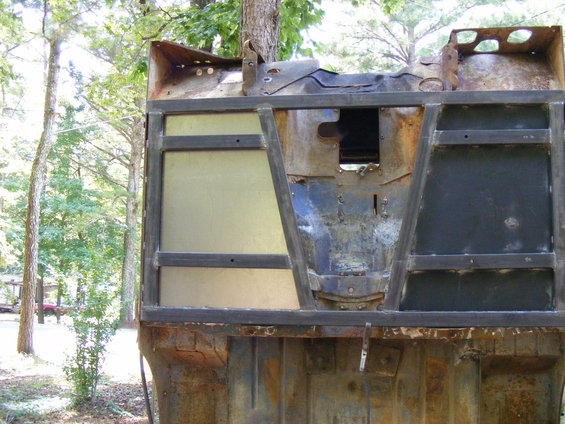

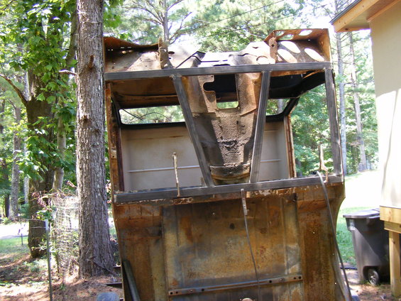

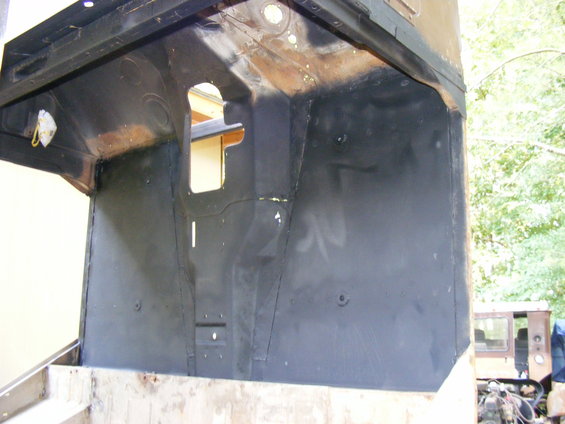

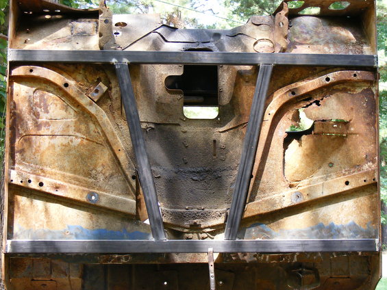

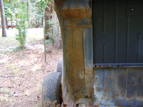

ok pic time haha...

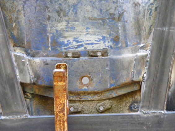

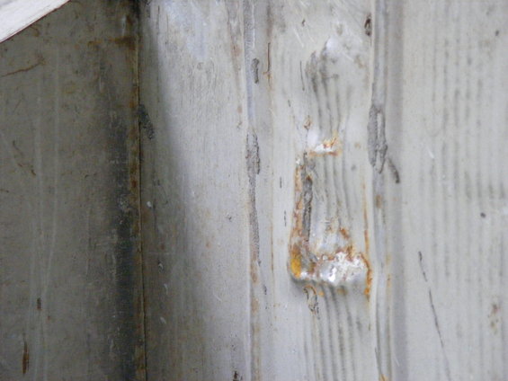

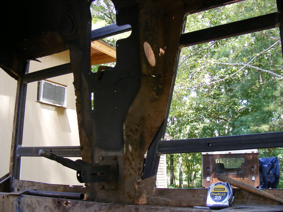

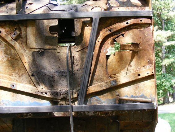

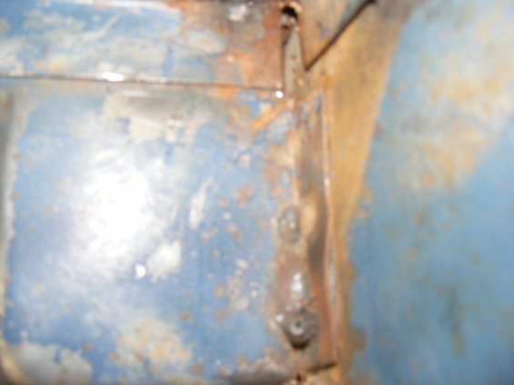

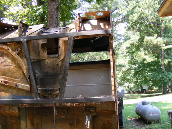

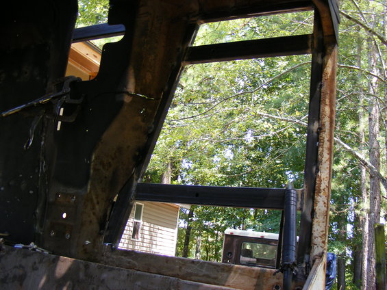

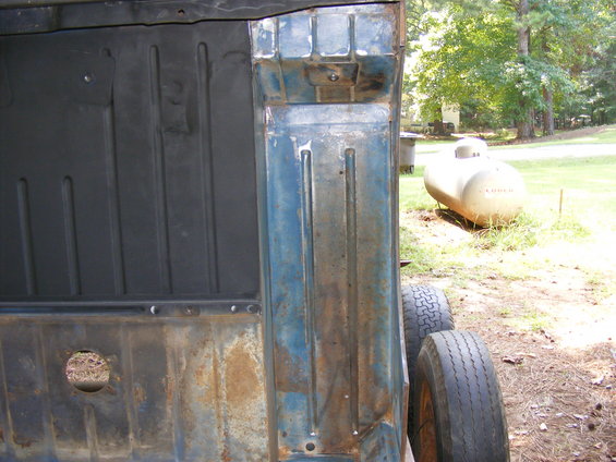

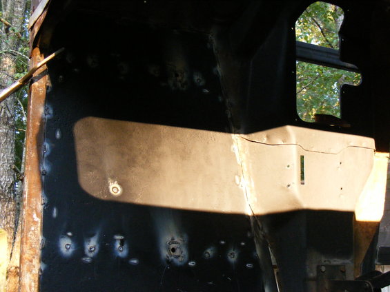

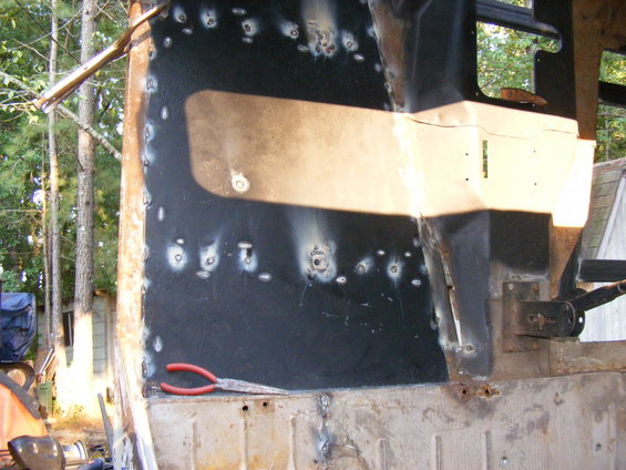

look at that gap in the factory fitment...come on jeep wassup with that..pulled a wad of body/seam sealer that was as big as a whole pack of chewed bubble gum
after some wire brush/cup work...
to be continued...

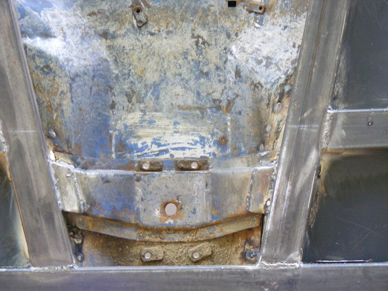

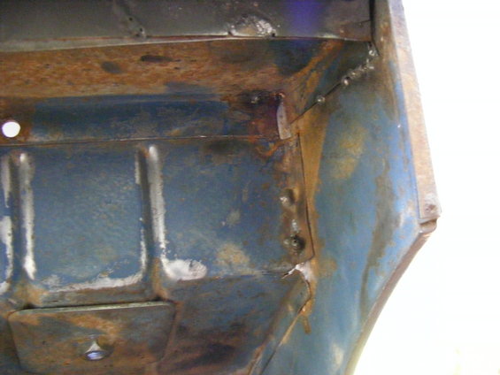

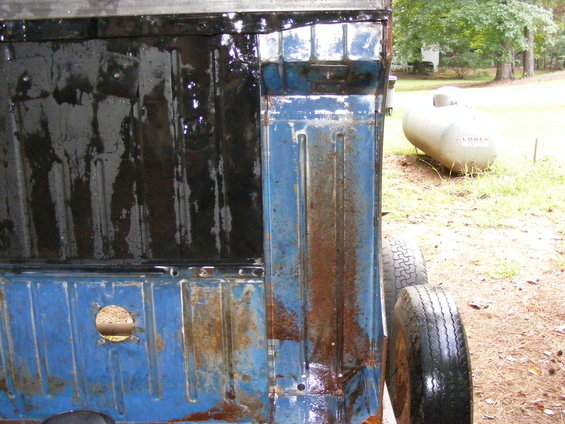

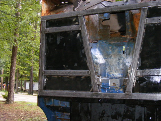

the continuation...after some washing
in reality i need to cut this out and weld in a new piece..maybe later...lol

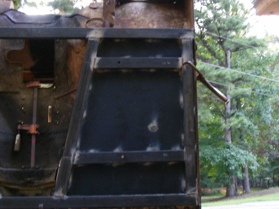

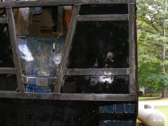

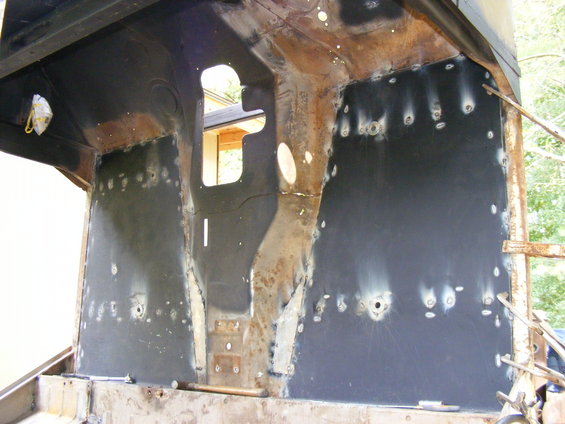

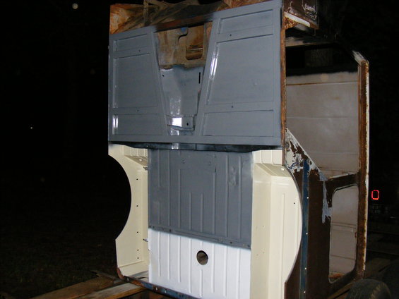

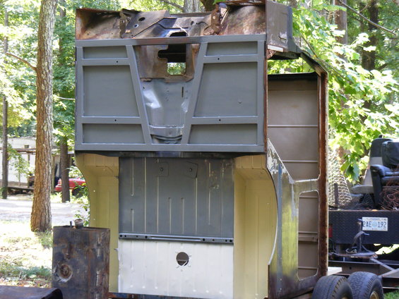

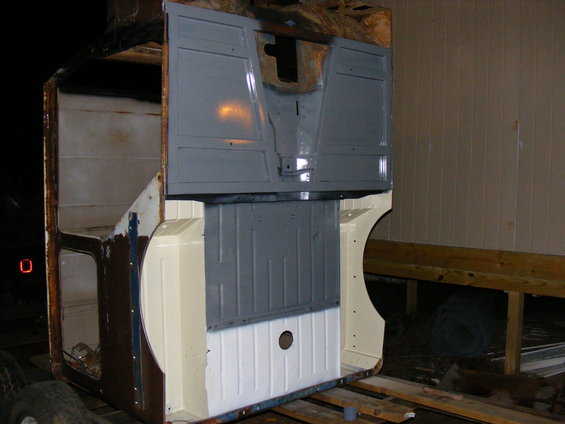

after some paintin....
well thats it for today...haha just to ease curiosity's the white and grey ares will be undercoated black so its just a sealer coat really but even so it will be all grey before then as this is only first coat...rain coming in tomorow...didnt want any o my hard work getting trashed...the light tan(Almond) color in the wheel wells is the color body is going to be...hope you enloyed...:cheers2:

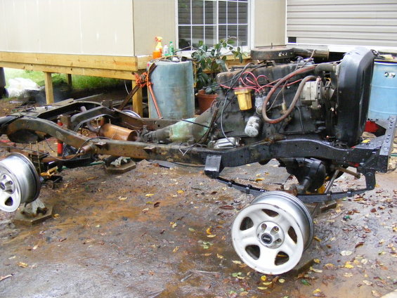

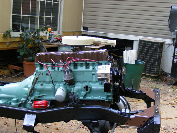

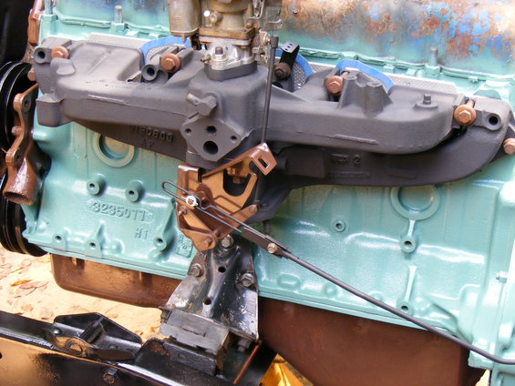

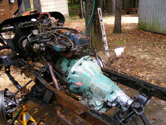

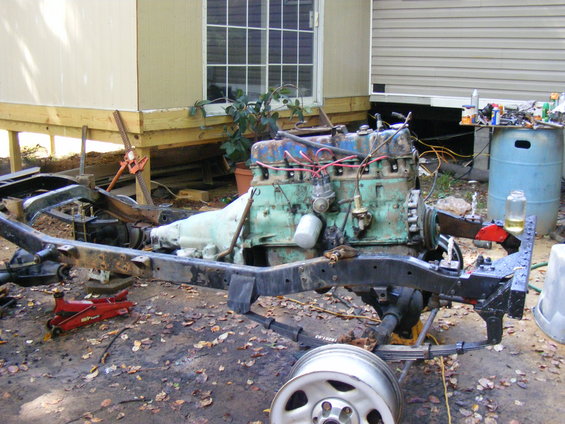

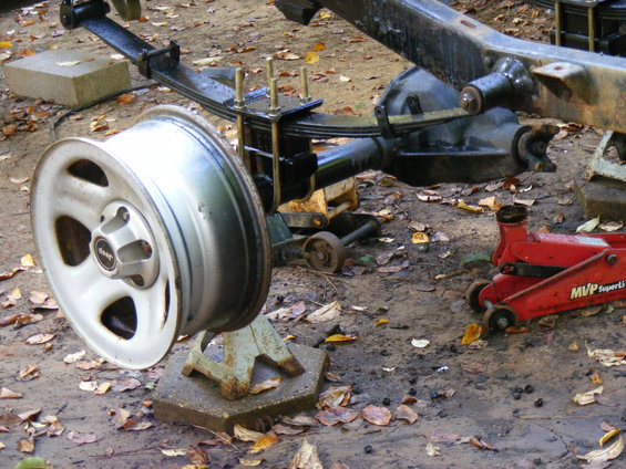

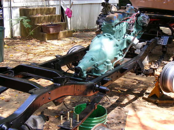

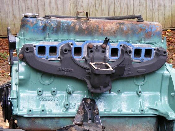

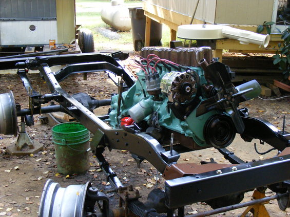

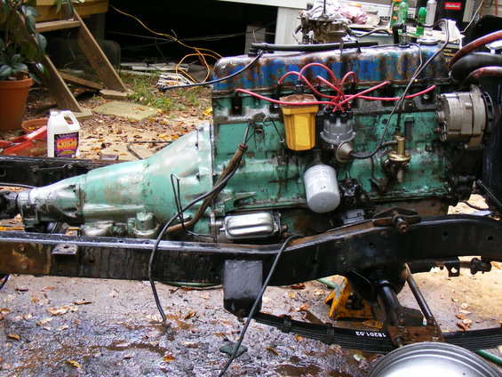

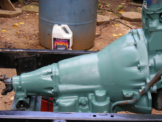

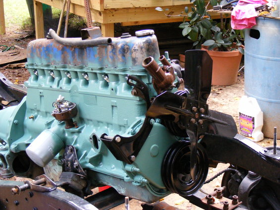

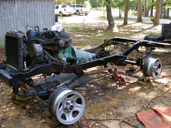

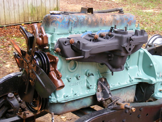

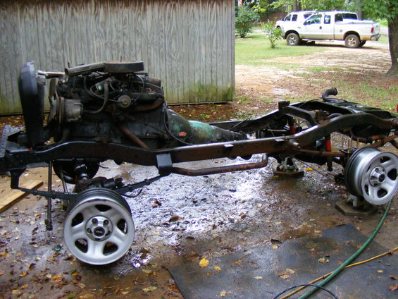

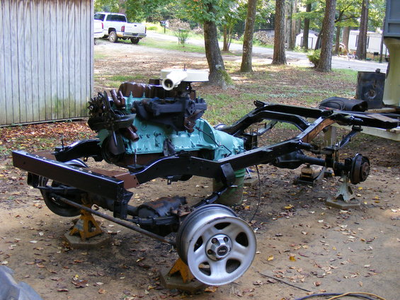

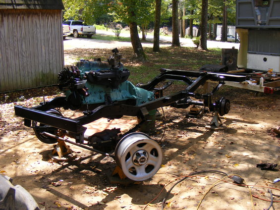

ok so a quick update....have been in scub-a-dub-dub mode....not sure how many more time i have to scrub before i get it clean enuff for paint...i may wait till i have the tires (one week from saturday) the drag the chassis to the car wash.....cleaning the frame was easy but the motor was so, so nasty.....so nasty in fact that i decided to strip it to the block to make it easier to clean plus that allowed for a fresh coat of black on the brackets and pulleys etc...also there was copious amounts of silicone oozing out of all the gaskets anyways....gonna give the motor and trans a fresh coat of mopar engine turquois blue...as it originally was...os so on to the pics sorry they arent anything exciting....
ended up with 1.5" blocks in the rear to level it out...

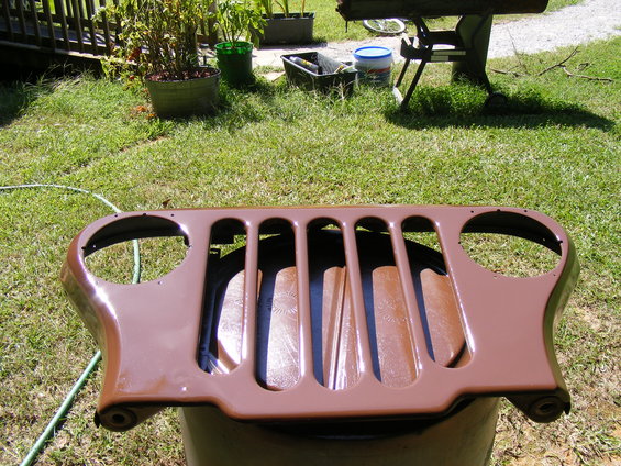

fresh coat of paint on grill....
and a shot of the underside during the day for a better idea of what the body color will be(wheel well color).....
once all the brackets and what not dry will take more pics as usual the threat of rain halted my progress but it was like 7:30 pm anyway so oh well....
so thats it...lol

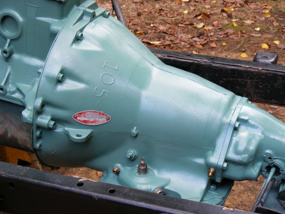

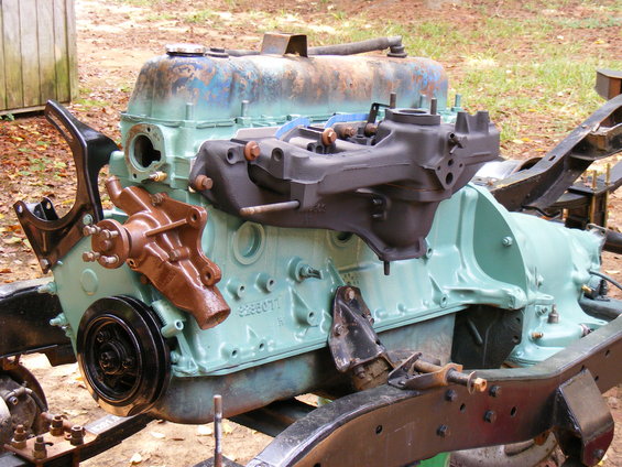

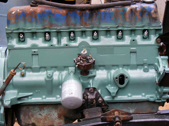

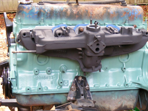

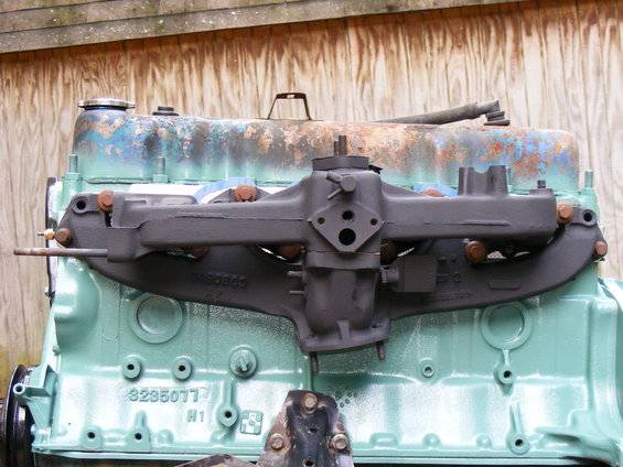

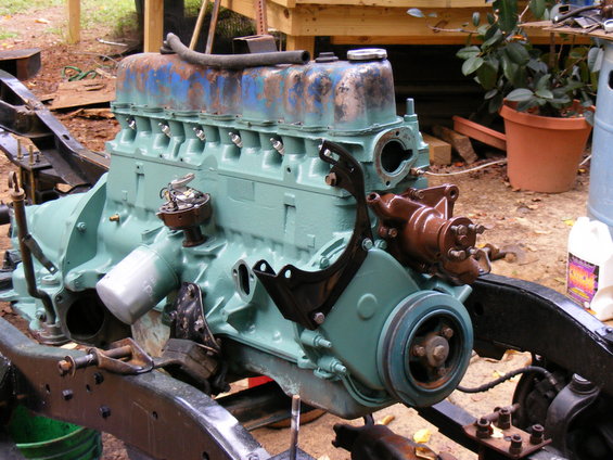

ok a little explanation right fast...the motor and trans in this jeep are in excellent condition save needin valve guide seals...the trans is actually a tf727 easily convertible to 4wd with 2 parts the according to "Advance adaptors" I should be able to bolt up a 231 t-case directly but that will require stretching the frame on this build(will splain later)...on to pics

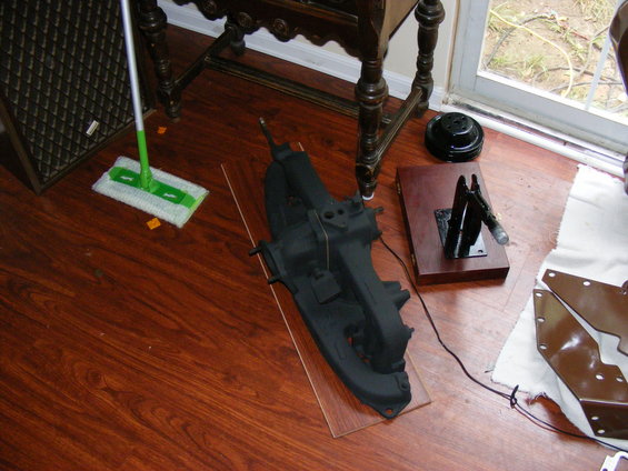

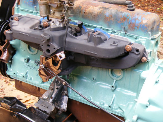

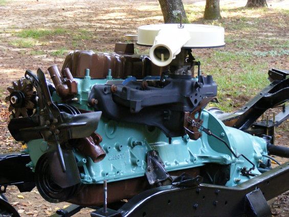

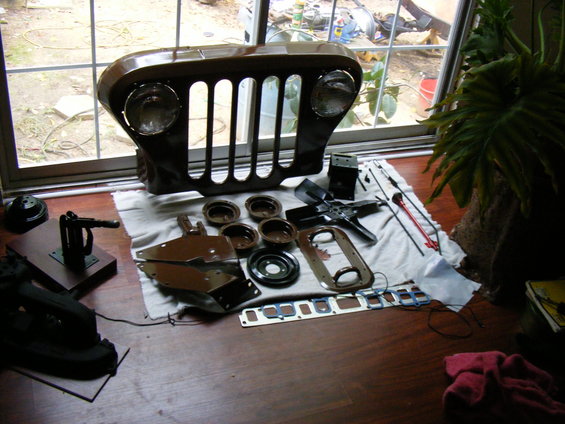

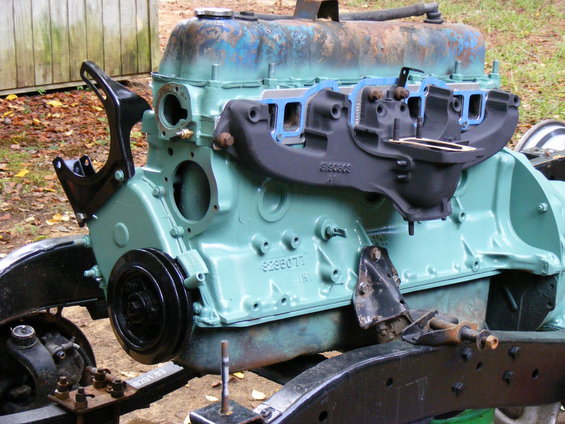

ok just a few quick pics nothin fancy..ignore the unpainted vc and op...gonna do the op when i get the jeep running and up to the hoistin tree...and the vc this weekend...didnt want the motor opened up for that long...ok so on to the pics....
parts..lol
reassembly....
well thats it for now...more to come...tomorrow givin it doesnt rain gonna finish up the rear shocks and final wash on the frame just to remove the degreaser film then final coat of black on frame.....motor mount brackets and op will be painted and new mounts once it drivable...also gonna drop of the radiator at thr radiator shop and see if its worth salvaging...if not a new one is in order.....

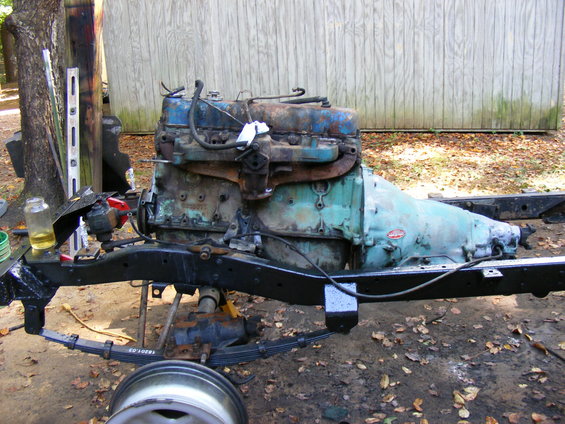

ok so first we will just post a quick comparison pic......
before....yuk!!!!!
after...ahhh!!!!!

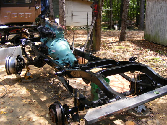

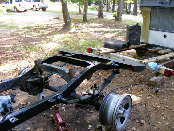

ok so now just a bunch of pics and an occasional narrative.....

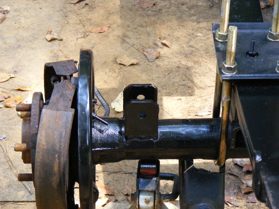

shock mounts...lol...

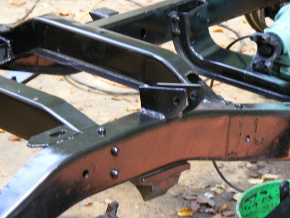

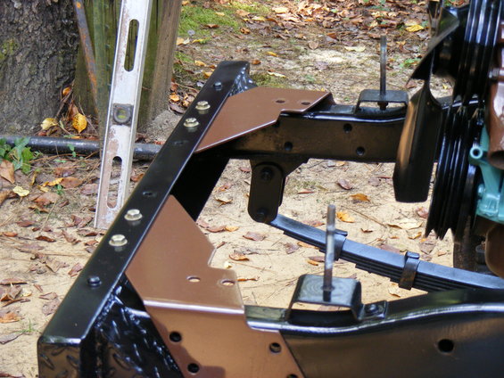

frame painted...all but crosmembers and rear bumper....

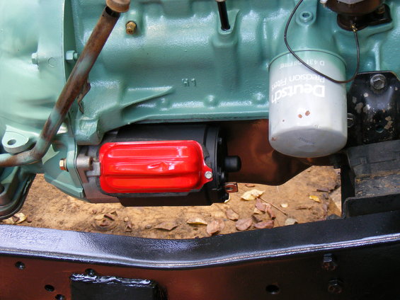

one of those tasteful red accents i mentioned earlier on...lol
didnt like the brackets black so i browned em...lol
linkage stuff...

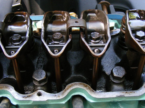

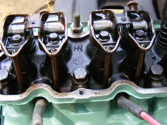

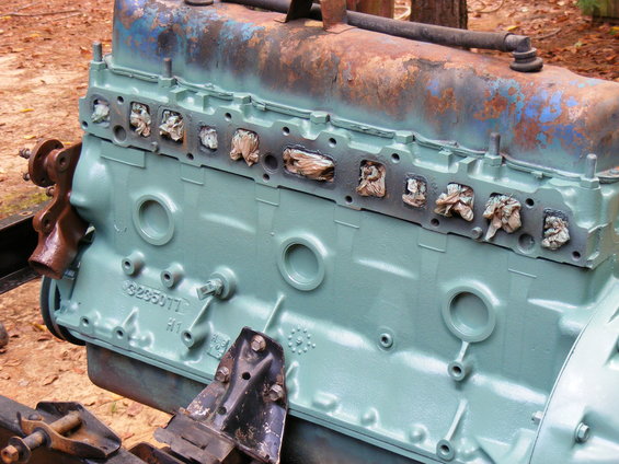

was amazed how clean the oil and inside of this little motor are...no sludge or grime and oil is clean and amber colored not black...i did however find what appeared to be pieces of broken black plastic...which turned out to be the valve stem seals(super easy fix) i think i even have a set that will work...yeeha score for me...lol....

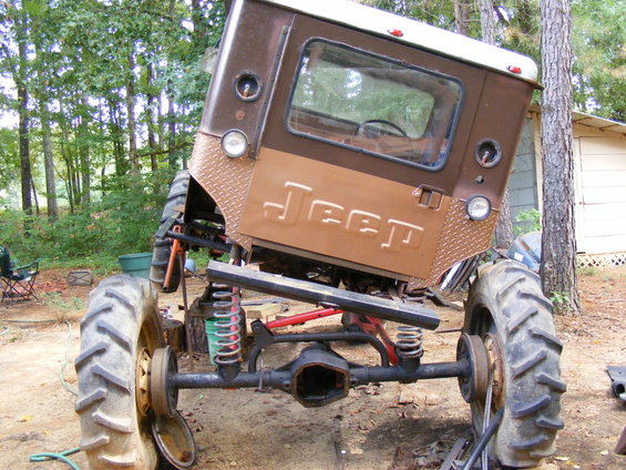

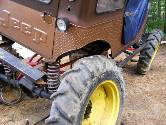

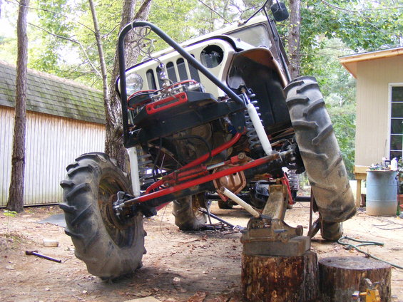

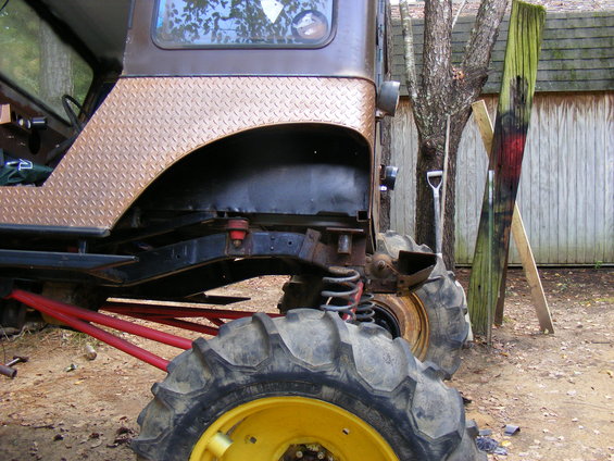

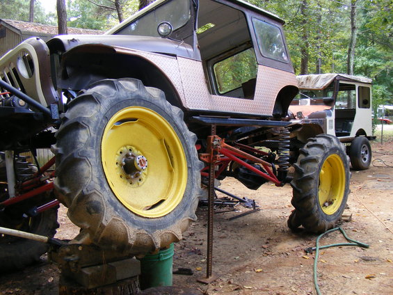

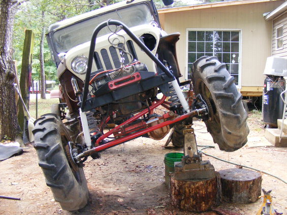

so I took a minute to play with the big DJ today just getting an idea...have purchased all new gears carrier and install kit for front axle the rear is still awaiting parts but am trying to move forwards...and yes I know I need spring retainers...lol

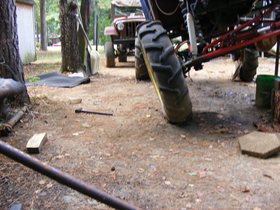

so I took a risk and took it as high as I thought was safe considering jank way of jacking....so here ae the pics...I still think that the springs are way too stiff as they don't seem to drop out like I would have them but then I don't know if my arms are flexing either but the pics in prior post would suggest they are...hmmm...ok so on to the newest pics...
the high lift is just for a height reference and has no weight on it
ok I guess that's enuff input to keep yall busy at least for today...lol sorry for the large bombardment of pics and overall lack of commentary but just trying to get you guys up to speed...needless to say neither dj has moved under its own power at this point....
