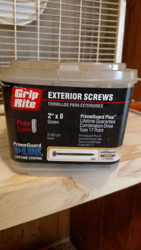

pretty sure the are ones Lowes has. Throw away the bit they come with and get a #2 square will break the screw before it strips
