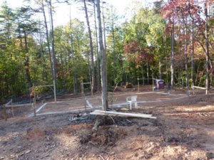

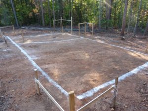

Once that was done, I got the Saw service inspection and got power turned on. Then we went about marking off the site, measuring the fall, putting up batterboards, marking foundation lines, etc.
10/19/09 I finally broke ground. Heres a few pics. Of course I wouldn't know what to do without the supervisor.

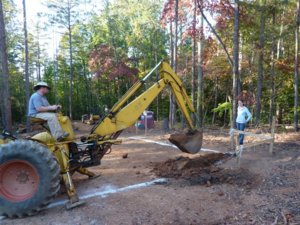

Got all of the backhoe work finished up today. It is really tricky trying to dig a 24ft span with a 30ft piece of old iron. Now the hard part starts, getting everything squared up and cleaned out. There is about 3ft of fall from front to back, so I am having to step the foundation, which will be a lot of shovel work in virgin clay. If anyone wants to dig, come on by. Im hoping to get it all done before it rains so I can get it inspected and signed off. Didn't have the camera with me today, so no new pics. Hopefully Ill get some tomorrow of the cleaned up and finished footings.
Its amazing how big the piles of dirt are just from digging the footings, and its also amazing how little ground the piles cover when you spread them out.

Got the footings finished up today. I swear I moved 10k pounds of dirt with a shovel. I had to dig out for 6 piers, each hole was roughly 36x36x18", but the middle was already busted up by the backhoe. Also had to bust up and then dig out 3 spots where the backhoe couldn't reach. Makes you wonder how they used to build things in the olden days.
I've got a few pics downloaded, now uploading to webshots, then I'll offload them here.
Tomorrow will be putting up the concrete dams and grade stakes. Hopefully monday will be inspection and tuesday pouring.
