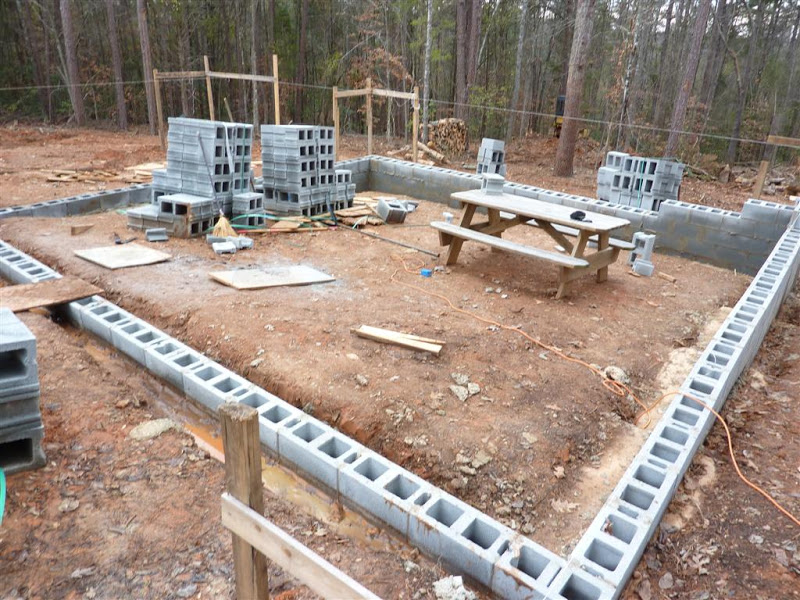

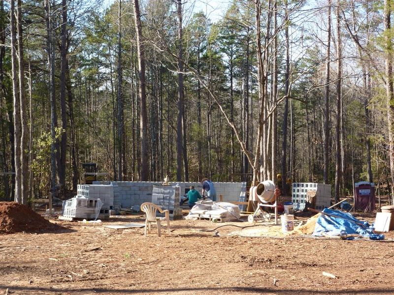

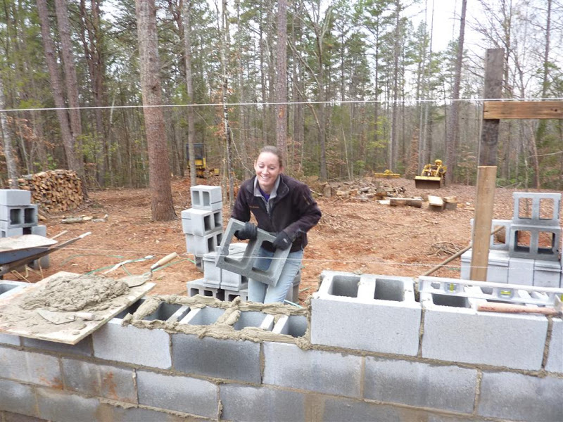

Here I am laying the first block, November 27, 2009! I had never laid block before, so I made sure to use plenty of mortar. It was still fairly warm, and I thought I could get it done before Christmas...
alh3.googleusercontent.com__3_A1_mChipo_Tfgz0_EPkfI_AAAAAAAABec75c6782fdb3d46d348b8f9e0cb4d7f0.jpg
Good help, but these are probably a little heavy for her. I found out later that they actually make lightweight blocks. The lightweight ones are ONLY 38lbs, while the normal ones are 56lbs. That makes a huge difference when you have to put down 200 of em and you have to lift half of them above chest height and set gently in place.

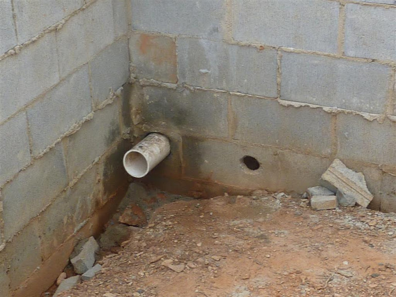

The lovely wife made these nice holes to run the well and septic through, with a framing hammer. She did an amazing job. There were two casualties here though.
#1 we didn’t have any safety glasses, and we decided here eyes were worth more than the Oakleys she was wearing, so the Oakleys ended up knicked, chipped and scratched.
#2 The foundation got filled a day ahead of schedule and I didn’t have the opportunity to run the elbows and uprights. It ended up being a waste of time and sunglasses.

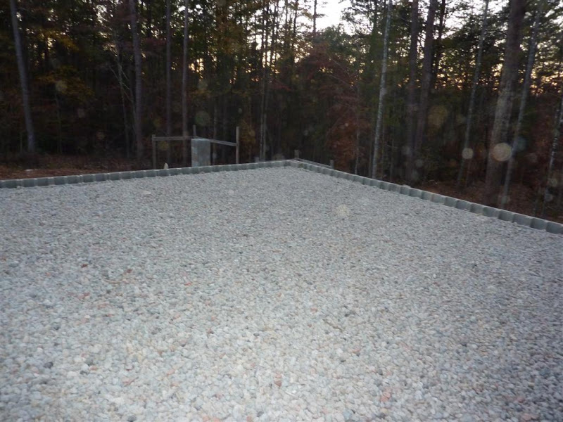

In the end, I ended up with about $2500 in block, mortar, sand, concrete, rebar, and wire. I overbought on a few things, and I have a lot of block, rebar, and wire left. If anyone needs any 8" block or 5/8" rebar, let me know!
After bouts of indecision by Gaston County, I ended up getting an engineer’s stamp on the foundation, and filling it with crushed concrete. Its painful to bury $3000 UNDER your slab, but I was just ready to move along. All of the walls had a lot of rebar and wire in them, and they were then filled solid with concrete.
The concrete was done by D&M Concrete, and they did a fantastic job! Also, their price was very fair. Including engineering, gravel, filling, under slab stuff, concrete, and finishing, it was about $4600. The only downside is that they worked too fast and I didn’t get my plumbing chaises ran. That was my fault, not theirs.

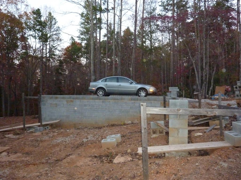

alh3.googleusercontent.com__kNYLT7nko7c_TfgzZaphMXI_AAAAAAAABd182ce7bb2fd102978dfae6c35c8ea22e.jpg

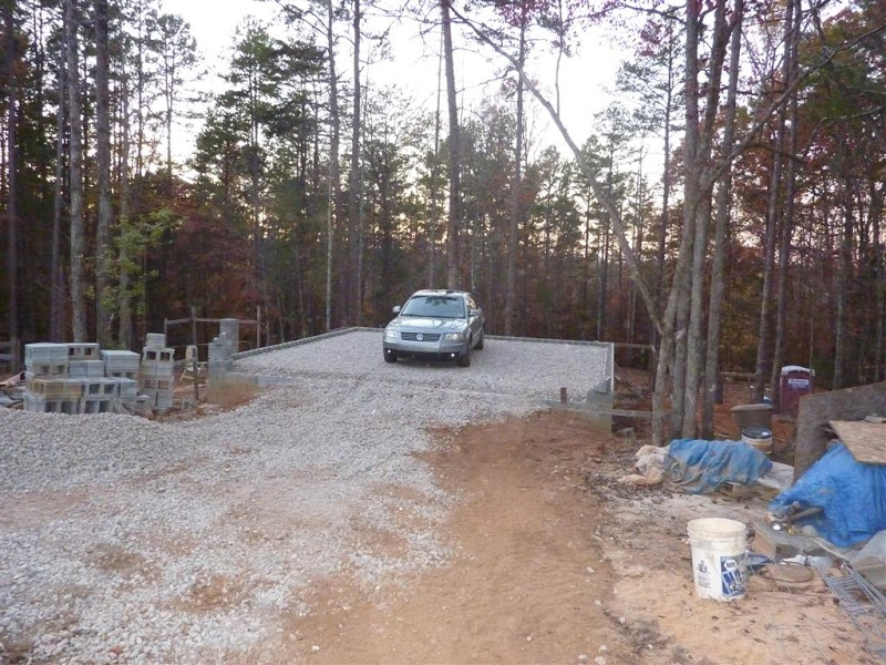

Heres a little load testing. First time I was able to park a car in the garage, haha.

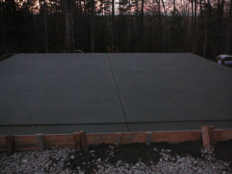

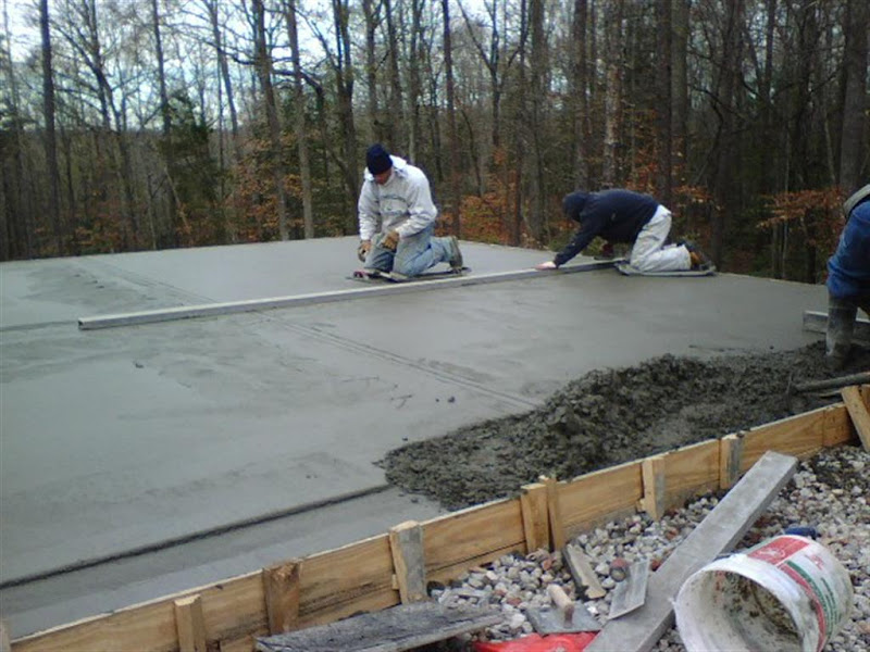

For some reason this is the only action shot I have of them laying concrete. It was cold and rainy and I guess the lovely wife didn’t want to take any pictures.
alh5.googleusercontent.com__6ie1zQqv6Cg_TfgzZAYkvnI_AAAAAAAABd019db7c4281a4453aaafd293006365d6.jpg

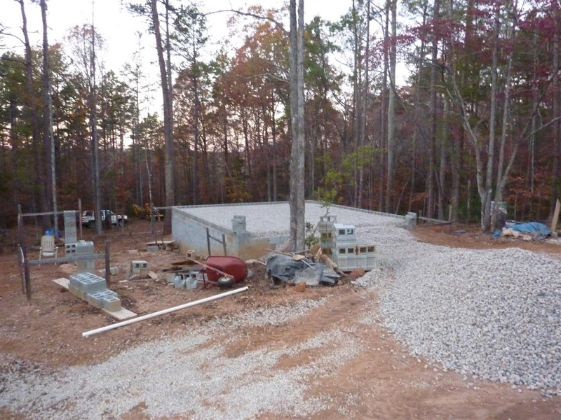

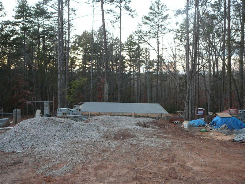

Here’s the finished slab.
alh6.googleusercontent.com__UcNNNvSOv4s_Tfl6TZJbfSI_AAAAAAAABme1f37ffd2e8227dd64d179c9be0ac581.jpg
It’s a little difficult to tell from these pictures, but the workmanship was top notch.

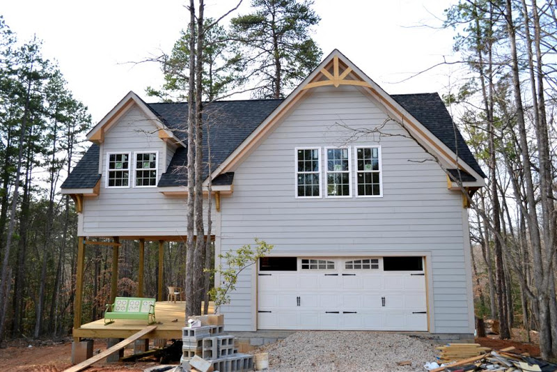

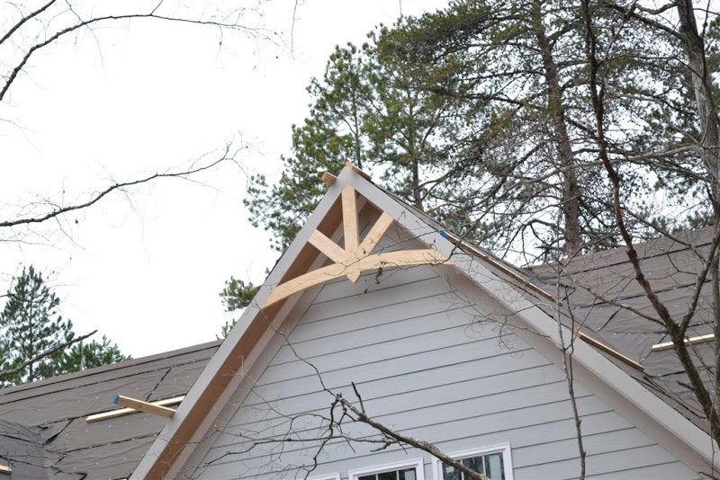

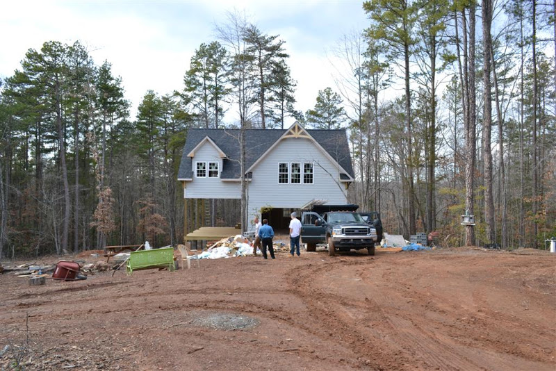

I guess its been long enough, I should update this thread. We moved in December 2011. Here's a bunch of pics from 2011.

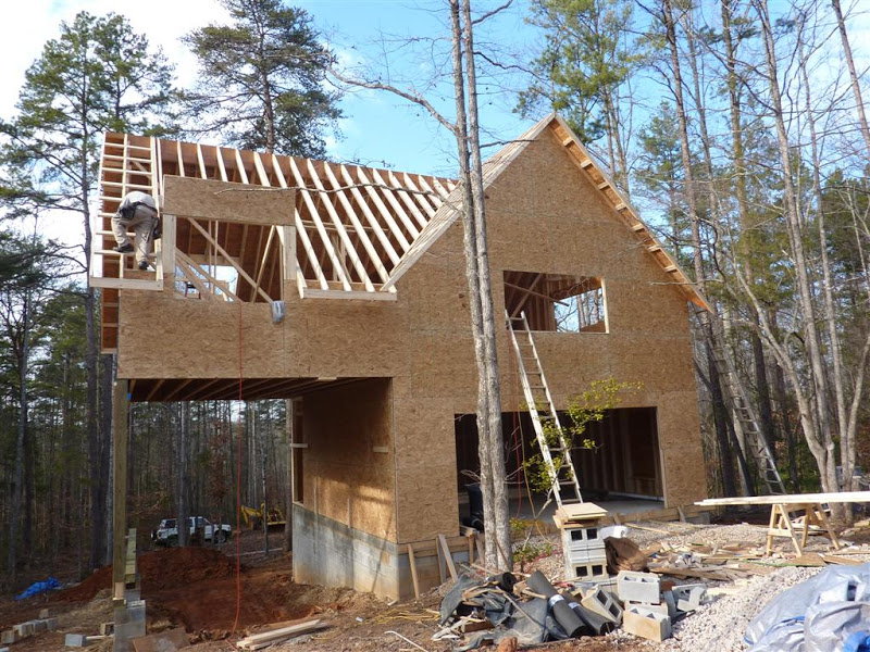

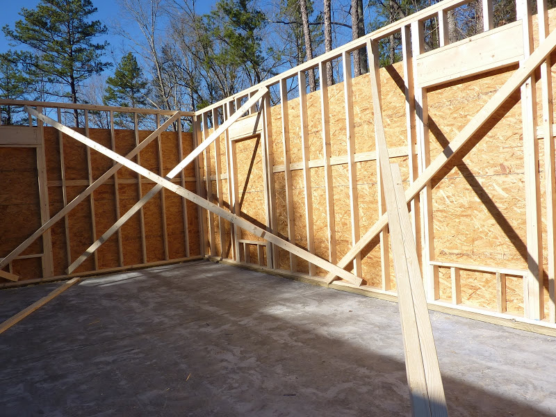

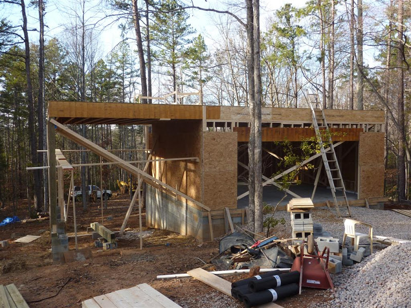

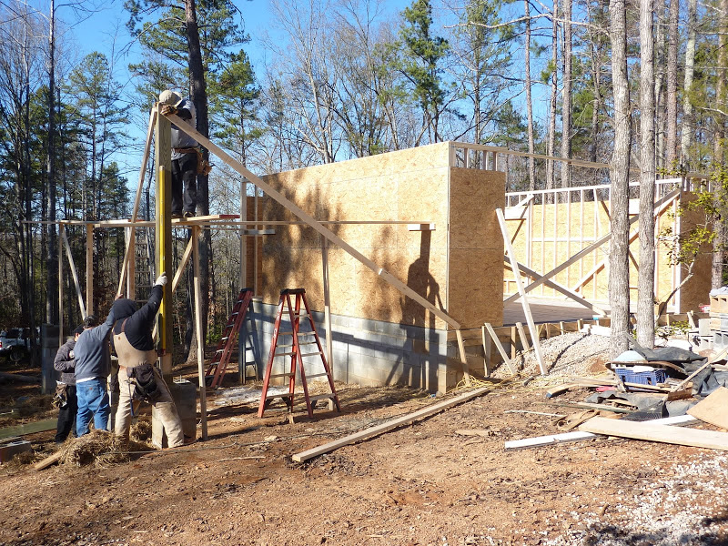

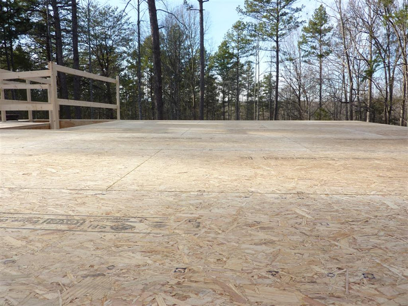

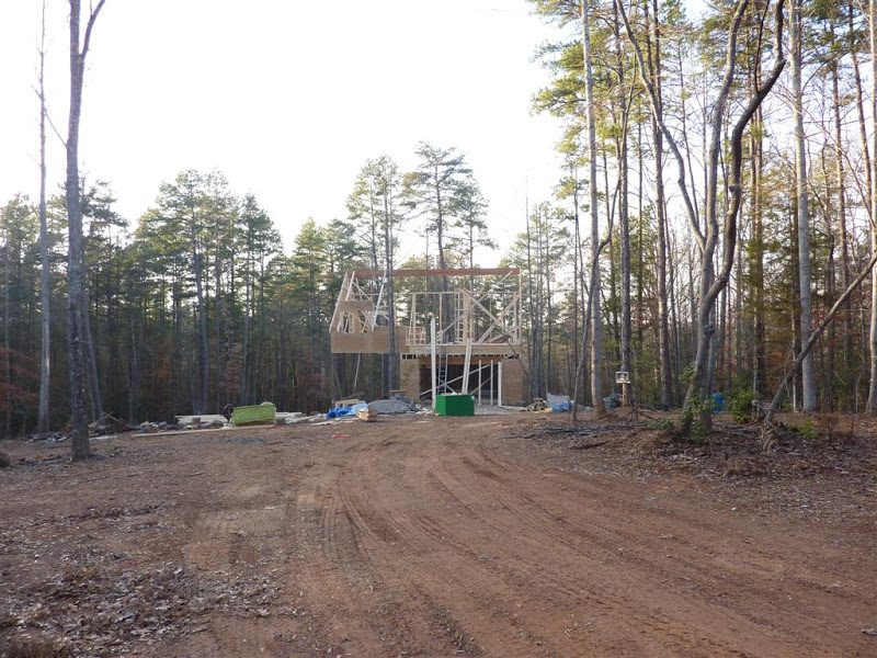

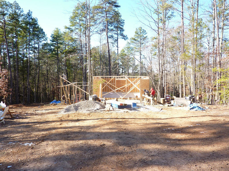

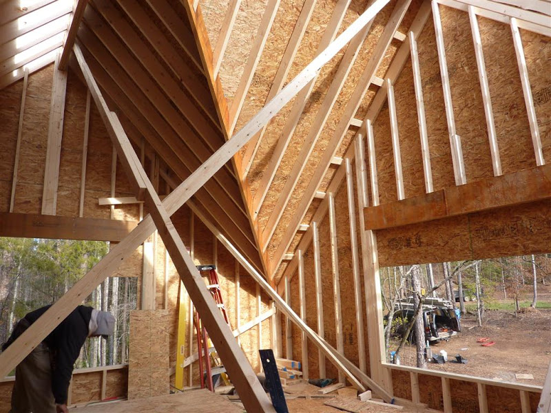

First day of framing:
alh6.googleusercontent.com__mQpaJU6S1t0_TQg49fDUWSI_AAAAAAAABWs_qqVB4VfzRQ0_s800_P1060766.JPG
alh5.googleusercontent.com__zfx77vugQ6Q_TQg5IU_TmlI_AAAAAAAABXM_Tm6ozjFacAw_s800_P1060774.JPG
alh4.googleusercontent.com__ELJ8QPpGCPU_TQg5UnDdoWI_AAAAAAAABX4_RgGcO9_zwck_s800_P1060784.JPG

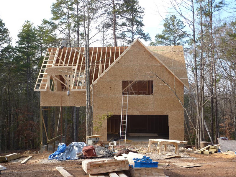

alh6.googleusercontent.com__I8up_Pq_STY_Tfg0InezHtI_AAAAAAAABgfed3ead4c2c1774eaf611f676d3e6163.jpg
alh5.googleusercontent.com__o7_BbeQt_GU_Tfg0Fca_UGI_AAAAAAAABfe4dcc151c177004c1b2055ec17938e06.jpg

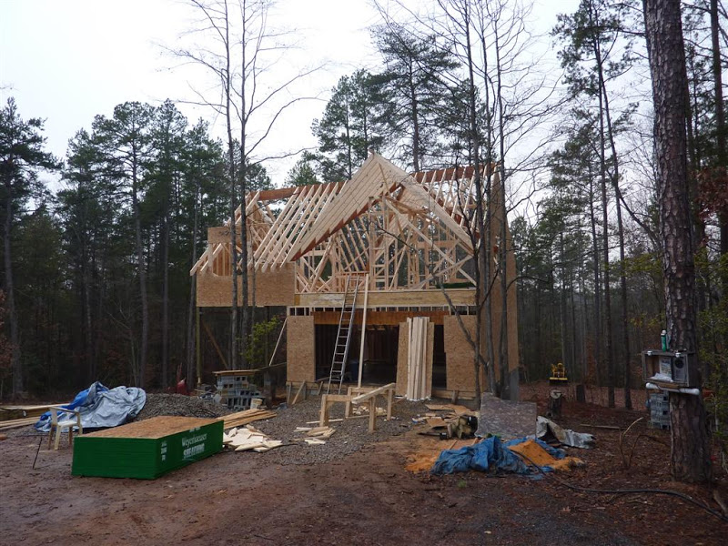

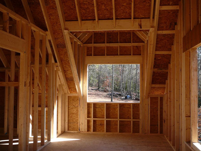

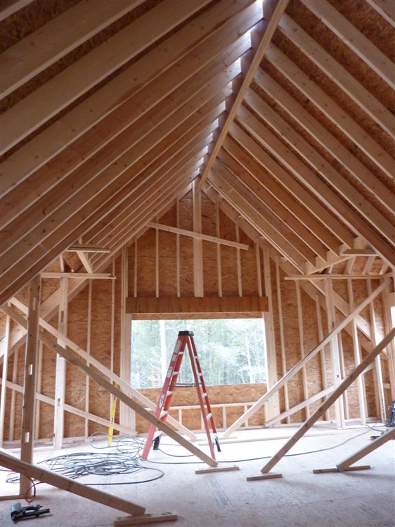

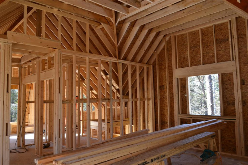

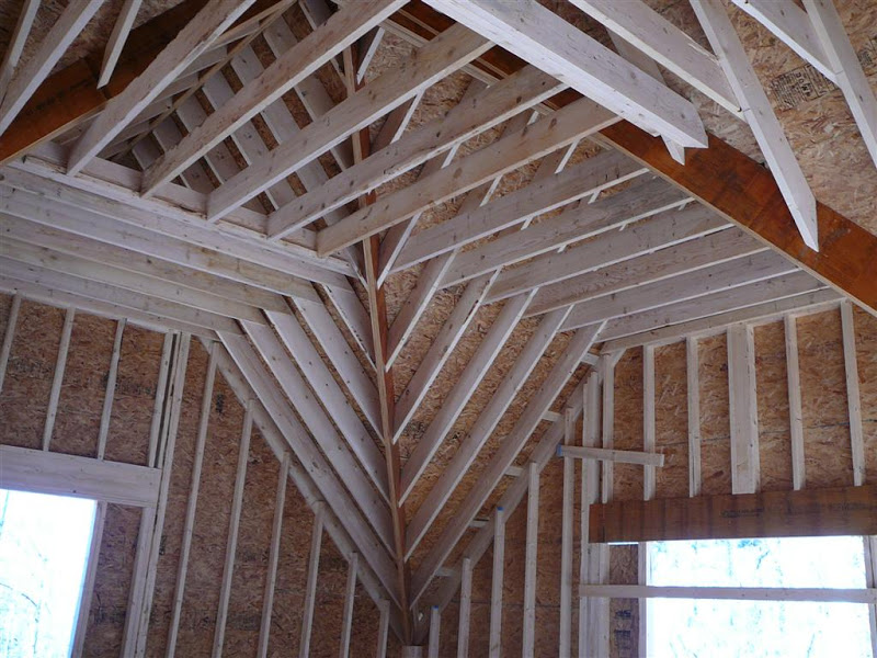

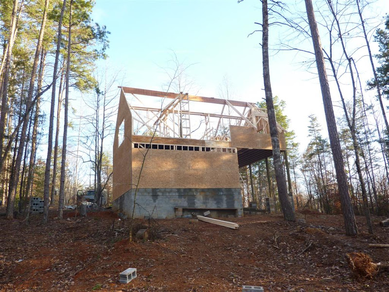

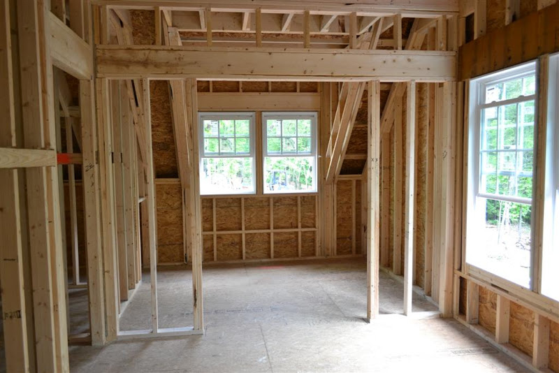

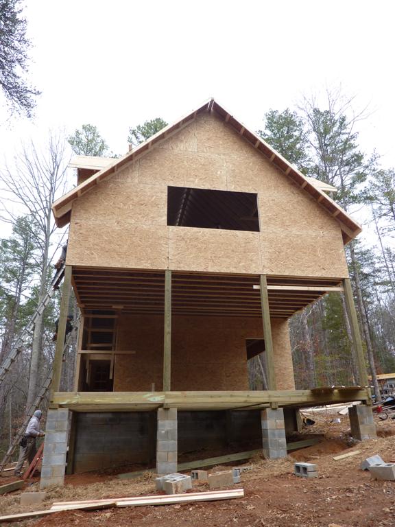

Starting to take shape:

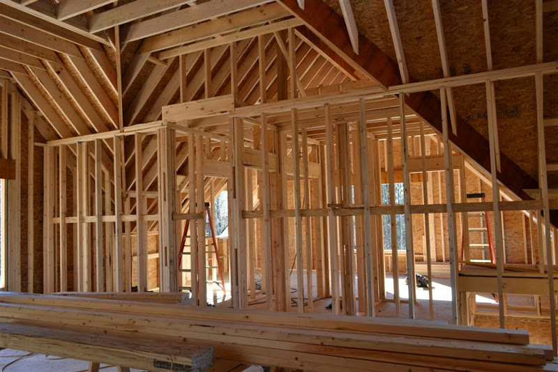

alh4.googleusercontent.com__Flol7cgfZ2Y_Tfg0BMWnNFI_AAAAAAAABffd507b984148950d9d1d048b87144c26.jpg
alh6.googleusercontent.com__pz3daTsoxuM_Tfg0AvDPsII_AAAAAAAABe9b9f115f41c5bc1592a935df14be232a.jpg
alh5.googleusercontent.com__3yd2qcaLVQw_Tfg0BHK0E0I_AAAAAAAABf50d50956f2e625ecf2eb50003ce7f50d.jpg
alh5.googleusercontent.com__ZI7LHKw9Ats_Tfg0BrDKAwI_AAAAAAAABf7f5a372961bbbc09ab563213d81c7b78.jpg
alh4.googleusercontent.com__vdU4L_fhJww_Tfg0CSwSdaI_AAAAAAAABf5723ee148689ebc2422fcd15d6b048fe.jpg

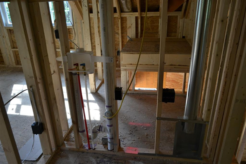

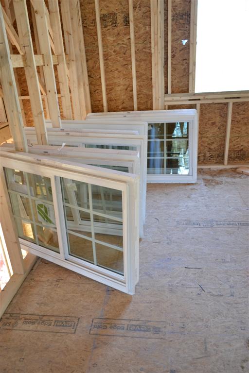

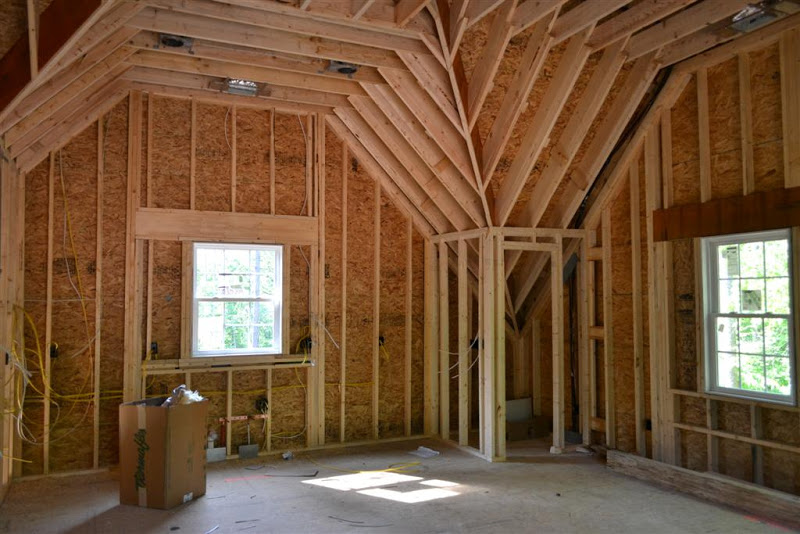

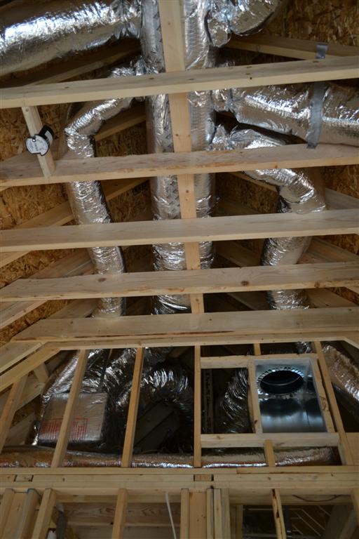

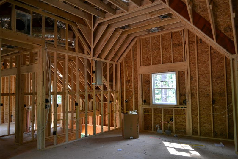

Didn't get many pictures of the electrical/HVAC/plumbing, but heres a few.
alh6.googleusercontent.com__L7Bjg5eQ9Z4_Tfg0k_pqkeI_AAAAAAAABla2195284fc734bb13056a994f16a0248.jpg
alh6.googleusercontent.com__giBgXs8MfD4_Tfg0k6MabiI_AAAAAAAABld90fe5609338b9ccbeacf600dcb74521.jpg
alh6.googleusercontent.com__9971sCtd7eM_Tfg0mZKMupI_AAAAAAAABl5be09450fe9a9dea63d0b770d9ff9d08.jpg
I was foolish enough to think I would actually have some attic space until a giant silver octopus showed up and invaded everything. It seems a bit overkill for less than 900sqft in my opinion. Maybe I'll optimize it one day.

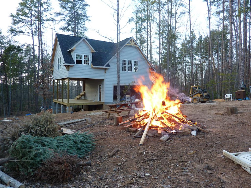

FIRE!!!

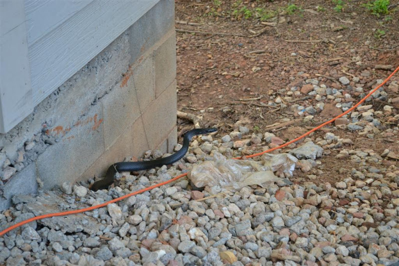

And there are always visitors. This guy tried to go in the garage:

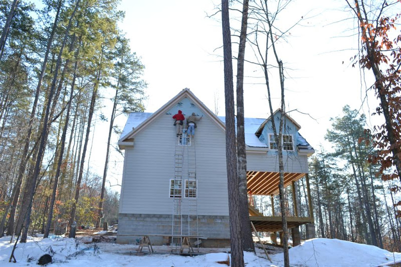

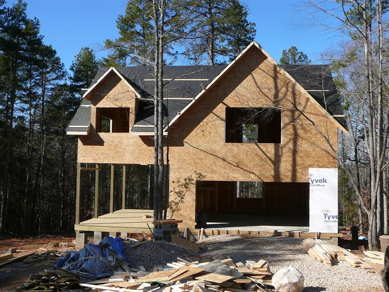

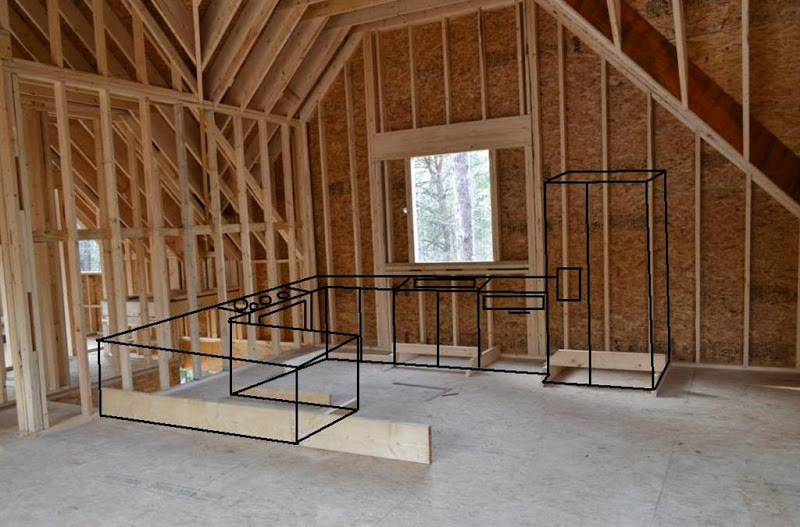

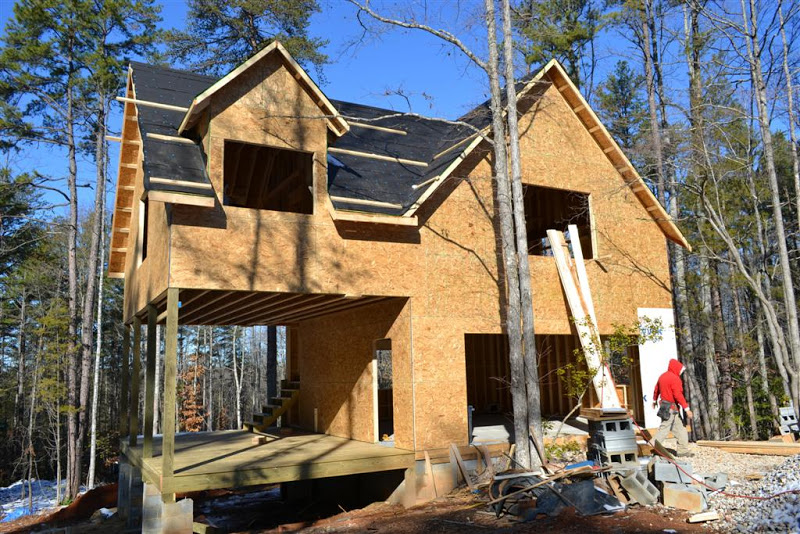

Once everything was dried in, I was able to settle down a little and start thinking through the kitchen layout. Autocad drawings are nice, but theres nothing like putting a couple boards in the space and then walking around it. Add a little bit of Manucad, and now you've got something.
alh3.googleusercontent.com__V_6CLRwOa7c_Tfg0gtT896I_AAAAAAAABkdab3fb13dd9afc1792b76da59b2f1e5d.jpg

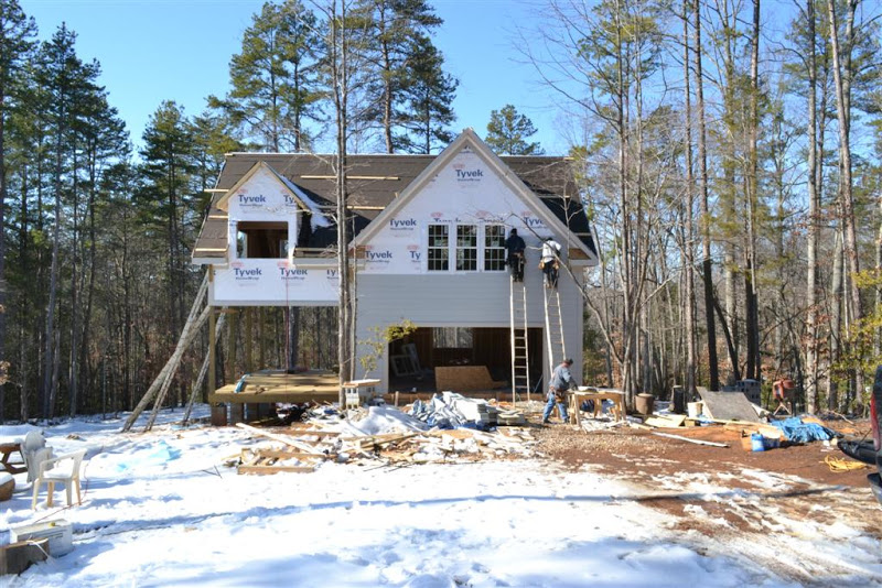

Oh, did I mention all of the framing and drying in took place in the winter?
alh4.googleusercontent.com__H7xm38Ei_80_Tfg0hnK5DAI_AAAAAAAABk8ba6feef3c20e3a4f4ed4e06bd6d8e8f.jpg
