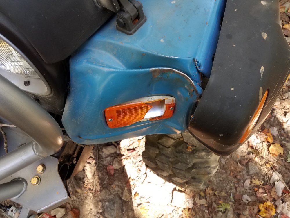

Your fender looked fine to me. Just replace the lens and run it.

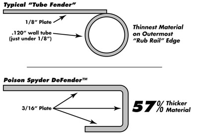

I try not to hit them often, but I have now crunched both on trees at Big Creek. I am looking at the Poison Spyder defender series, so it is not tube, but 3/16" plate all around

This is a very biased attempt at comparison:

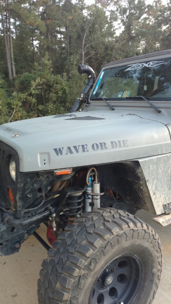

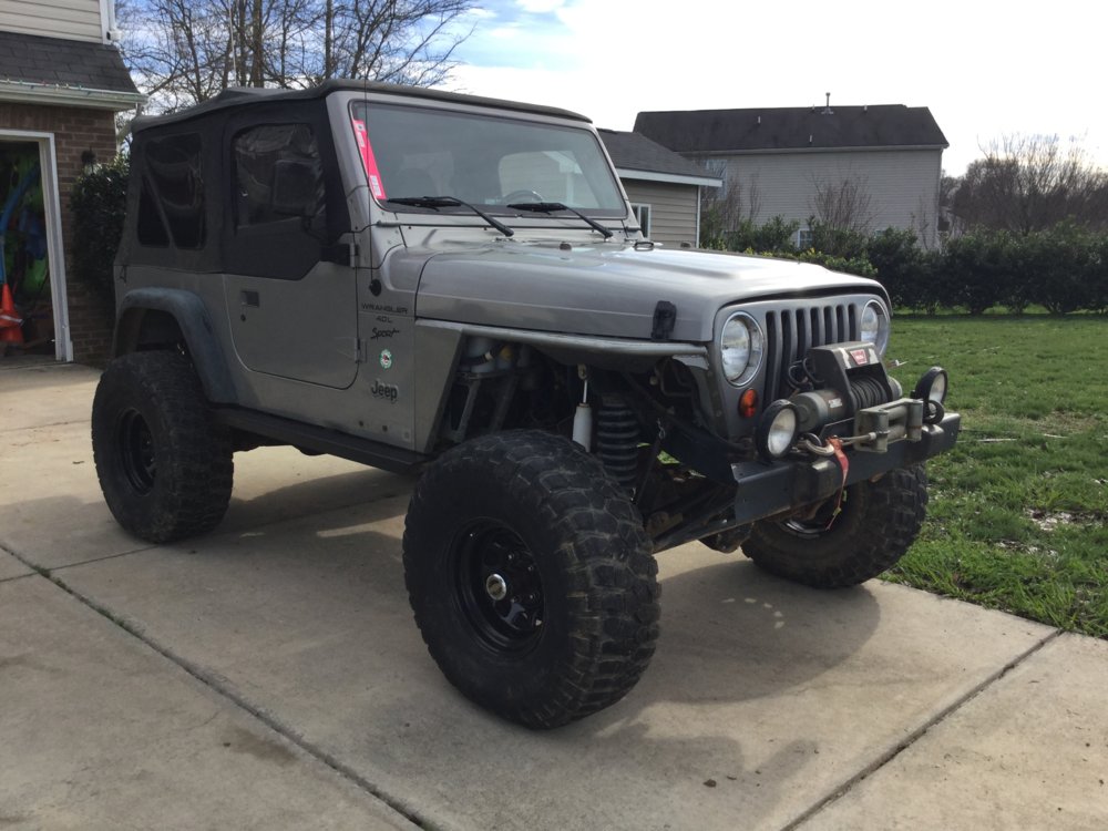

The tube is thinner, but is structurally totally different than a formed steel plate. I'm too lazy to figure it up (and it would be too involved with too many variables), but I would guess the tube on the outside would be only slightly more prone to denting, and overall less prone to major bending and deforming because its a full tube instead of effectively being c-channel. But both should serve just fine and be way stronger than factory sheetmetal. Personally, I don't like the lines of the off the shelf stuff. Its either too square (big 90 degree corner) or too contoured and doesnt give enough tire coverage. Heres the lines I used when I built some a few years ago:
alh5-googleusercontent-com__wdq7zt33iqa_tqi0adhaxli_aaaaaaaab79b54d57b64ac250390c300cf1dfda7fc-jpg.118765
More pics here:
TJ Hi-Line with Tube flares
I think something like that in bare aluminum would look great with a steel bolt on rub rail painted black or blue to match your jeep. Maybe MarsFab or somebody could build em up for ya.
<shrug>
I have one that looked worse than that when I bought the Jeep.
Run it.

I had the same question when I was brainstorming mine.
After completing a DFMEA, outlining the desired MTBF, and fully vetting the load cases, I remembered that saying something is made from aluminum gets you more imaginary internet respect from dudes you don't know... So I went with that.
