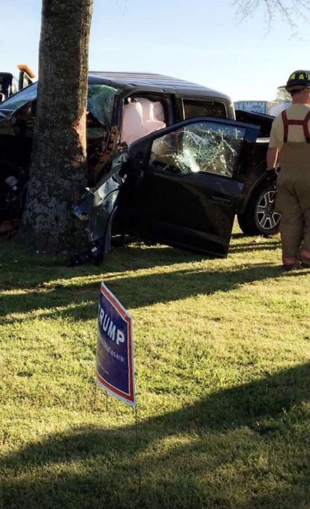

I was the 2nd person at a wreck about a month ago. A new F150 nailed a tree head on (drunk). The rocker completely separated from the floor pan by about 8" in the driver side floorboard. I like the idea of aluminum bodies (no freakin rust), but its going to have to be thicker than what they are using. Would a 1/4" thick bed floor weigh that much more? Probably still less than a steel bed.

How was the driver?
Just because it separated, doesnt mean it failed...
90% of the people that buy an F150 will never do anything like that to the truck. I think they will be okay.

How was the driver?
He walked away after it took 3 of us to get him out (ATF caught fire when the tcase shattered ad drained on the crossover pipe). The dash pushed all the way to the seat.

Sounds like the truck in the wreck did what it was designed to do. It crushes and take the energy of the crash so it is not passed on to the occupants.
Yeah, but you would think they would want to maintain the integrity of the cab at least length wise. I bet if he had been going much faster, he would have been pinned in bad enough that it would have taken tools to cut him out. With the fire under the truck, he may have been SOL.
Being pinned and having to be cut out is better than the crumple zones not working and taking the more of the energy of the crash into your body.

Looking back at the pic, the truck did what it was supposed to do.
Yup. I read an article a while back about the offset frontal impact problem. Survivability basically came down to milliseconds of deceleration time. They said that anything over about 35mph was basically unsurvivable as a rule. If you made it out, it was simply luck. Fucking terrifying.
