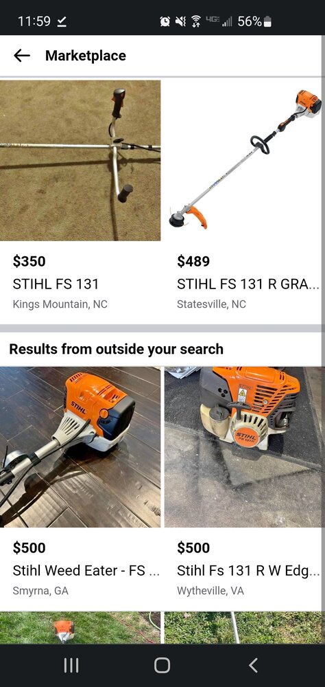

Simplest fix is to put it here:
And get one of these:
Just take it to Forsyth mower across from the shit plant on Griffith Rd. $60 and it'll run like a top
#paytheman
