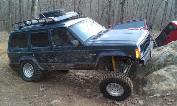

I would highly suggest going with a 3" lift at least if you want 35's. a 12.50 tire almost rubs the leaf springs on a stock rim and does rub in the rear on flex and the control arms when turning. You will break stock axles with 35's eventually too. So with 35's you are looking at cromo shafts front and rear a traction bar if you dont want to break things in the axles and driveshafts all the time. Again Just my .02

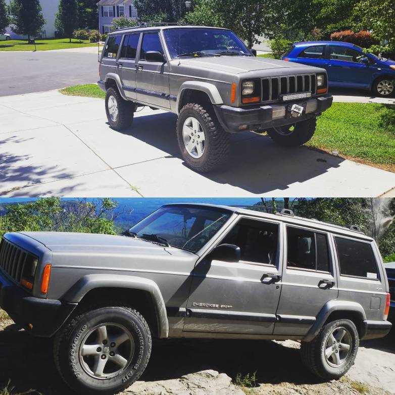

Thread is worthless with out pictures lol
First picture: top is 3.5inch lift with jk rubi tires and wheels with g2 wheel adapters. Fenders un touched. Bottom picture of the same jeep stock tires. 225s I think
Second picture: fenders cut and folded.
Third picture: driver front and passenger wheel stuffed.
Before i removed my fender flares and cut folded my fenders they would rub the flares extremly badely on the sightless uneven ground but they do not rub control arms or leafs.

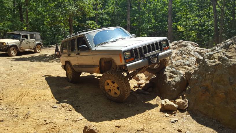

31x10.50 MTRs, 3 inch lift and it took a ton of cutting to clear them properly. You can see the front cut and there's no structure left in the rear inner fenders.
Bone stock worn out suspension and 31x10.50r15 on stock 15x7 wheels. Lots of cutting. I trimmed just above the highest fender lip for the flares. I had to move the rear inner fender up and weld it back to the quarter panel. Tires rub the control arms and a part of the unibody up front. Rears rub the inner fenders when stuffed on one side and drooped on the other. Spacers would fix the rubbing. Could probably fit a skinny 32 or 33 but it would be tight.
