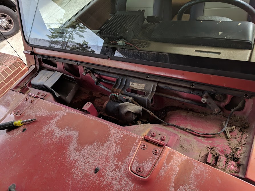

Secondly, there are six Phillips screws holding the cowl on. Two are accessed from under the hood. The remaining four are along the bottom edge of the windshield. Once they're all out, lift the front edge of the cowl and slide it off.
You should get something that looks like this:

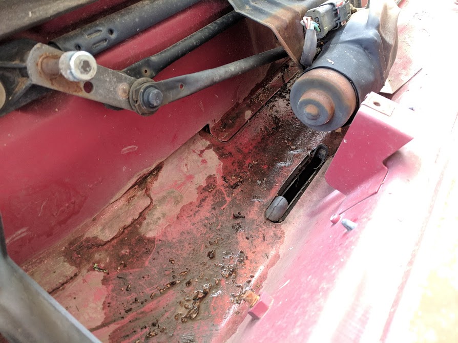

Step C, clean out all the junk that you can find under here.
In the center of the cowl, under the wiper motor, there's a single slot drain that drains water out of the cowl. Be sure to clean that one well.

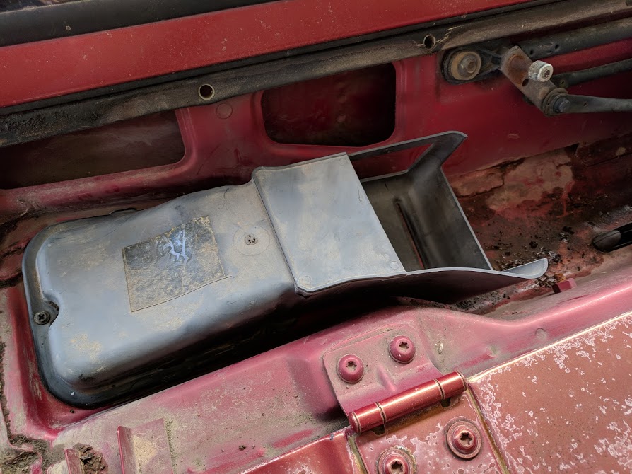

Step four: There's a plastic cover on the passenger side covering the air intake. Three screws hold it on. Remove all three, and pull it off.
Like so:

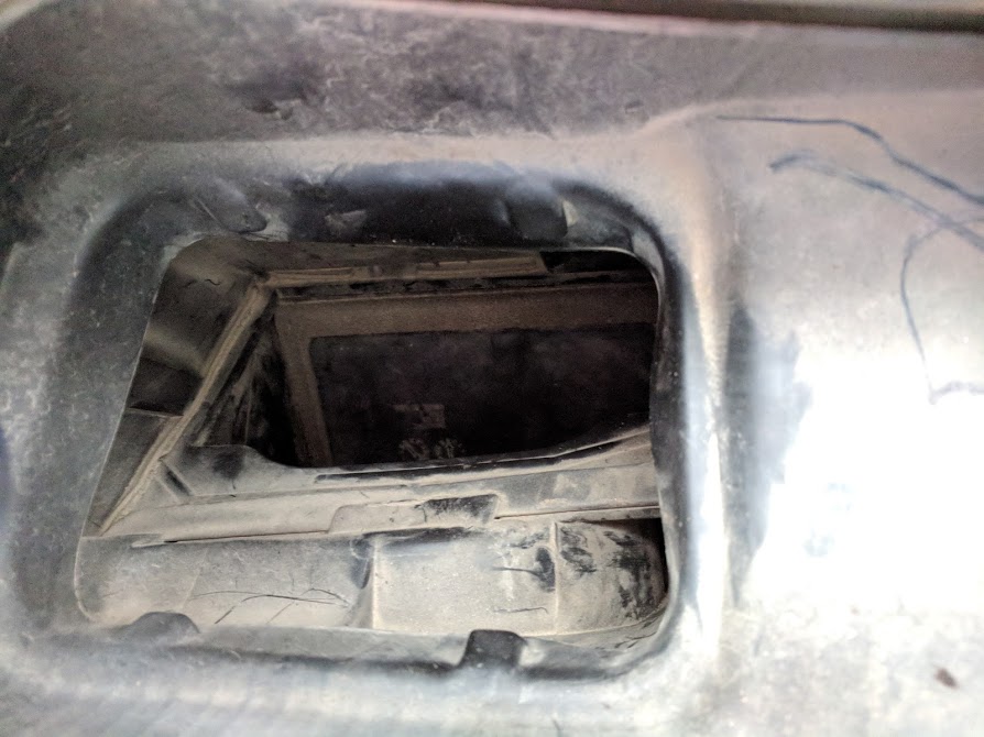

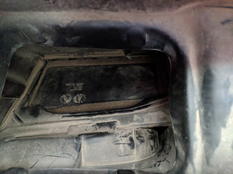

Fifth, if you have air conditioning, there will be a flap for recirculation mode between you and the fan. That door might be closed. If so, it'll look like this:
Turn the ignition "on", and turn the mode dial or slider to the defrost position. The door should open. If it doesn't, and your Jeep is made prior to 1999, the door is vacuum-operated and doesn't have enough vacuum to move. Starting the engine for a few seconds should generate enough vacuum to open the door.

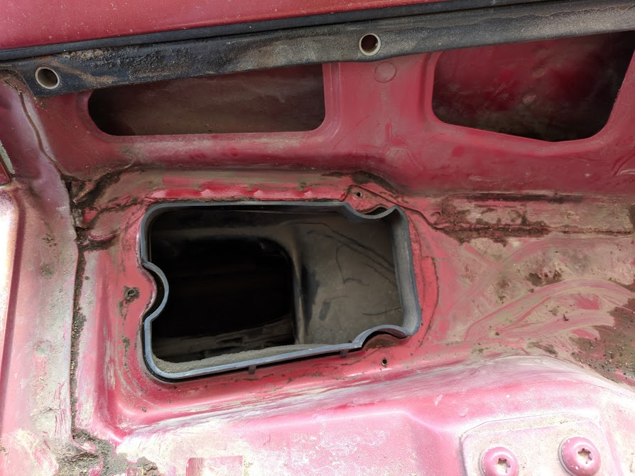

Then it'll look like this:
Step VI: Stick your hand in the hole and fish out anything you can grab. The squirrel cage will be at the bottom of the hole, around the corner toward the front of the vehicle (bottom of the photo). Remove any acorns, sticks, leaves, mouse nests, mice, squirrels, or other vermin that might be inside the fan.
