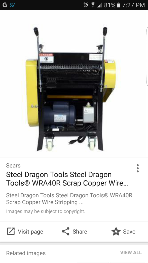

Anybody used something like this for stripping off the coating?
Handheld Copper Wire Stripper Tool using Stock Blade, Cable Stripping Machine for Scrap Copper Recycling - - Amazon.com

Good point w/ the vice. I'd guess that could work easily using the tool in the link above, clamp an end in and run that down it.

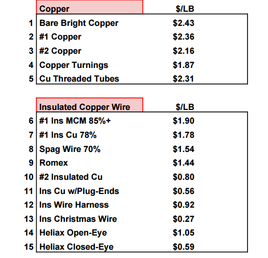

But there is a reason folks with bunches of wire and bunches of money dont hire cheap laborers to strip it. I sold a bunch of copper last week. About 500lbs worth. IIC insulated was bringing $1.65/lb and bare bright wire was bringing $1.88/lb.
So that sounds like $100 I left laying, but remember that insulation actually has weight. On smaller diameter it is a greater % of weight than larger and less worth the time. As it stood it would have taken me probably 4-5 hours to strip what I had(lots of odd sizes, drops and cuts, so it went insulated.

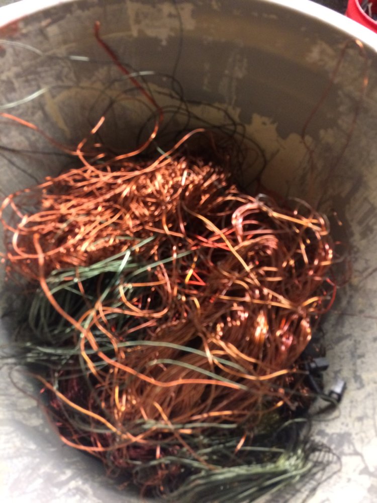

I use a long curved pic and needle nose pliers I've done smaller gauge too hardest part is getting the plastic insulated piece in front of each wire I have a 5 gallon bucket full of wire from washing machine, dryers whatever has copper lol
You must have gone to a feeder yard, that's quite a margin they have on your bare bright. Insulated has many grades due to yield percentage.
