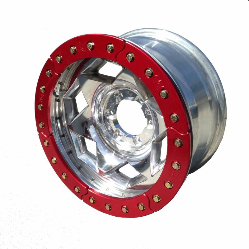

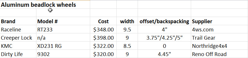

Bumping this back up. Any new opinions on beadlocks? I will be buying some this fall. I am looking seriously at these that @NCJeeplover posted. For $300, they seem like a great deal.
TR Hardrock - Series 025 - TRUE BEAD-LOCK (Single Wheel)
I was told by @91oneton that eagle alloy was not selling wheels by there own brand anymore and those beadlocks are no longer available. I do believe he mentioned KMC beadlocks for cheap though.....
