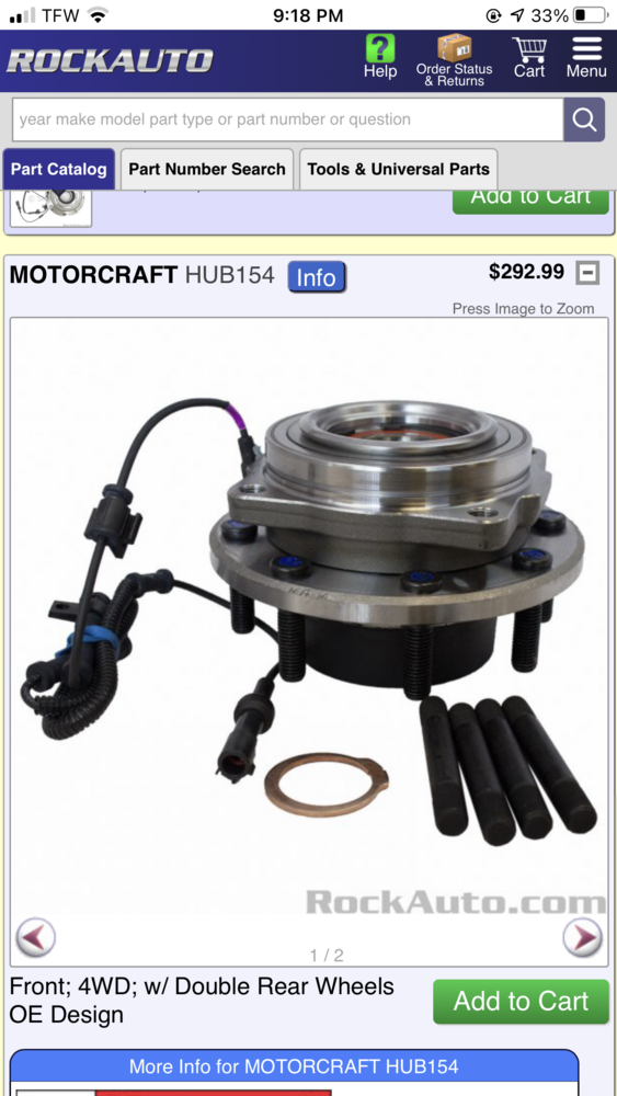

They're not that much, somebody got screwed if they paid that much for a SD unit bearing. New Motorcraft ones are $330 on RockAuto. For a trail rig I wouldn't hesitate to use Detriot Axle unit bearings which are ~$240 for a pair off Amazon.
Sure about that?

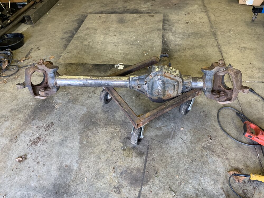

Look up Weaver Fab if you still want bolt on. I've used the mentioned shop once and it took them almost 3 months to machine a set of knuckles, even if they were still open no way in hell I'd use them again from that experience. Also who did you pay $150 to cut everything off? I'm really not looking forward to doing mine.
I was saying I would pay that if I had to do it again. I did it myself

Yep. There is an easier way. Notch a window into the cast sleeve to expose just enough tube to weld to. Takes 1/4 of the time and doesn't weaken it as bad.
You still need to remove the control arm mounts etc.
7" grinder/cutoff wheel is the way to go to clean these up.
That's a whole lot easier said than done. I've cleaned 4 of these in last 2yrs and the 4th one wasn't much quicker lol. I am curious how this new plasma cutter will do on cleaning up these 05+ since it can cut 3/4" no problem vs my old one it struggled on 3/8 bad haha
