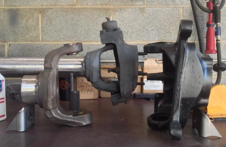

From what I read the Castings are bigger. anybody got a side by side picture? Are we talking ground clearence robber like the 14 bolt FF before a shave?

The only thing that robs any ground clearance is the low radius arm mount. Seems like most people cut these down and weld on new mounts or trusses anyway.
The wheel bearings are pretty awesome. Something like 4.5" diameter. They're beef. The ones I took out of my axle had 210,000 miles on them and were still alright. Unlike 99-04, these have a sealed roller bearing inside of them where the axle stub rides and not a little needle bearing. The snap ring on the stubs is no joke though...that's the hardest part of changing a wheel bearing. Are they serviceable? No...but you can pump grease in them through the ABS sensor hole and they even make an adapter that bolts in place of it and has a zerk so you could force water or dirt out if any did get in there.

IT was really late and I got lazy not going to lie. but just for you ill do some :)
Just for you.
fetch-photoid-5592-png.5602
