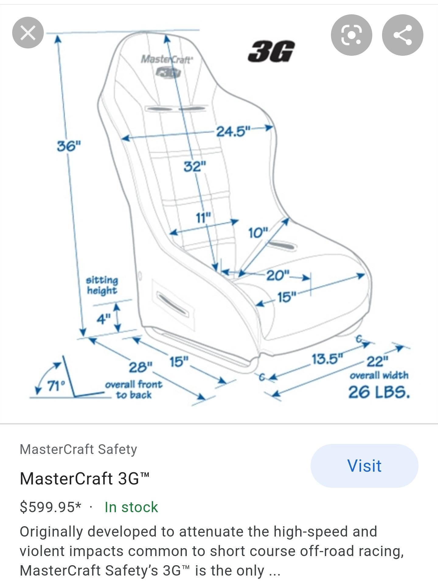

I ended up getting the mastercraft nomads. I decided on them for a few reasons. First was the price. 400 for the pair. Second the brackets seemed good and not terribly expensive compared to the corbue. Third the bolsters seem to be flaired out more which should fit me better. Worst case scenario they get pulled out and sold for something more compfy.
Aslo my driver seat is toast and Northridge had them physically in-stock.

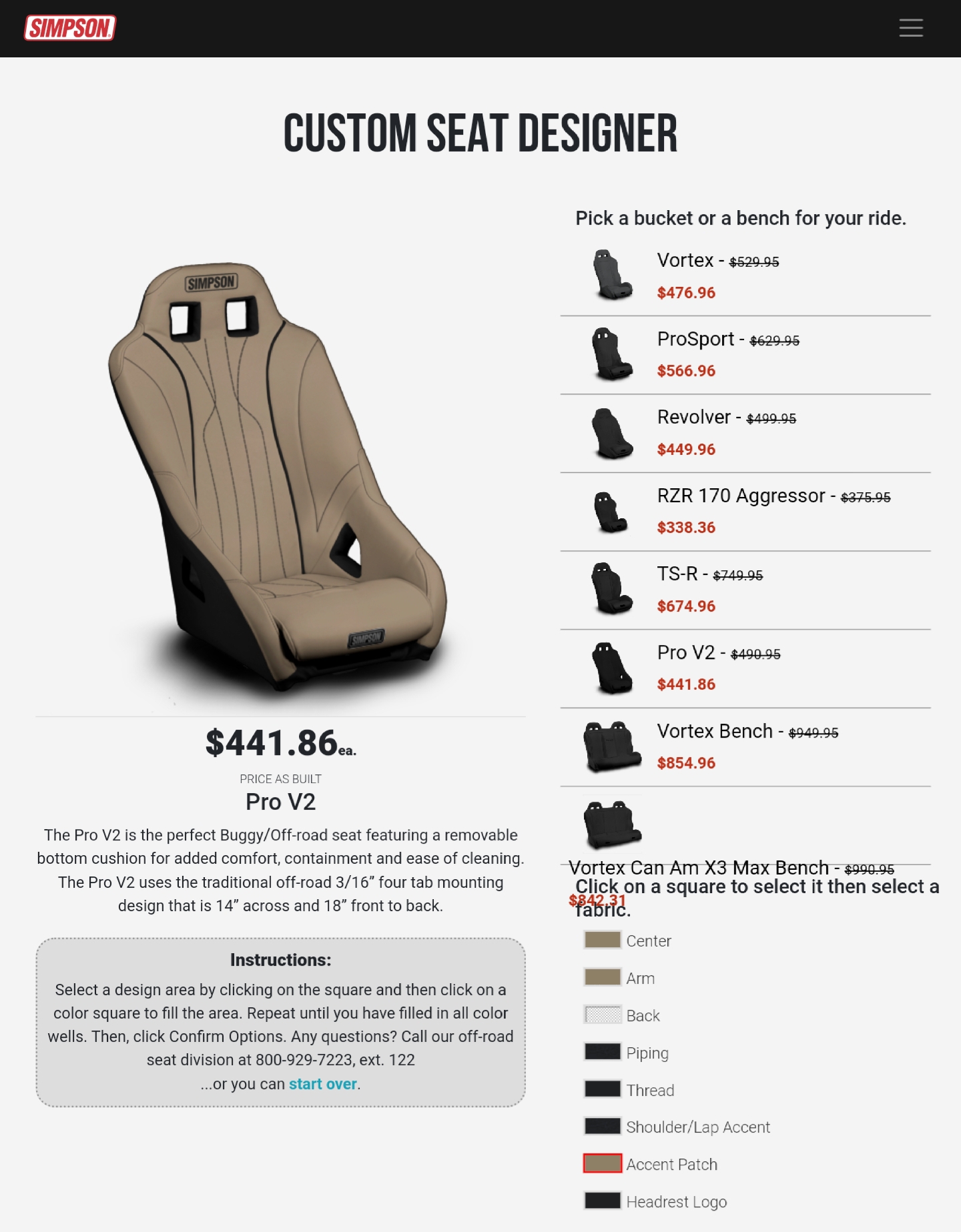

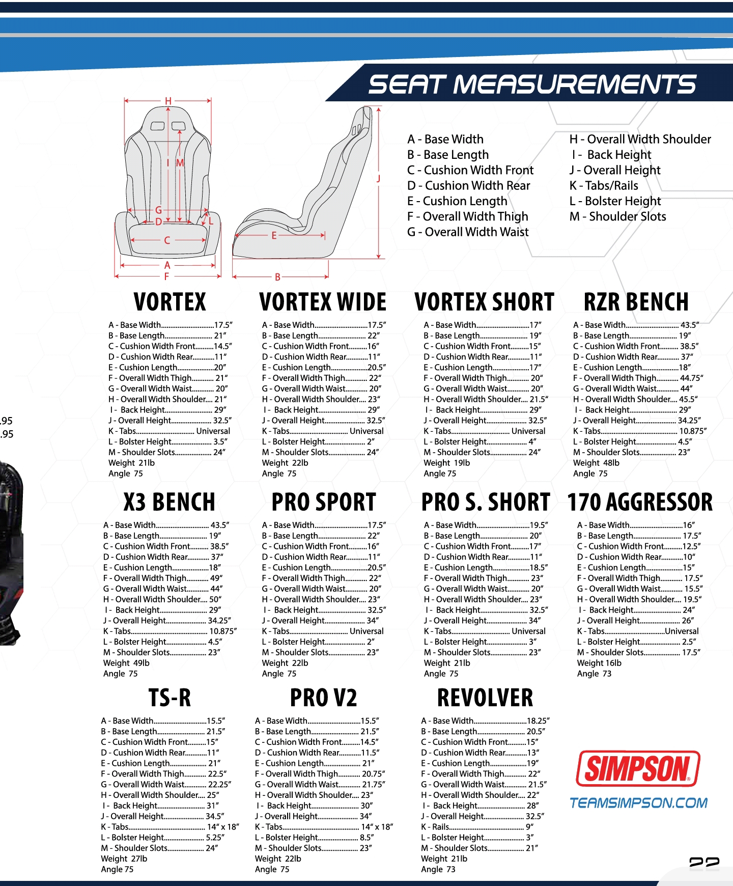

Simpson Vortex: They have a removeable bottom cushion that I pull out if I am washing with a couple of smallish holes to allow drainage. Roughly 25" from the seat cushion to the harness hole centers and 30.5" to the top of the seat.
After telling them that measurements could not be found anywhere he sent me an email right away and said they'd get it corrected on the site. For future reference I'll put that info here including a screenshot of those dimensions.
Simpson custom seats in CA
310-325-6035
Simpson Performance
Edit: They have a dry foam option at no extra $$ if you ask for it. Said the density is the same but it drains moisture away more easily & less susceptible to breakdown. Their seat heaters are dual pad and if the seat has a removable cushion like this one then it'll come with a WP connector to the back pad. I asked about certain colors & they're emailing me pics that include those. Said let us know whatever I like and they'll send me out some color swatches for free.

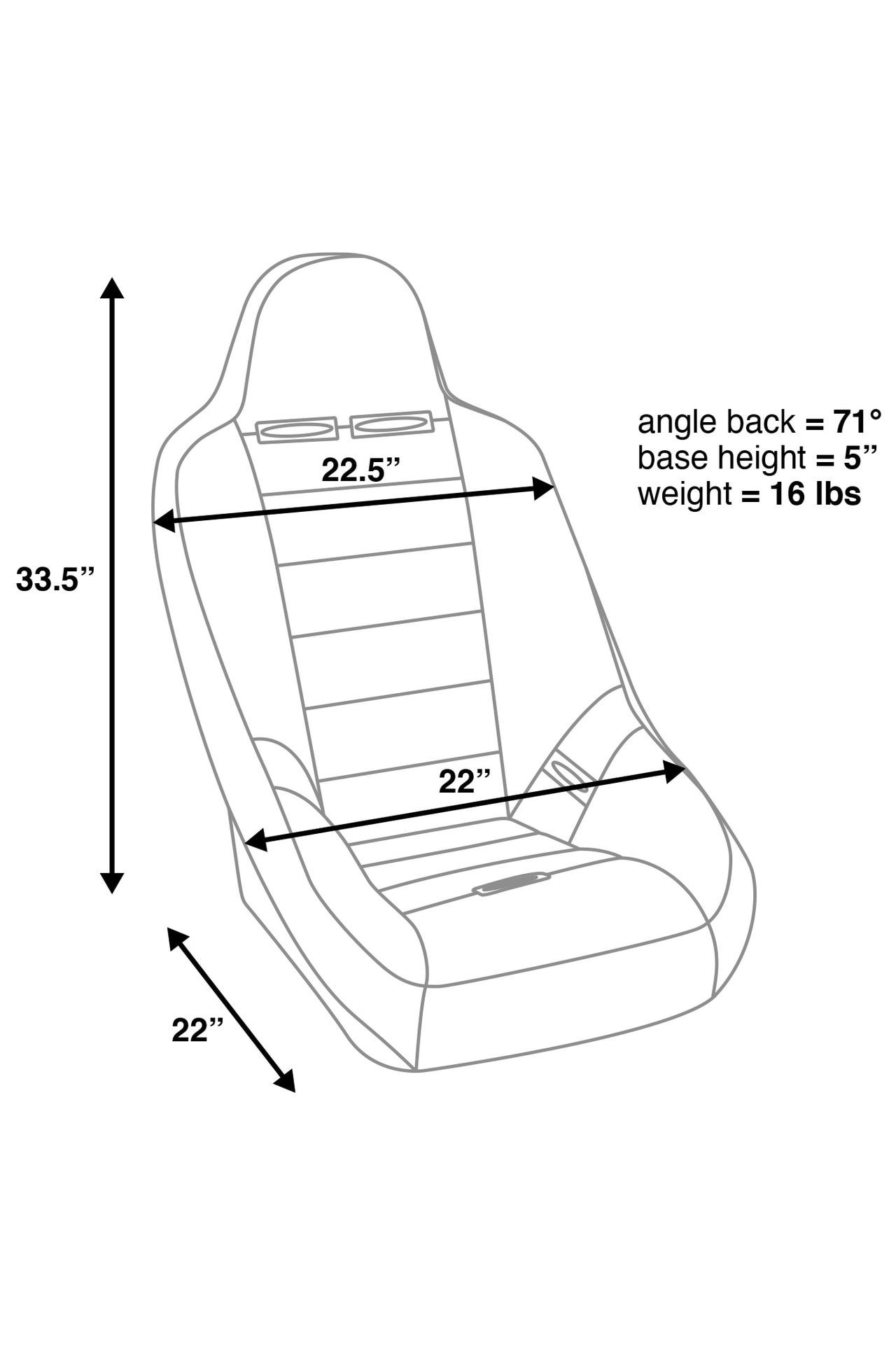

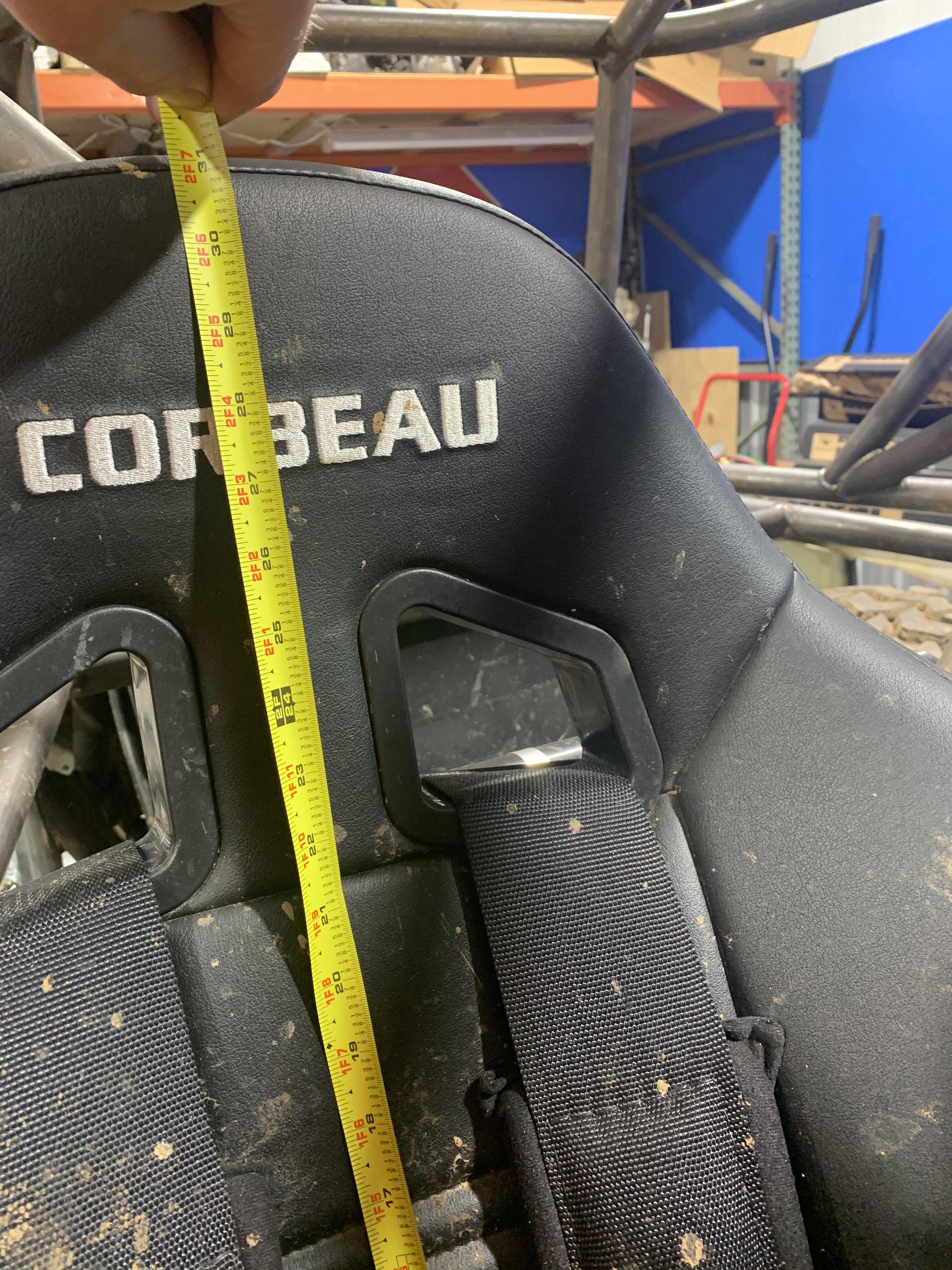

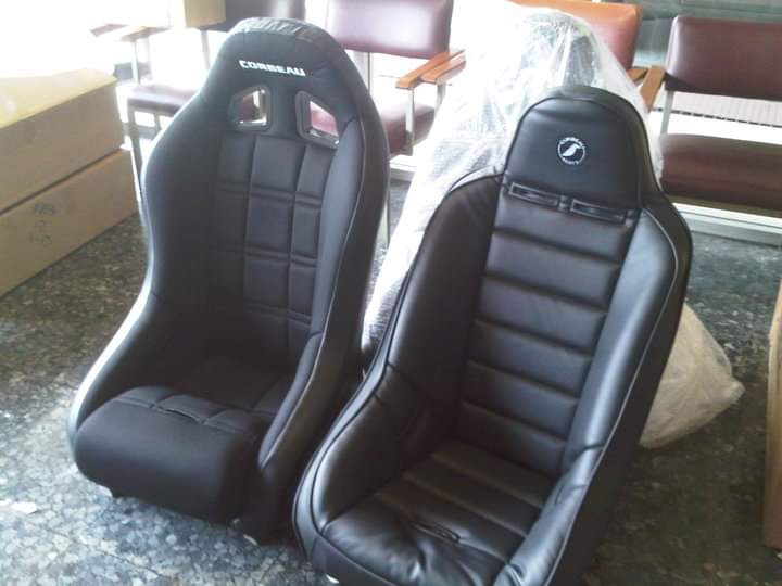

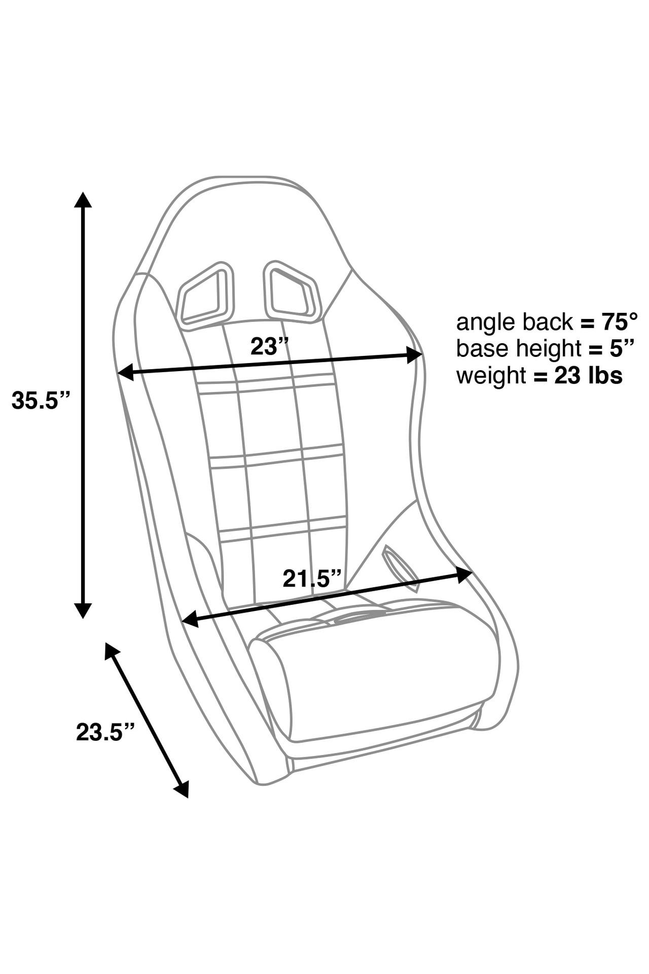

For future searches since Corbeau doesn't list it, my Ultra's have a seat to shoulder slot measurement of 22" & seat to headrest top is 31".
XP’s are the same measuring from the seat cushion, but for some reason I feel like I have more seat behind my head than I do when I sit in ultras.
393a7920-af1b-4a05-8c0d-06d5d00cad14-jpeg.121012
That's exactly how I measured mine, with the tape resting against the seat. That cushion is definitely a lot thicker then, so I see why you sit higher up using the same mounts. They're claim of the Ultra having the same seat height as the XP appears to be bogus.
XP having a 22"-24" shoulder slot is an improvement, but looks like for me at least swapping to the XP would be a big mistake & just take up more headroom.

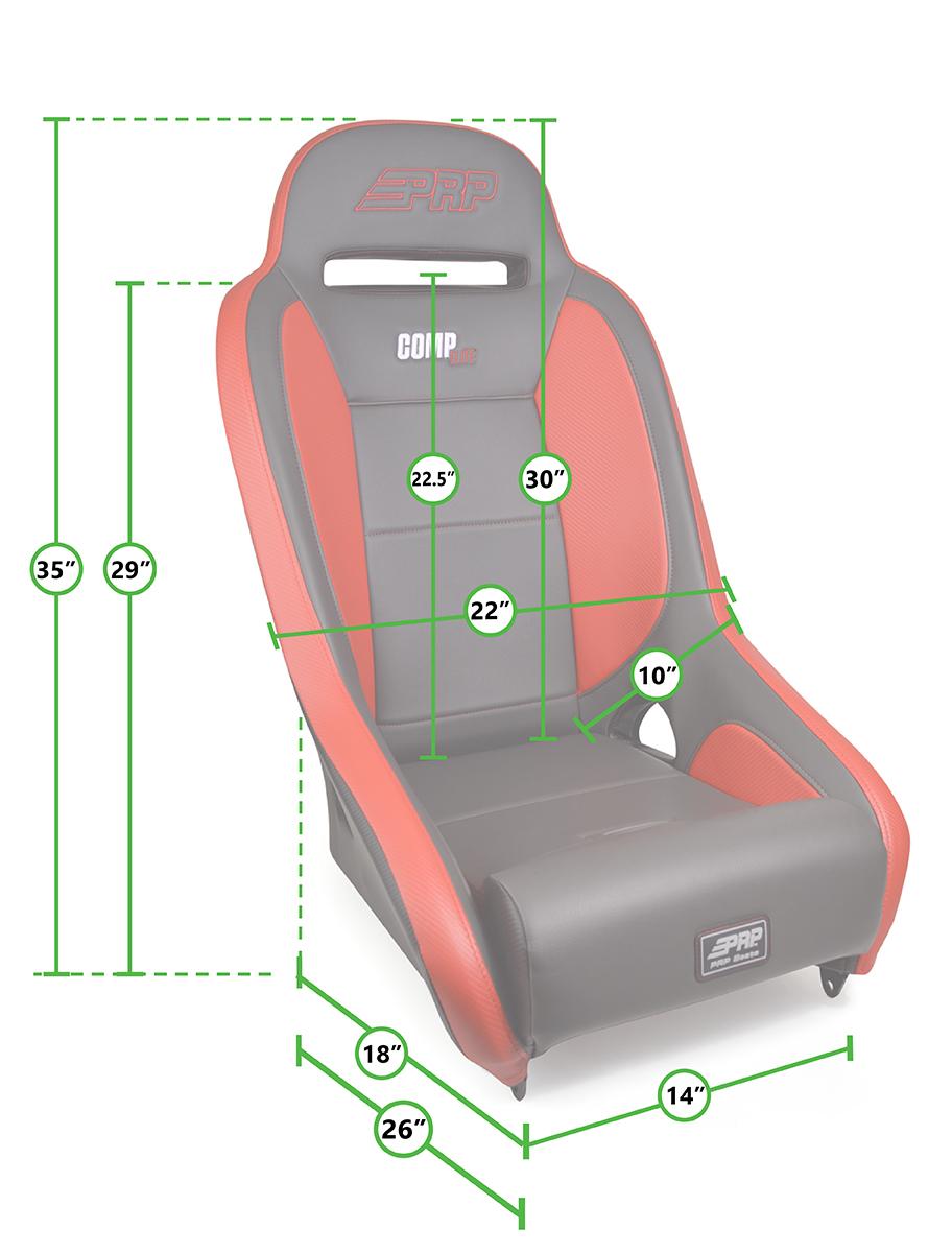

The Corbeau XP make you sit way more "upright" in the rig vs the ultra and other seats.

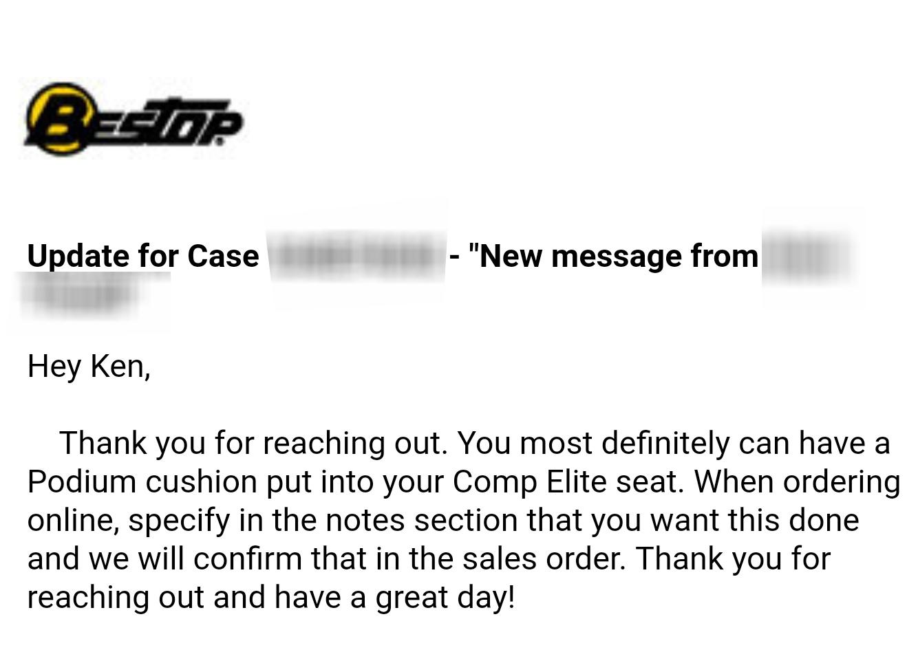

I've confirmed this today with PRP. Keep in mind that the Podium cushion is 1" thinner than the Comp Elite cushion so this will change the shoulder slot & headrest height depending on what direction you go. This also means the GT3 seat cushion is swappable as well. Each one is slightly different than the other.
I like the split front of the Podium cushion. This lets you remove the cushion without fishing the 5th belt thru and should keep water/dirt out of it.
I also called about the GT3 cushion and Jonathan said it measured the same thickness as the Podium.

Looks like the PRP Comp elite fits the bill. With a +2" height option and a -1" Podium seat cushion the end result will put me exactly where I measured myself. 33" headrest & 25.5" shoulder slot.
