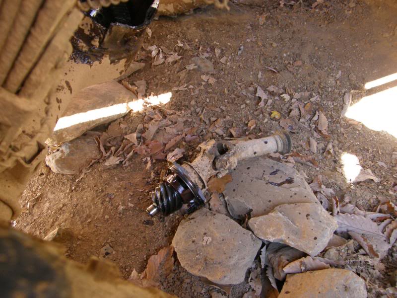

Was the 9" that broke the stock center section? I cracked mine, replaced it with a Strange Nodular center section and haven't had any problems with it since. Got it used from ECGS.

Yea it was stock. IDK if it was cracked. Might have happened earlier that day. That was trying to bump up Kodak. Back then, 08 or 09 N cases were not as easy to find for me as they are today. So I went 60's.
