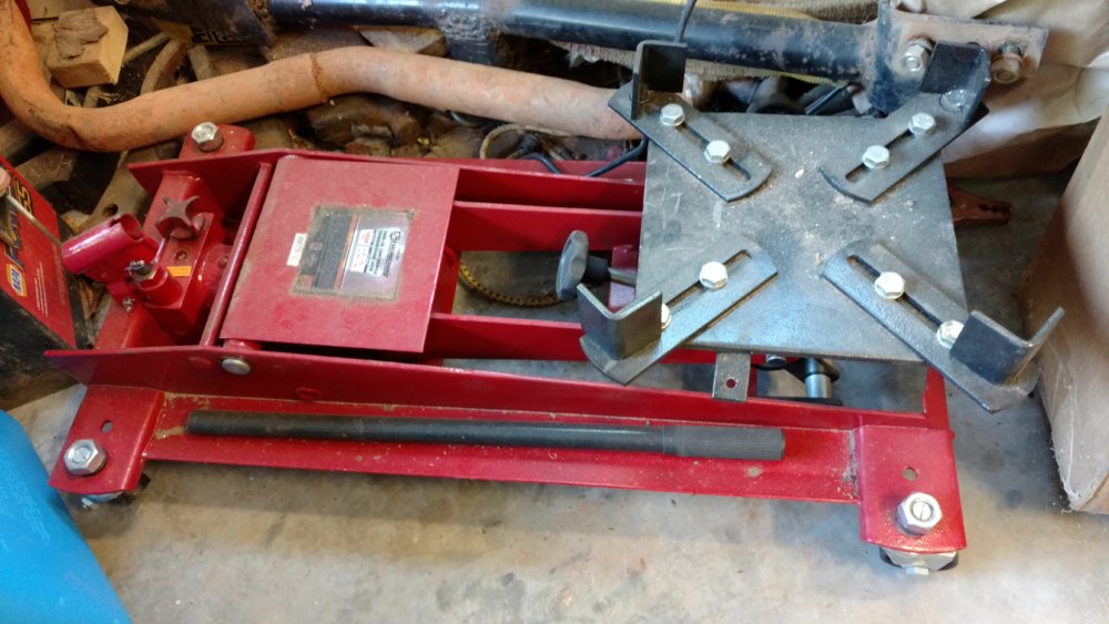

But I did a transmission swap when I broke my bellhousing using this.

I bought this jack about two years ago from Harbor Freight when I replaced the clutch in my Dodge. You are welcome to borrow it.
