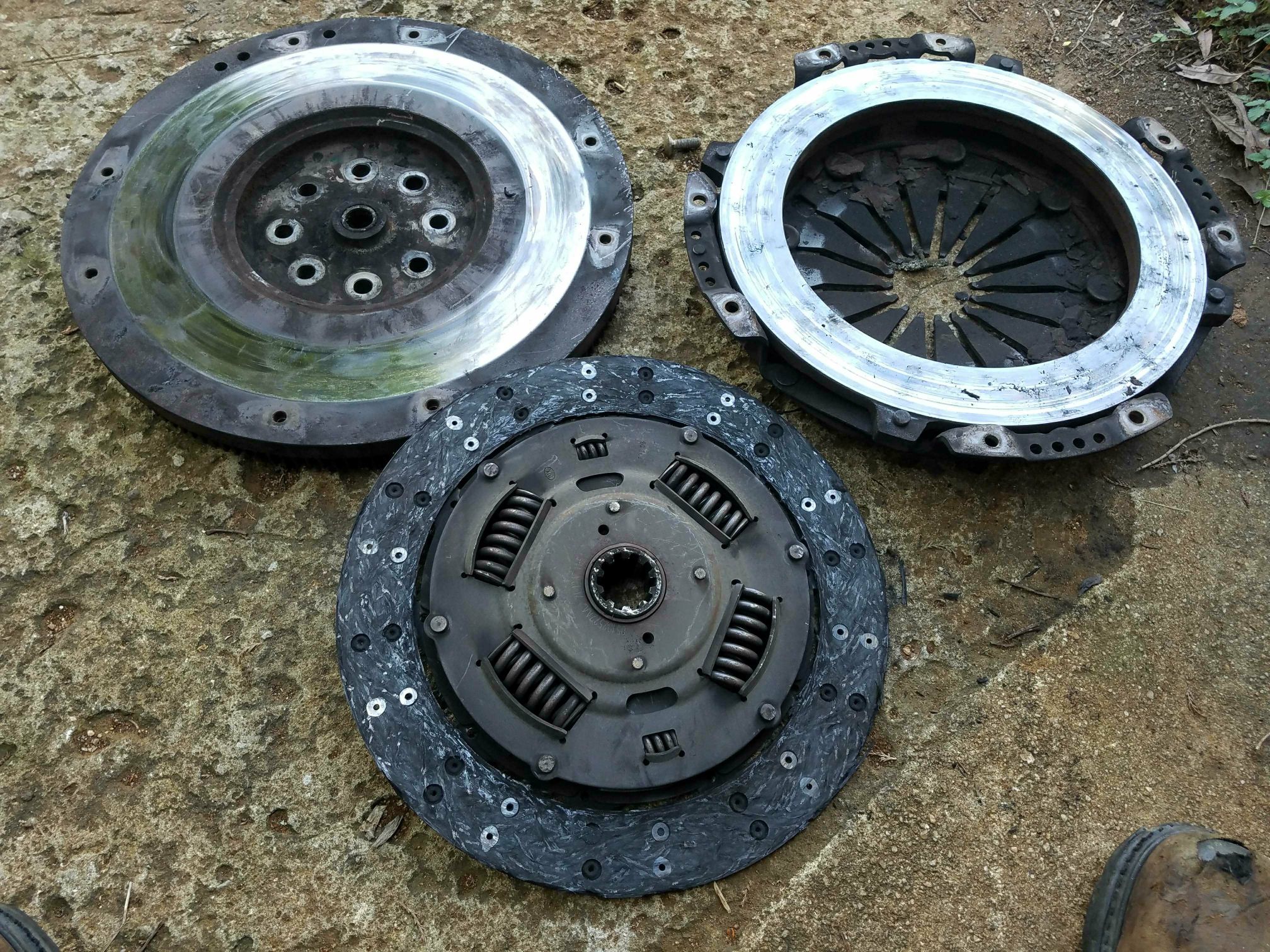

Thanks to @YotaOnRocks for use of the trans jack, and thanks to everyone else that offered. The old parts are out friction disc is worn to the rivets and the flywheel has a few good heat cracks so.... Yeah, it was done for.

The clutch that I pulled out was a LUK, but based on finding needle bearing rollers in between the flywheel and the crankshaft when there were none missing from the bearing leads me to think it's at minimum been apart before and likely replaced at that time.
