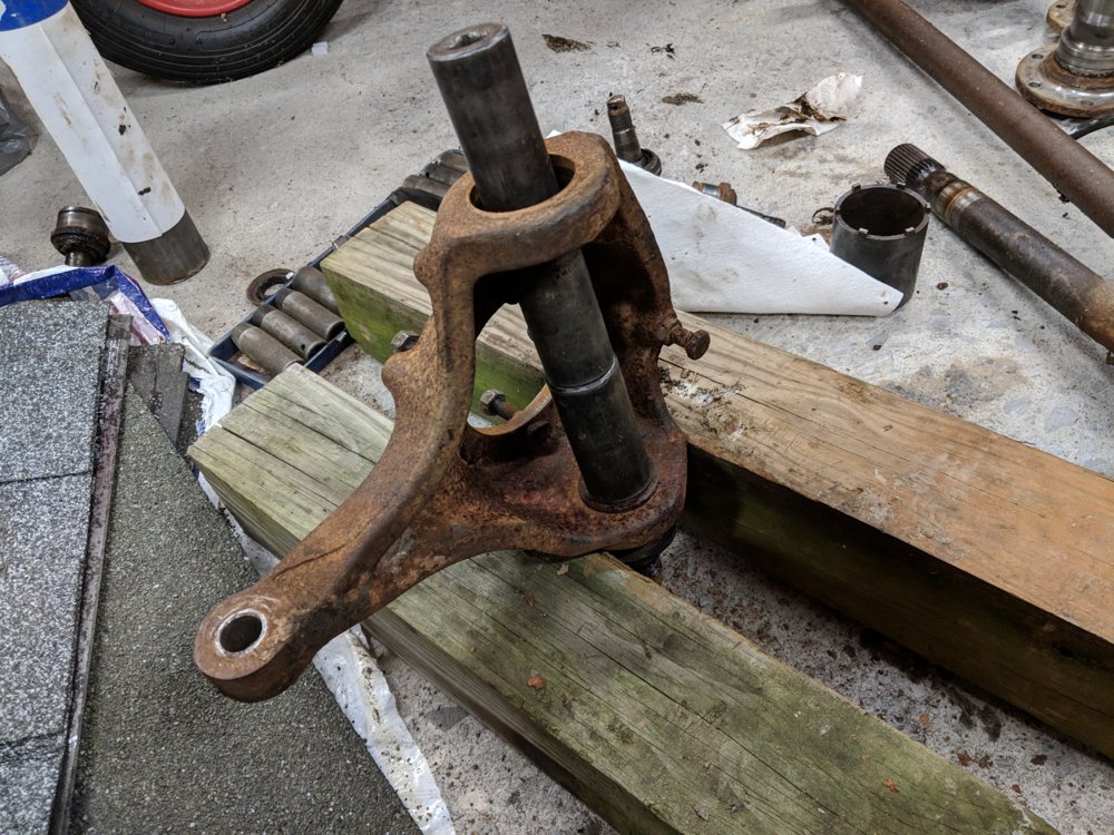

I tried to tackle removing the ball joints. I don't have my vice set up yet so that was strike one. Secondly, I didn't have a clamp big enough. Thirdly, I don't own a ball joint removal kit. Fourthly, I started out in the wrong direction :rolleyes: And lastly with my keen shop skills I used two 4x4s, three stacked impact sockets and my 3lb love (sledge). Behold:
Worked like a champ however it did take longer than I had hoped. Next up was these bastards.

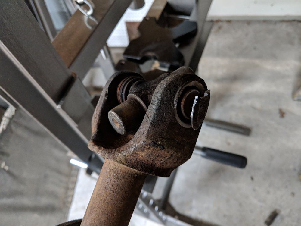

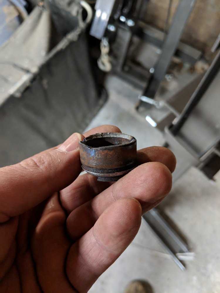

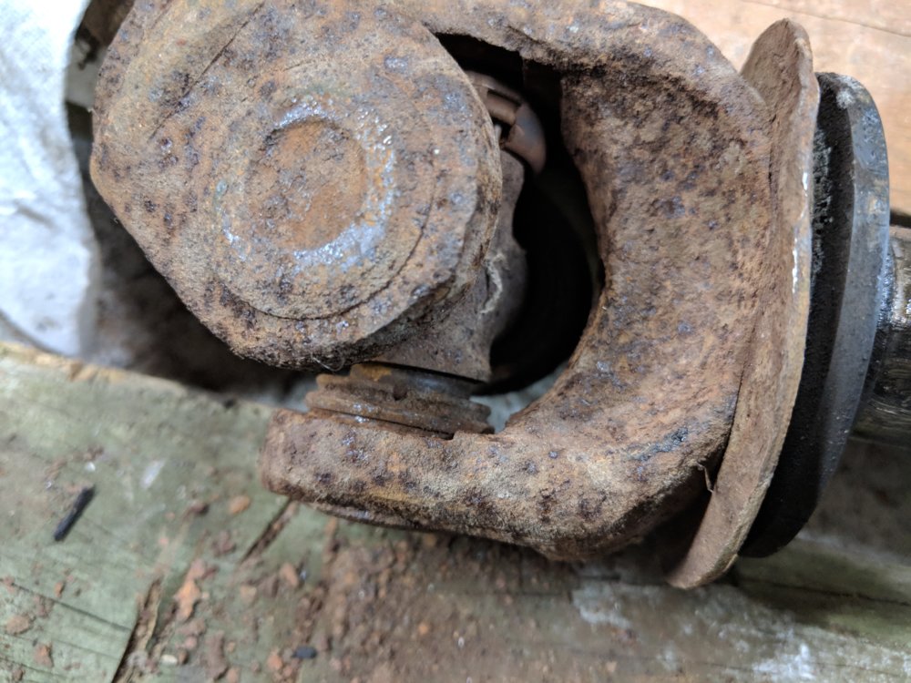

Today I thought I'd tackle the axle shaft u-joints. Holy damn these things were bad. I'm really not sure how I got one cap out already with the 3lb sledge. I stuck it under the press and figured I'd give it a little heat with a propane torch. I started waving it around the ears. Heating, heating, heating...POW!!

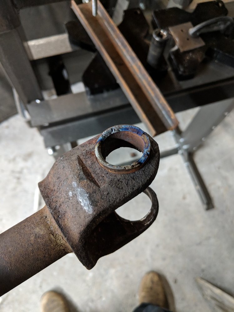

Awesome. At this point, with a little consultation, I decided to cut the remainder of the joint out and just press the remaining cap out.

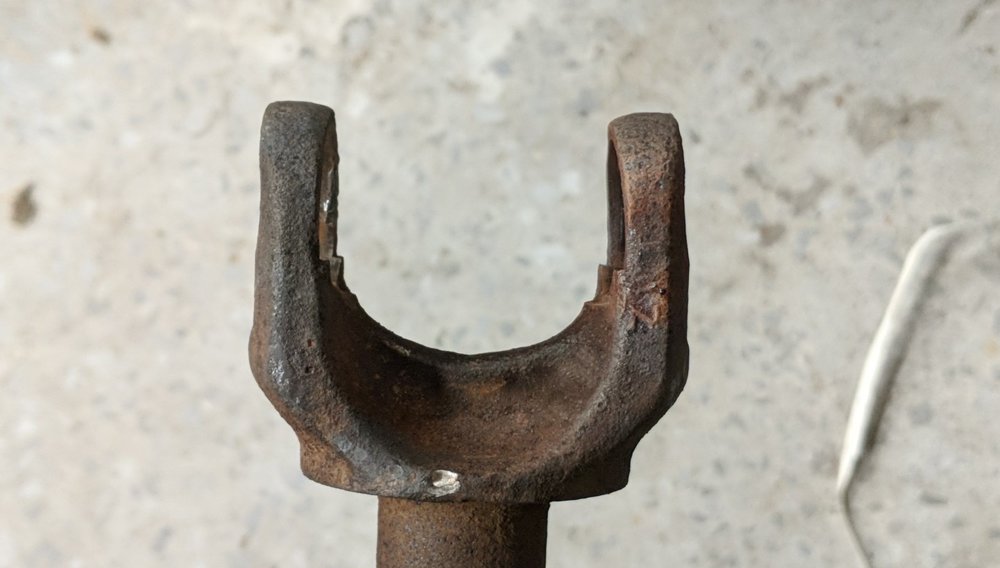

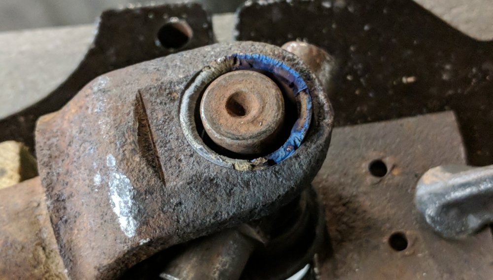

so with that out I take a look at my handy work and I see this...

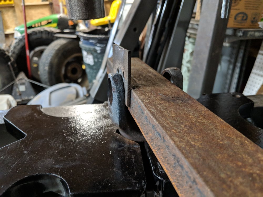

As you can see the ear is slightly bent in. I took a piece of c-channel and threw in a small "wedge". Once heated, I drove the wedge in and straightened things out.
I then repeated the same technique for the long side axle shafts. Same issues as before. U-joints were froze up and not going silently into the night. It took me all afternoon to do this silly shit. These were by far the worst axle joints I've ever faced. I don't know why but I feel the new joints will be a PITA. When ears move and joints bind you just get that feeling.
