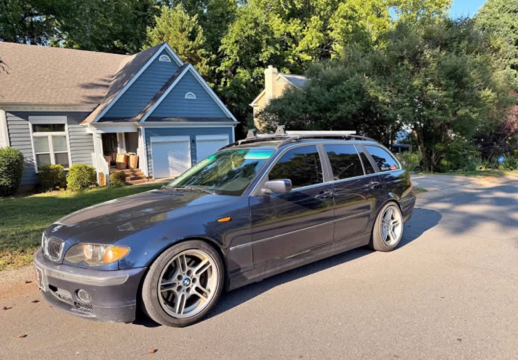

Probably a long shot since it was already pending 3 hours after posting, but dude said he would let me know if it falls through. 2001 2.0 m47 diesel swapped bmw with a zf5 manual transmission and 272,000 miles. Swirl flaps deleted. Everything I’ve read says it’s a very reliable combo but 25 year old BMW makes me feel like it will be a money pit replacing old worn out part even if the engine might be bulletproof.

You’re right, I misspoke, its an m47 not m57. Agree that a week long test drive would be ideal lol. It looks clean and pretty well sorted…and it’s a wagon.

That being said, IMO a 25yo car is going to need work, BMW or otherwise. Suspension bushings, hoses, wiring, etc.
Can't speak towards diesel, but the cooling system on this generation are failure prone and the rule of thumb is to replace at a minimum all the plastic components and water pump at 60k miles. I would assume all that is done with a swap.
Seat sliders wear out but it's a super cheap part you can get off amazon, just takes an afternoon to do it.
Window sliders wear out (not sure how universal that issue is?). If you force the windows after the slider is worn out they can potentially tear the door.
My car has the getrag (I think), but the shifter rides on an arm that uses bushings that wear out along with all the other shifter components. Again not sure how universal all that is and hopefully it's been taken care of with the swap.
BMW also uses a bushing between the trans and driveshaft which wears. Again, assuming that has been taken care of when they did the swap.

An E46 Chassis car like the one the OP is considering is probably the last generation of the ones I would own, but it absolutely wouldn't be someone else's swapped car.
