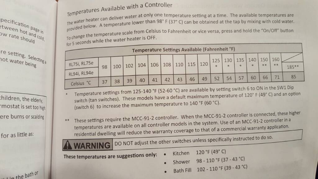

If you find it let me know. Ours is at 120On our rinnai there is something in the manual that tells you how to turn it up hotter then it will let you normally. Think there were some tiny switches inside.
Ours is set at 135 I believe.
