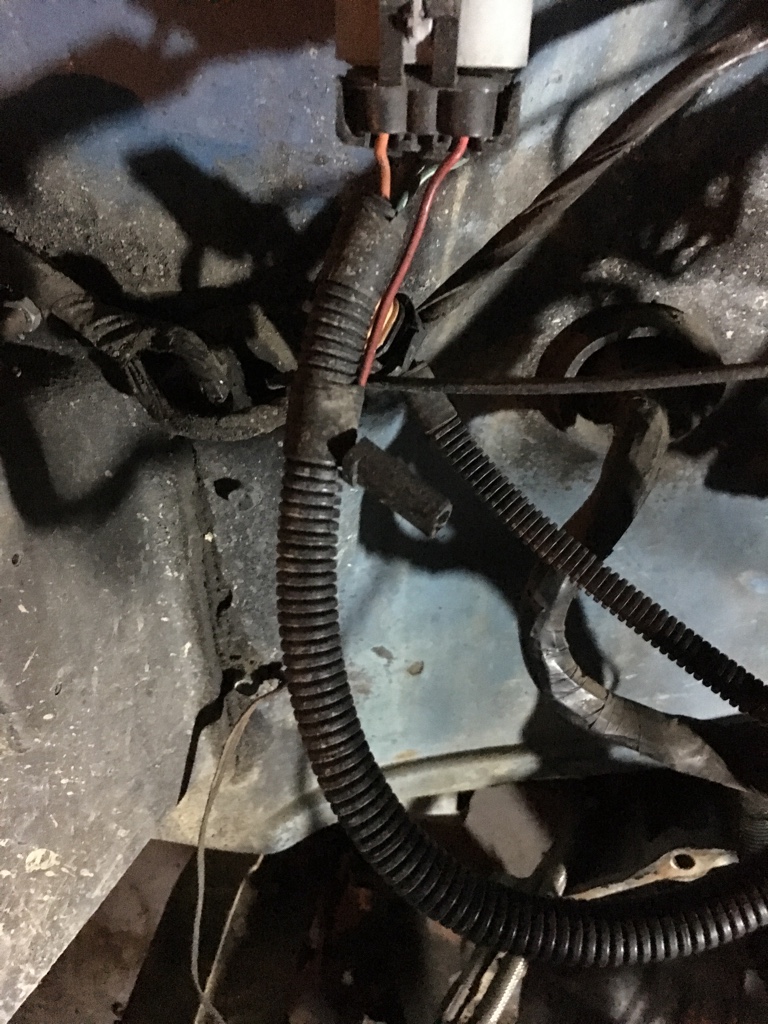

Have you tried the relay on the firewall?
This is the one he's talking about.

im thinkin its a harness problem. i work as a mechanic at a shop in kings mountain, just never ran into this before. it just seams weird it all happened all at once
You put another engine in it, maybe you pinched a wire somewhere. I know the ignition modules give them a lot of trouble, but if you have injector pulse it rules that out
also gonna say that i replaced the distributor, fuel relay, oil pressure switch, changed the fuses, and checked the grounds
pinched wire is very possible
Yeah you're gonna be chasing wires I'd make sure part of the harness isn't pinched by the bell housing. I've got to clean up the wiring on my k5 and replace some connectors.
