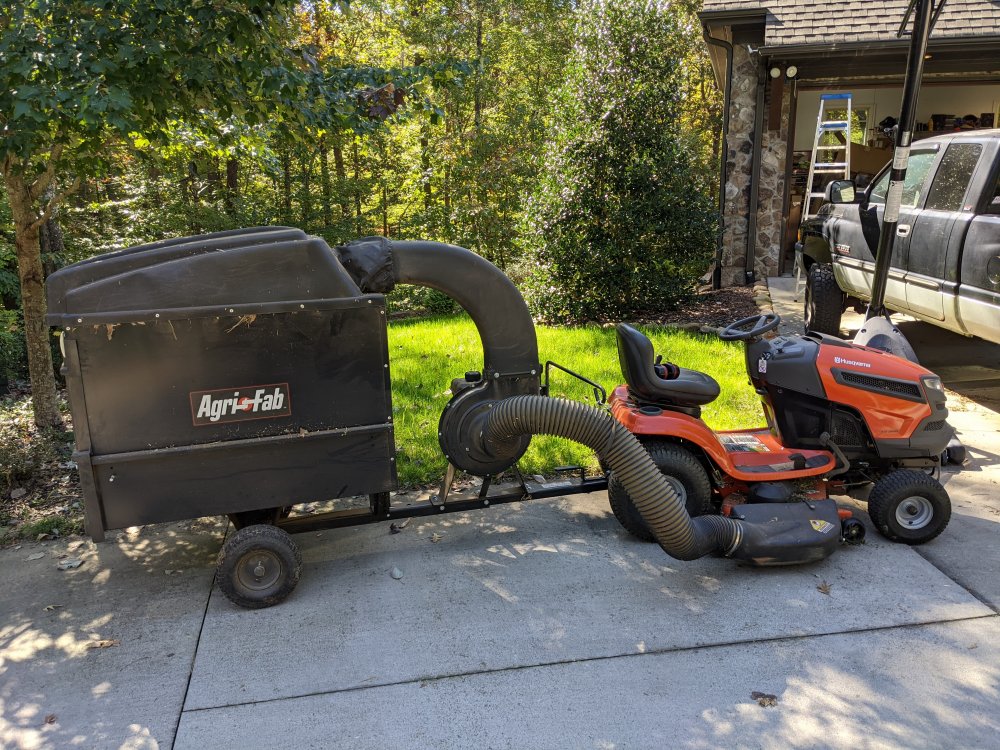

Hooked mine up today for the first time this season. I topped it off with gas and it started on the third pull. I have a nice Stihl backpack leaf blower, but it used to take me 3-4 hours to blow all the leaves, then another 1.5 hours to mow. Now I get up the leaves and mow at the same time and it only takes about 1.5 hours. the lawn vaccum is heavy. My old Craftsman 16 hp riding mower would struggle a bit to pull it up hills. My new Husky 24hp mower pulls it like a diesel.

My dad has a Peco 20x trailer vac, with all the crap to hook it to his ZTR. It does well, but 2 complaints: With the ZTR, you can turn too far and pull the hose loose; and the trailer isnt big enough.
So i suggest using as big of a trailer as you can pull.
