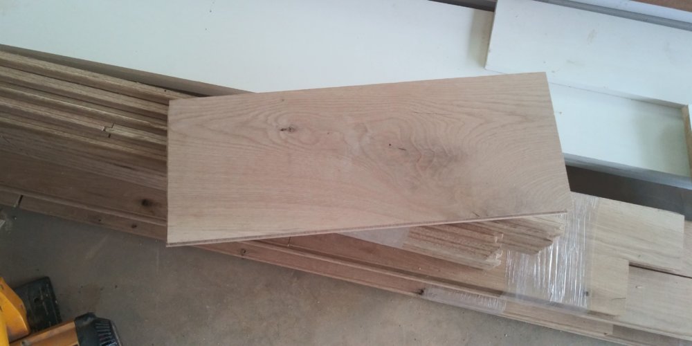

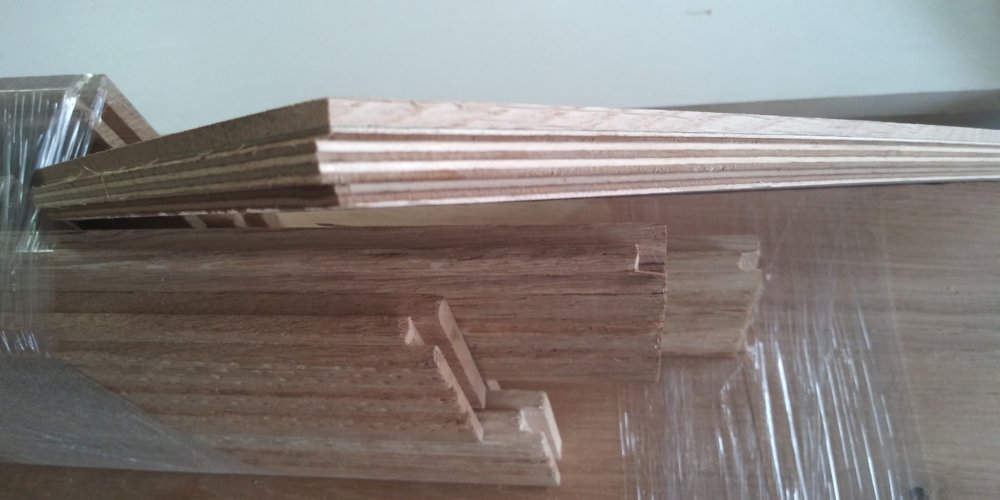

7"x5/8" engineered unfinished vs 3 1/4"x3/4
This is a cheap engineered product in my inventory.

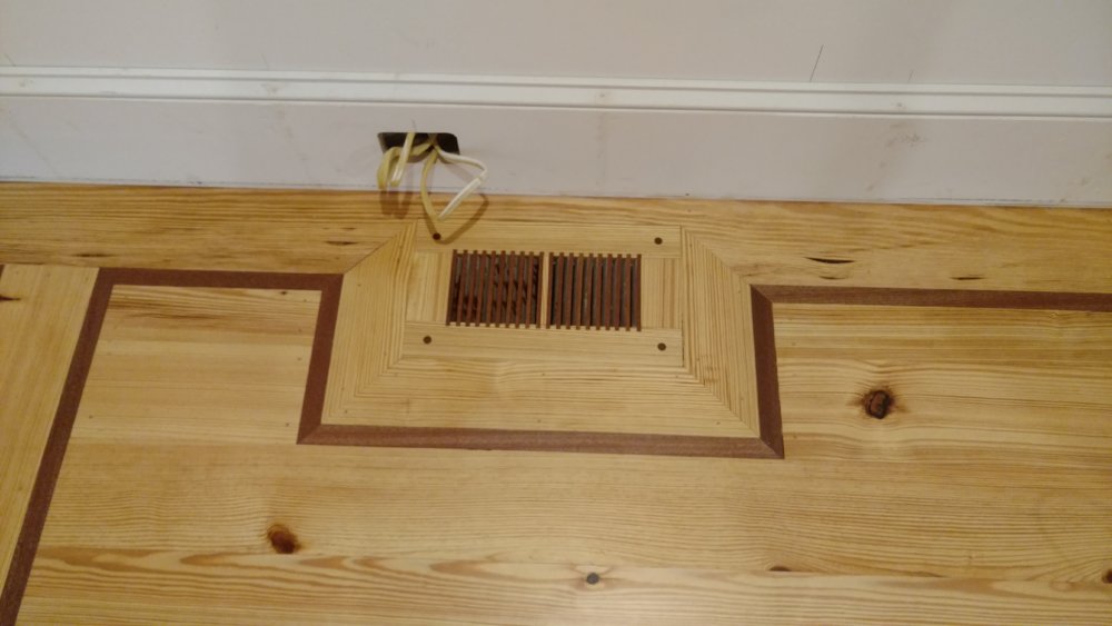

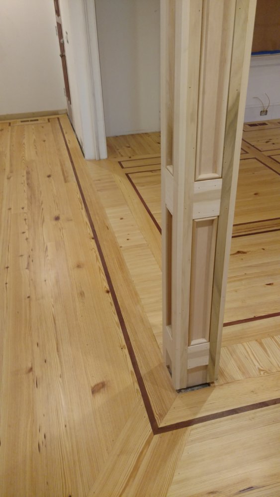

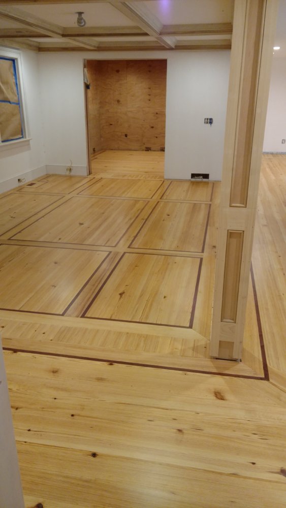

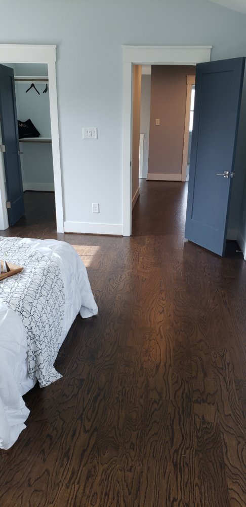

Looks good! I like the walnut plugs and slats on the vent. Whoever did the work likes their trade.
Thanks. The plugs, slats and boarder is mahogany... Sapele actually, but everyone still calls it mahogany. I did everything you can see in those pics. I did not finish the floors tho. I have a crew who does that for me. You cannot do everything I guess.
