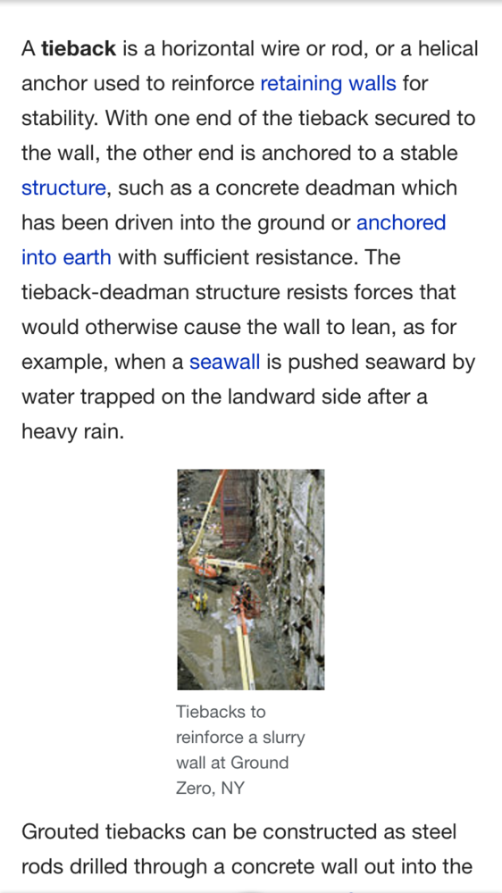

Showing my ignorance, can you explain more of what tiebacks are?
For the purposes of a short residential wall, the tieback doesnt necessarily need to be complex.

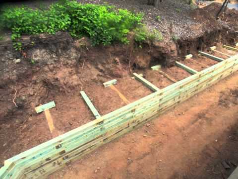

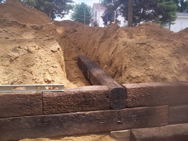

I've built a few 4' and less walls with railroad ties and treated 8x8s; we just installed an 8' long timber perpendicular to the wall and buried it in the bank. That is usually sufficient and always has been for the walls I e worked on. We placed more and at staggered intervals depending on length of wall, height, soil type, and if the wall will see any abnormal hydraulic pressures, etc.
I usually call them deadmen like @rockcity just showed. I have typically used concrete as my deadmen but it sounds like his method works just fine. I would try and find some railroad ties to build it out of as they are already treated and have good dimensions. Got a picture of your backyard for reference?

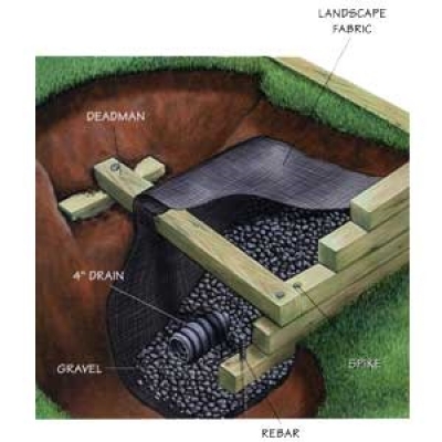

Here are a few examples illustrating what I was talking about.
Depending on your materials of construction, your setup may differ some.

I've built railroad tie retaining walls 5' using the same concept as this and had no issues they still holding 8 years later! One thing if any higher than 5' I've found the perpendicular cross tie needs to be as close to level as possible my first wall in 2003 came toppling over bc I had the tie ends dropped down pushing the wall forward after a year!
