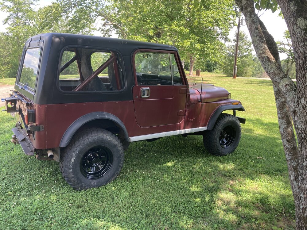

The CJ7

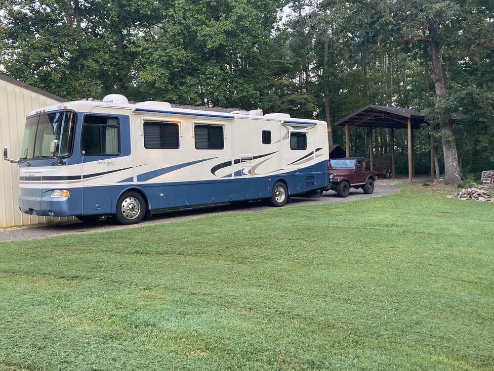

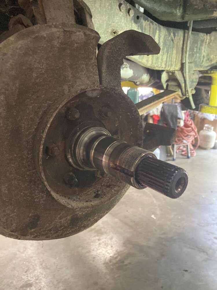

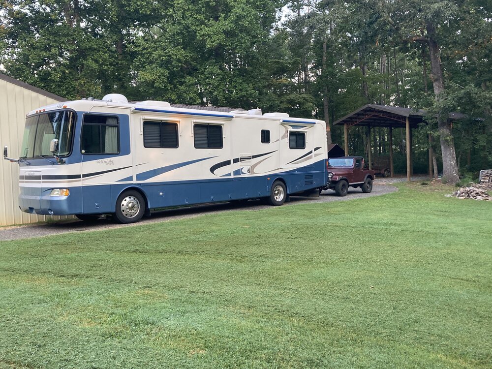

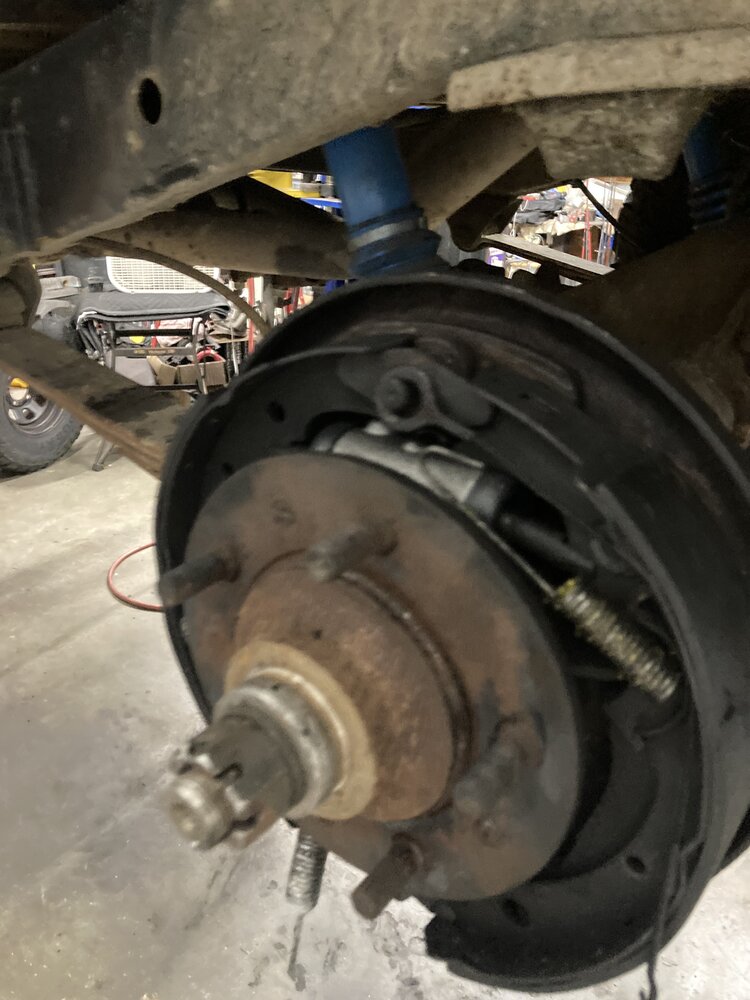

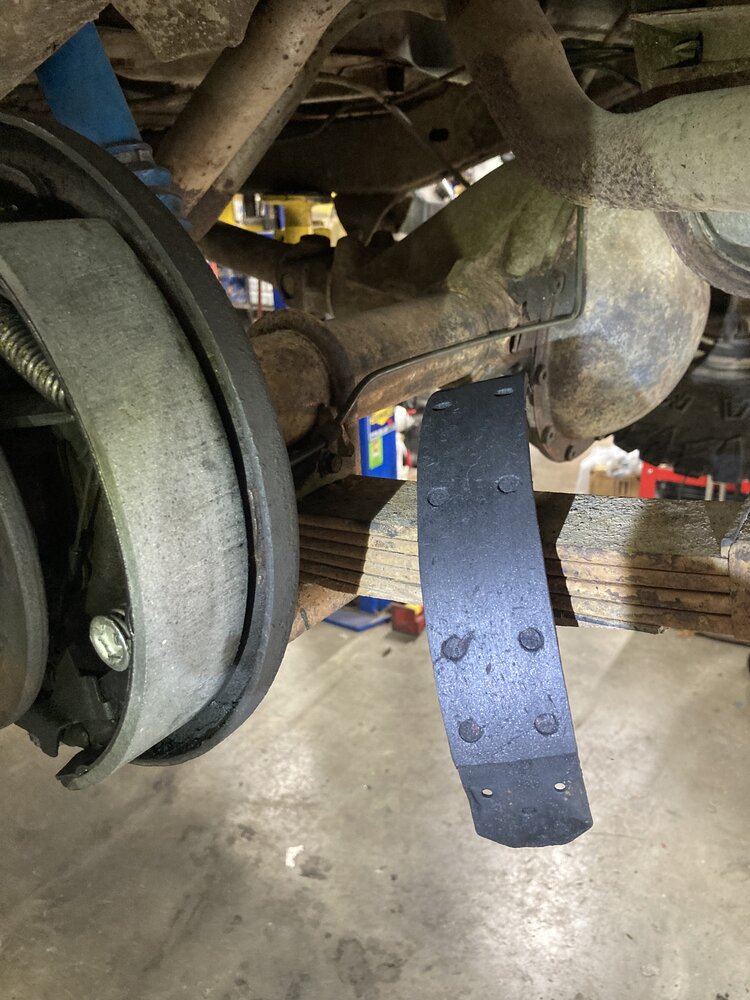

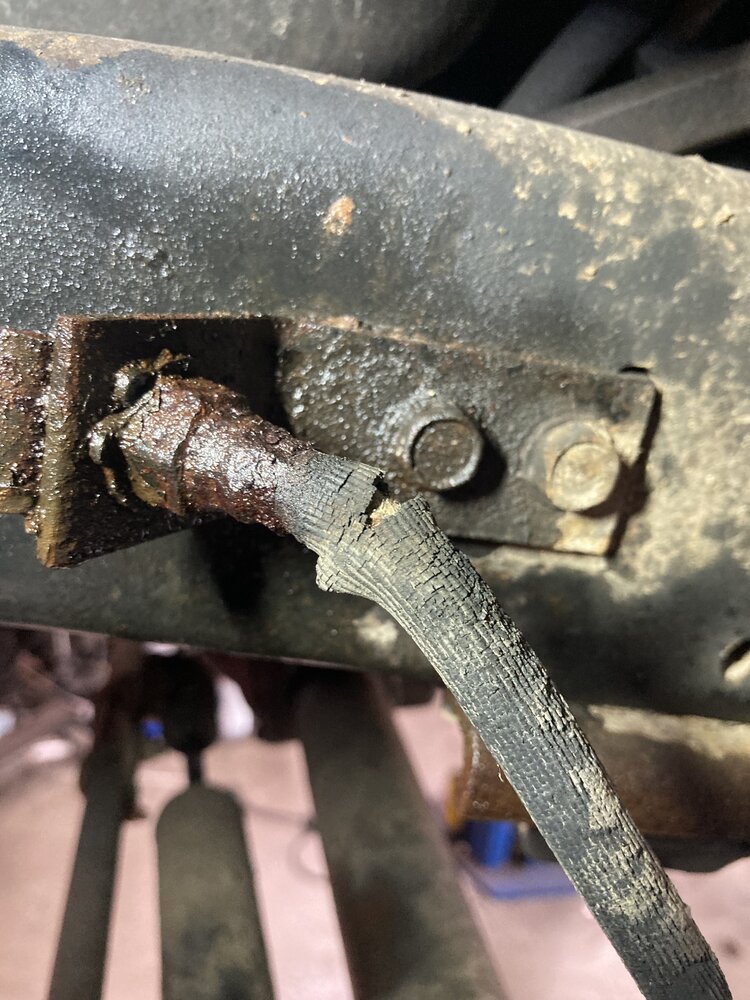

Well in an attempt to take the CJ to the Jeep Invasion instead of the JKUR, I figured I had better change a leaking rear brake cylinder. Well that led to replacing a rear hard line, which led to needing two new front soft brake line, which lead to repacking front bearing, which led to replacing hub seals. It sure isn’t like the old days when you go to the parts store and readily pick up everything you needed for this. Only thing in stock was the wheel cylinde. :cool:Hopefully parts arrive today.

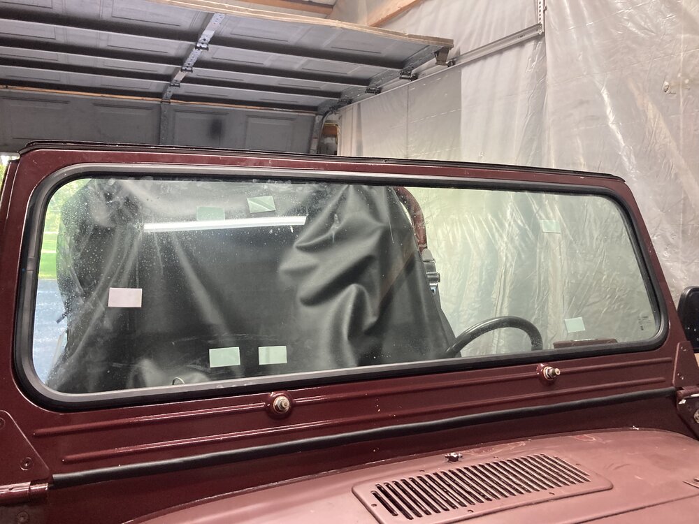

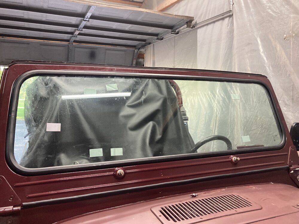

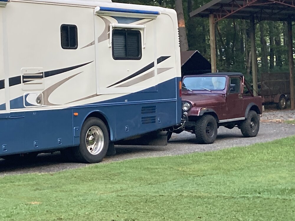

Ended up having to get new brake shoes for the rear. The other ones were just too soaked with brake fluid. Then moved back to the front and closer inspection of the calipers told be to just replace them both. So that is what happened last night. Finished up packing the bearings with new seals and installing the hubs, then replaced the calipers, rubber lines and bled brakes. Should stop like a new one now. Installed new lockable center console as well and added the tow lights to hook up to the RV. Installing new windshield this evening and should be ready to roll.
Looks like we are heading to the Jeep Invasion. Installed windshield last night and buttoned up a few other items. Wish us luck!

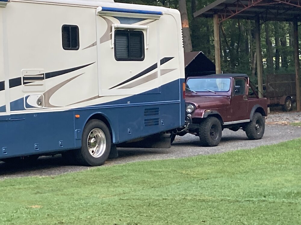

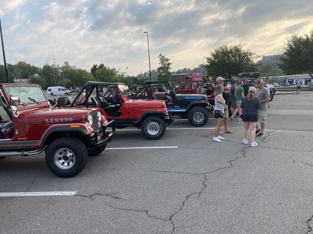

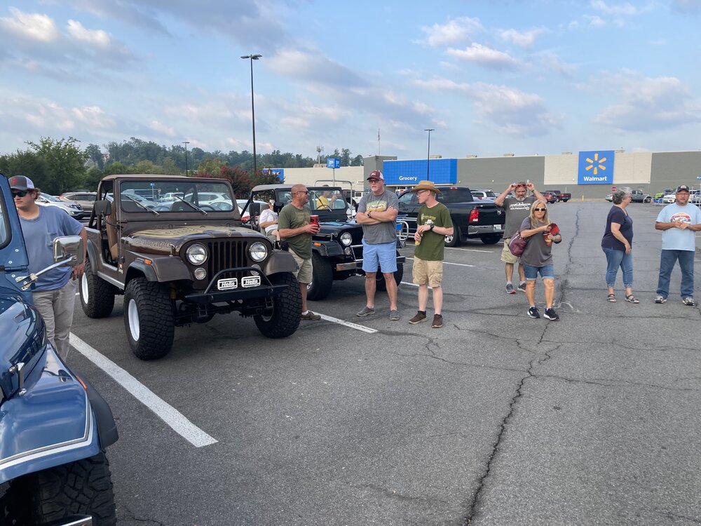

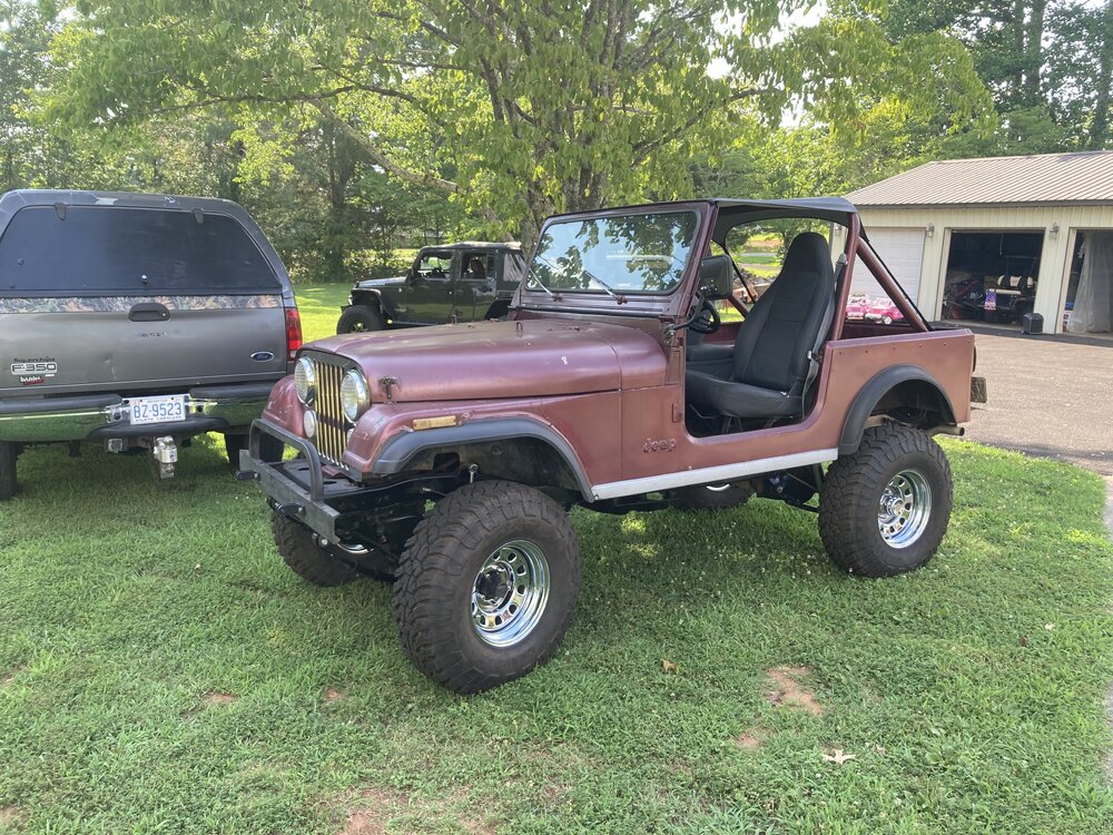

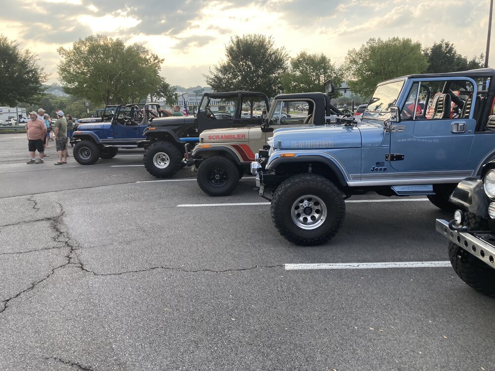

All good! Trip was great, besides being hotter than hot as was pretty much everywhere. The little CJ pulled well behind the motor home and had a good time tooling around Pigeon Forge and the back country. Met up with around 50 other CJ's on Friday morning at the Walmart in PF for a meet and greet. We all left there, headed through town and took the blue ridge parkway on a scenic ride that dropped us down in Townsend. The early morning temps along with the elevation made for a super enjoyable ride.

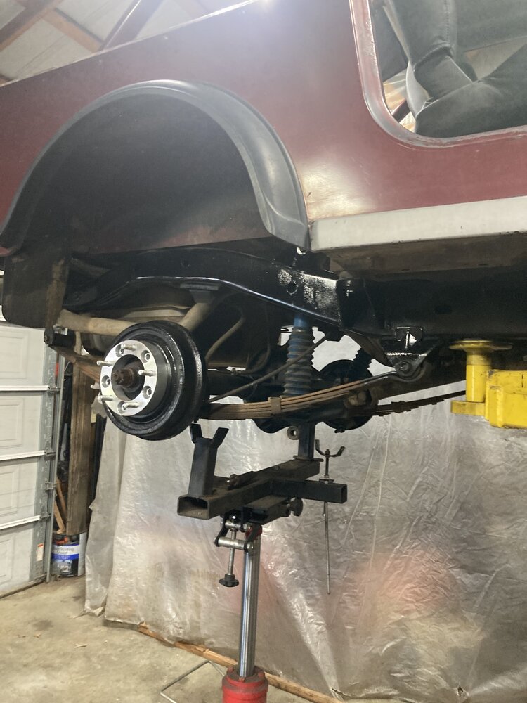

Added some 1.5ā€ wheel spacers to widen the stance.

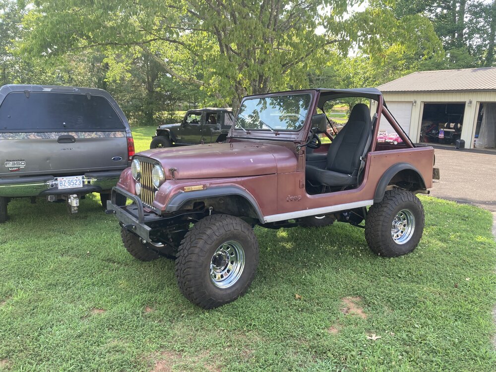

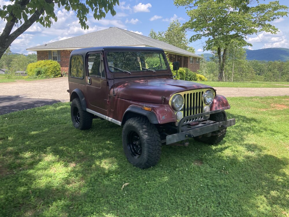

Here is where it goes downhill. I wanted a 2.5ā€ lift. I knew I wanted a 2.5ā€ lift. Started researching and recommended 4ā€ for 33’s. So I went with 4ā€. I am still pissed off about it.

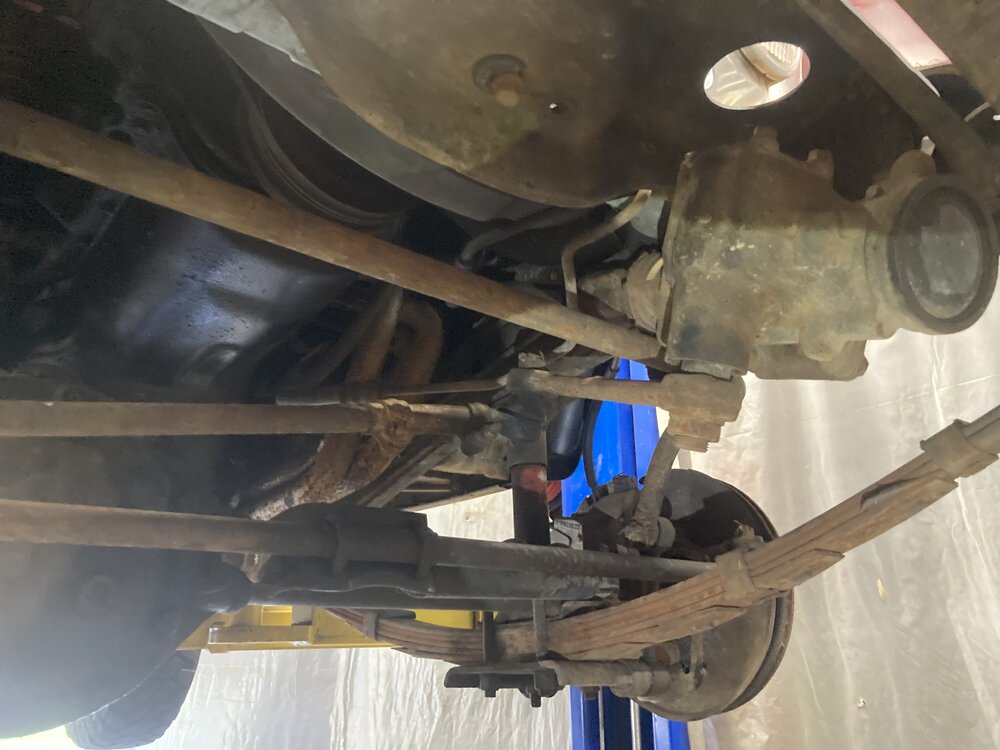

Of course needed a transfer case drop. This went a lot easier than expected.

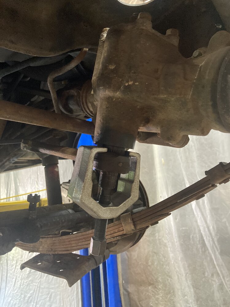

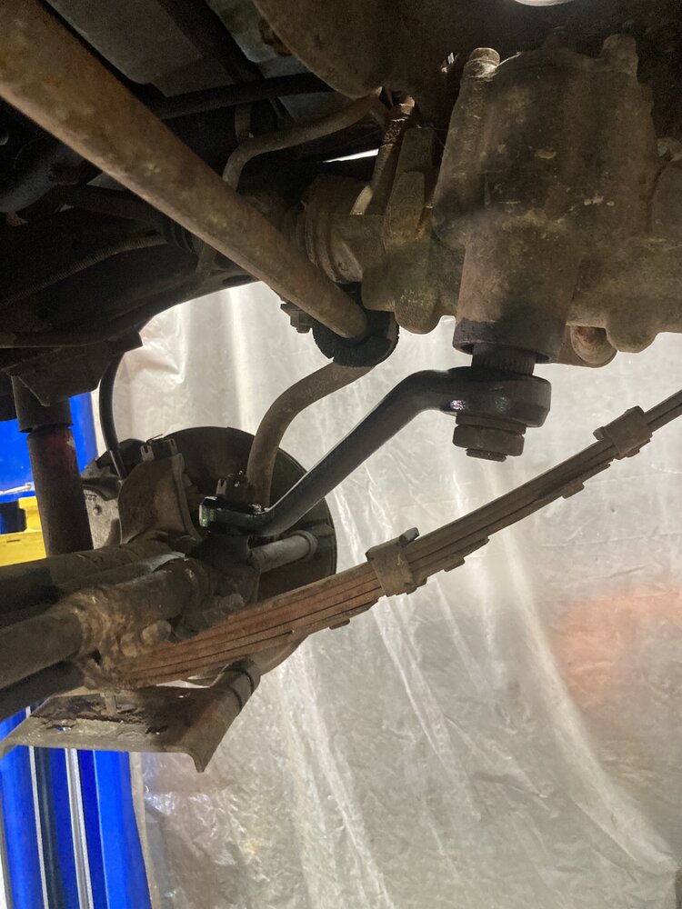

Also drop pitman arm, again easier than expected.

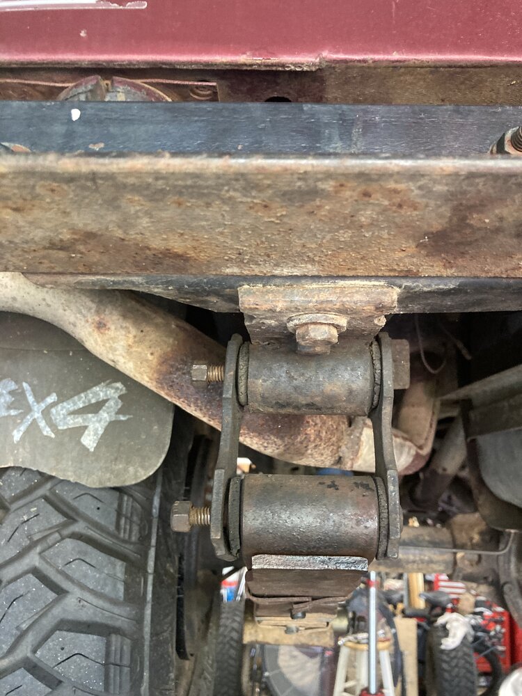

The spring hangers were just an expected for a 44year old vehicle. Ended up just cutting them off.

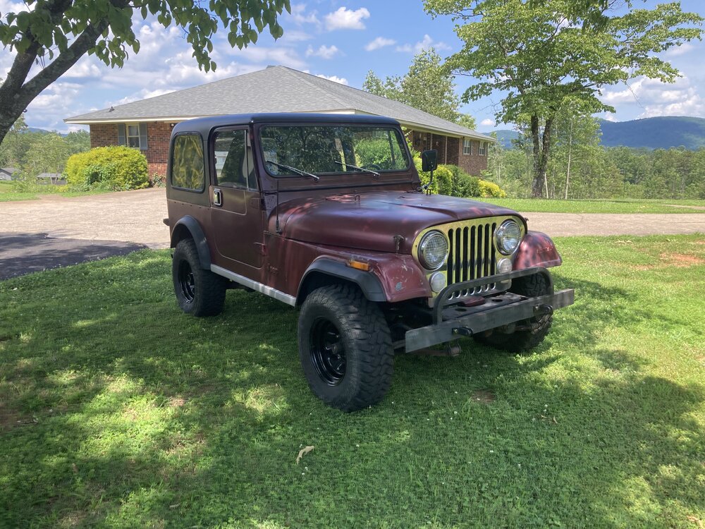

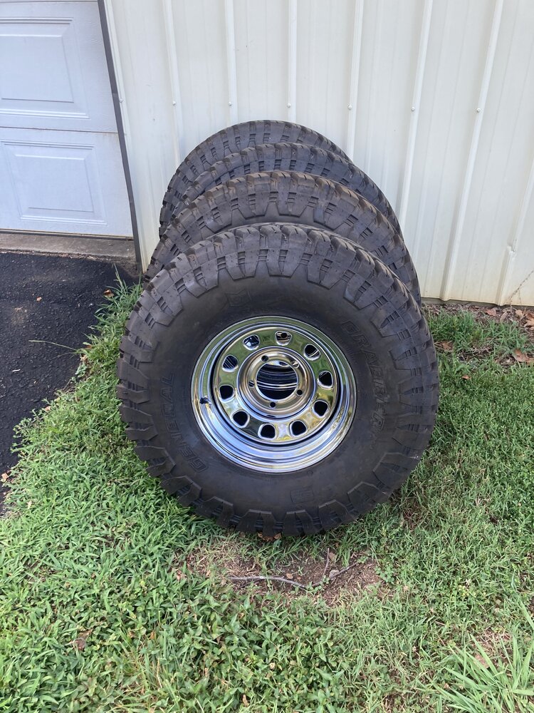

New 33/10.50’s and old school style chrome wheels ( Laredo )
Cleaned and painted the frame while I was at it.
Front springs on
Rear

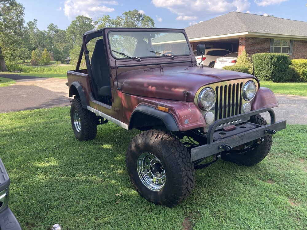

After setting it on the ground, went to back it out and clutch would not engage, wtf! Well when I drop the t case, the rod to the clutch was hanging up on the header collector clamp. After a little clearancing, it was all good. Then I re-centered the steering wheel and took for test drive. All good except for it is too high now! The net lift is almost 6 damn inches based off of the old flat wore out ones. I am going to drive it for a few weeks, but will probably be removing a leaf to see if I can lower it done some. I am getting too old to get in!

Looks great. You can fit 33x10.5 with a 2.5.
Looks good man! Reminds me of my old cj7! What brand lift kit did you use? It is really tall for a 4" lift! wow

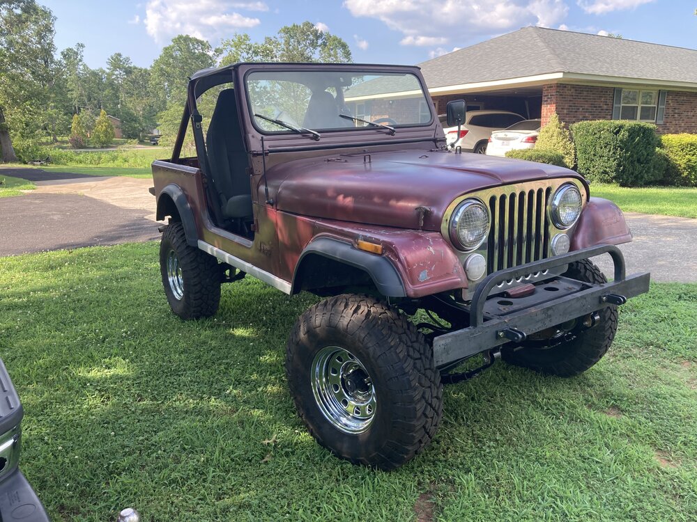

Gave the CJ some more love.

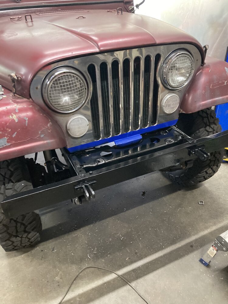

Painted the front bumper

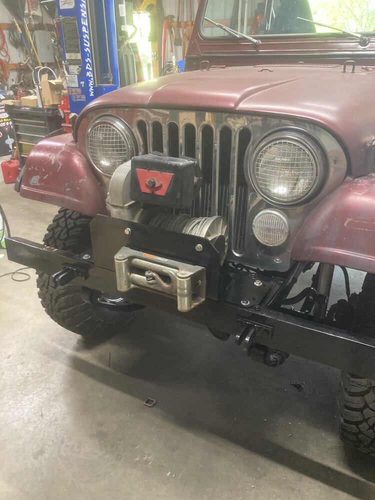

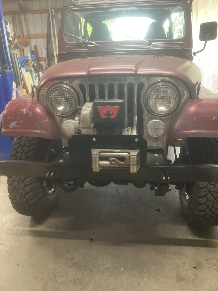

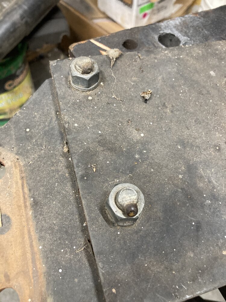

Next was the addition of an 8274 I have had in the shop for 10 years or so. The mounting plate had extensions on it. Must have been in a high crime area as all of the nuts were tack welded and needed cut off. :shaking:
I cleaned and painted the winch mount, drilled some holes and mounted the winch.
I need to get some longer batter cables for it next. Looks like we are heading to the Jeep Invasion with the CJ next month.

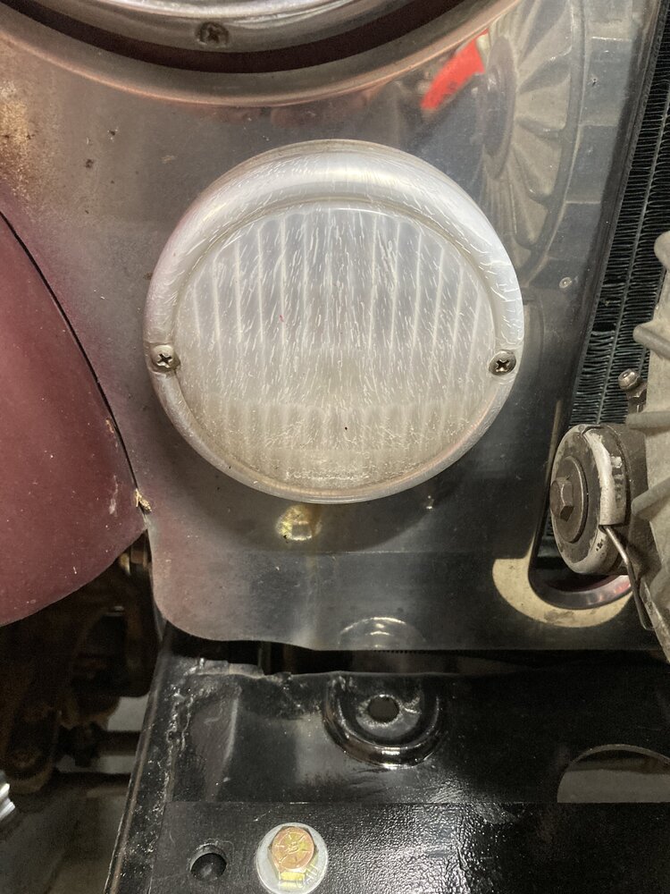

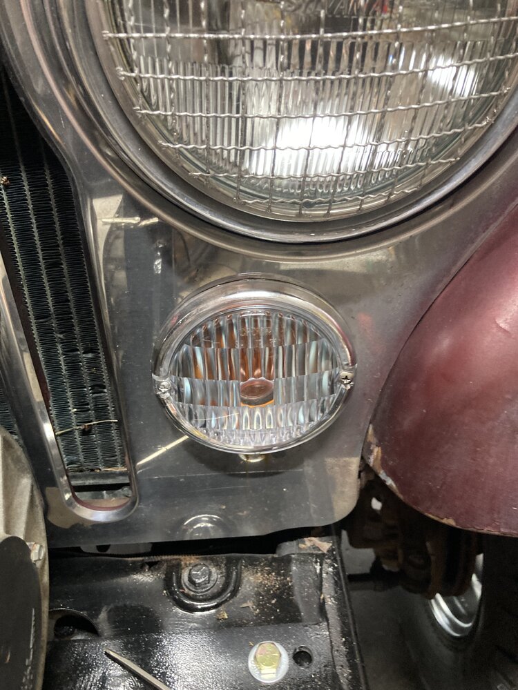

Front park/turn
Before
After

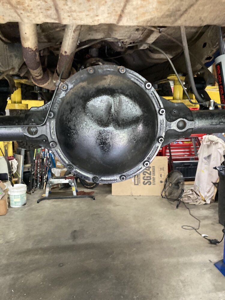

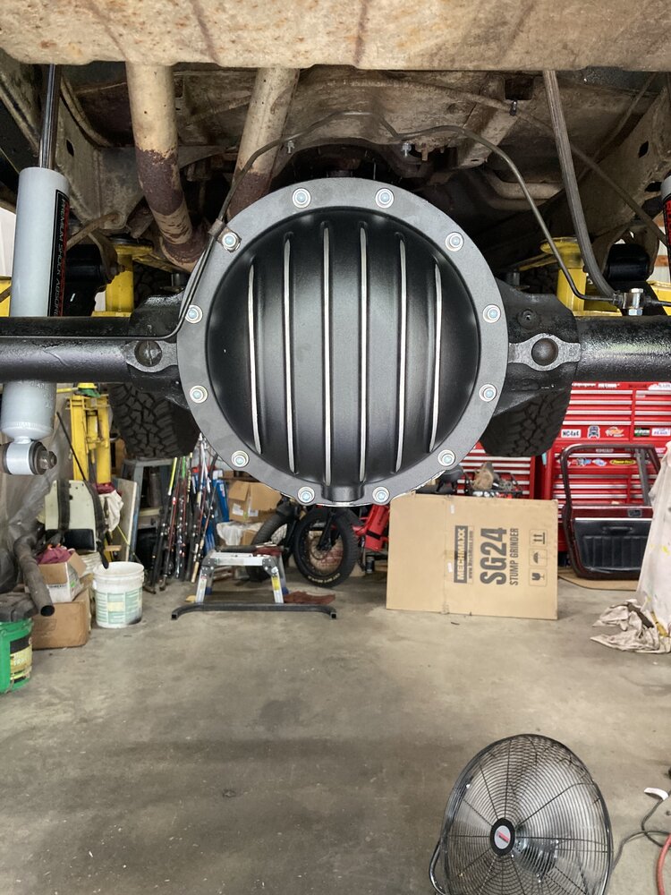

Diff cover was dented which bugged me. Upgraded to a little more capacity with a drain plug for future use.
Before
After

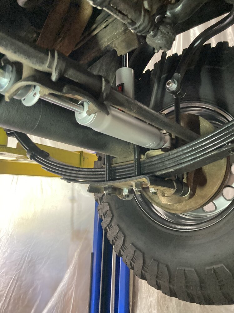

The steering dampener was shot, had no resistance at all. In with a new one.

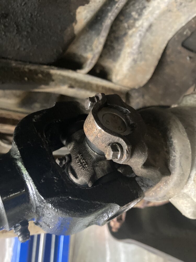

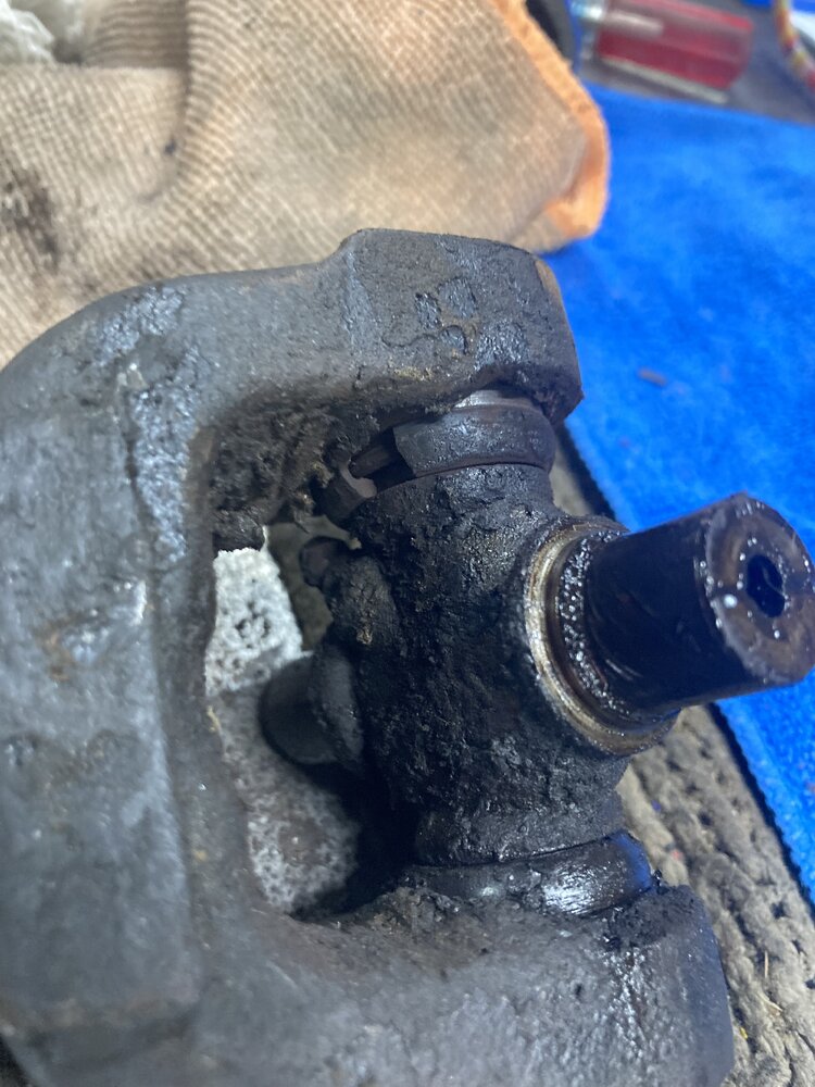

New rear unjoints. Front joint was giving vibes, Went and replaced both.

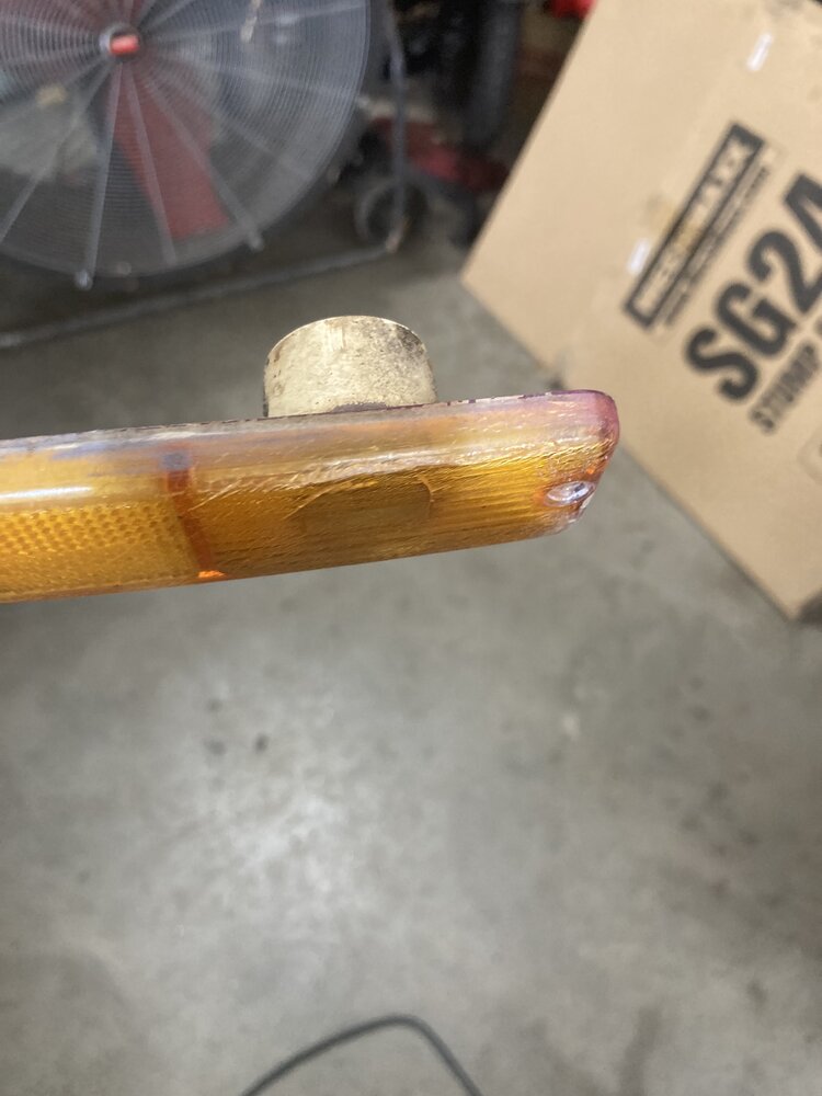

Fender marker lights were in bad shape, so a couple new ones.

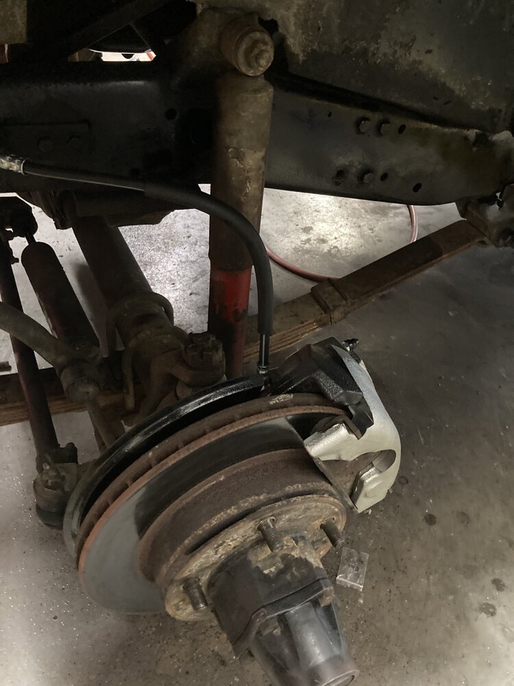

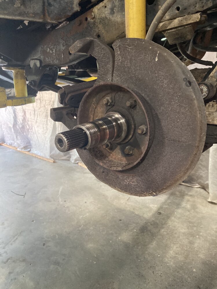

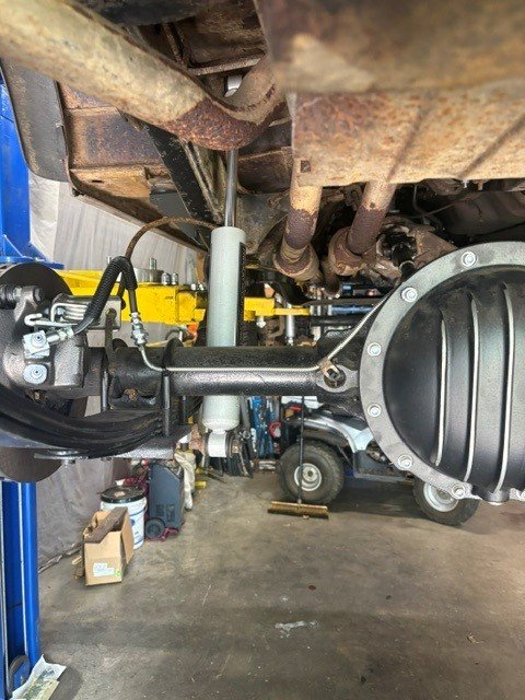

Got some more work done on the old CJ. A few years back I picked up a complete set of front and rear SSBC disc brake kits on the real cheap from someone who purchased them and sold their jeep before installing them. This kit was really complete, with rear brake lines, seals, bearing, front SS lines, everything needed. The fronts calipers are billet dual pistons with 12.5" disc. However, I need to find some drum brake outers in order to install the fronts so that will be another day.
First order was to install some one pc axles I pick up over Christmas on sale from ECGS.

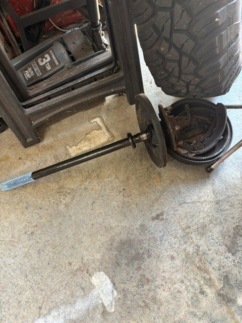

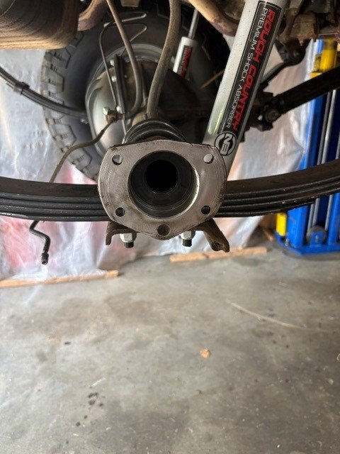

Out with the old 2 pc axles and drums

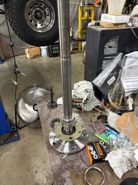

Axle tube cleaned up and new axles getting prepped for bearings to be pressed on.

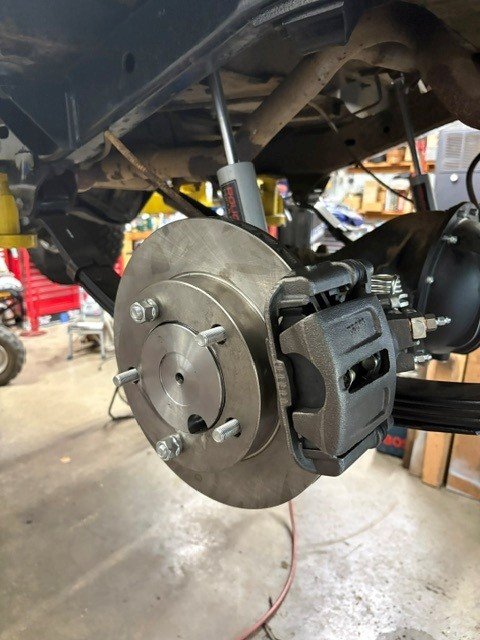

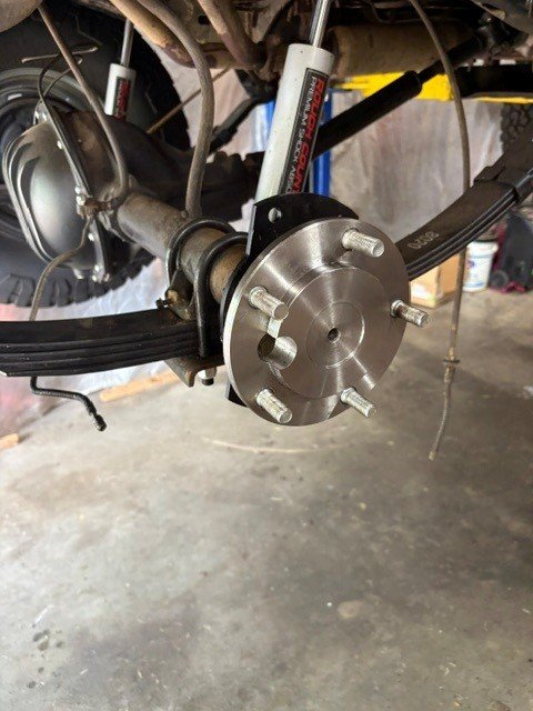

New studs and axle installed with caliper bracket.

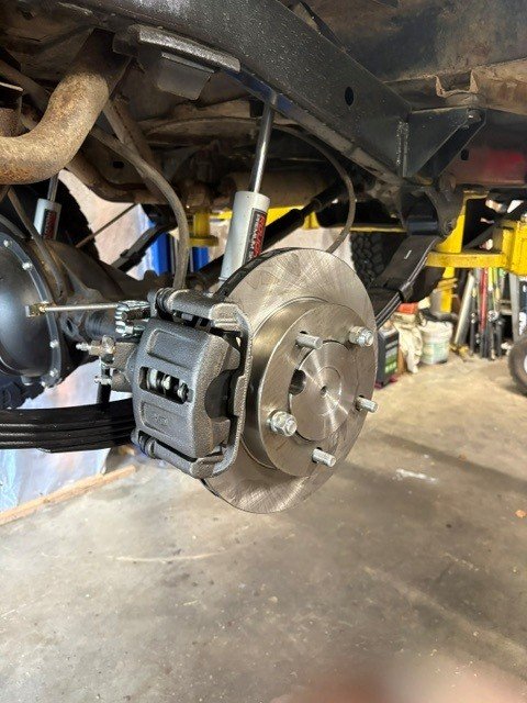

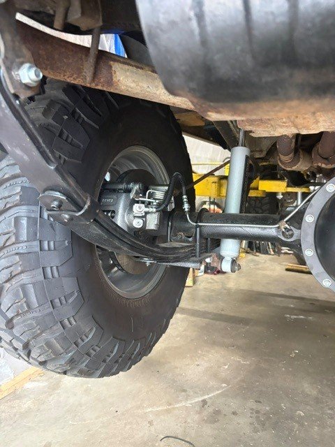

Calipers installed

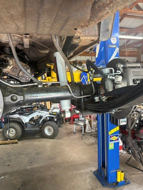

new hard lines
finished product with a working Ebrake
