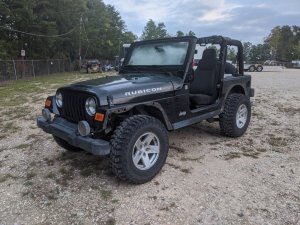

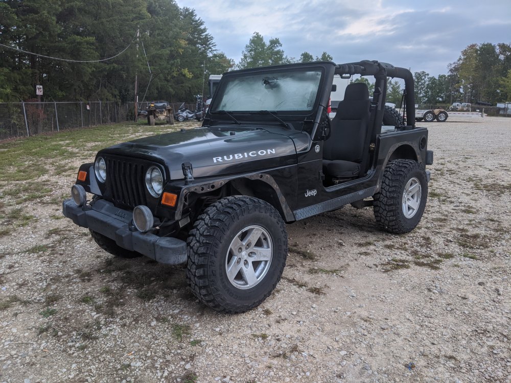

I've been wheeling the Titan off and on since 2008, but I have really always missed having the visibility and manueverability of a smaller truck like I had with my old D21. I decided (ok, ok, Rebecca and I decided) to look for a used Jeep. After spending a day learning the many different variations and options, we decided that I wanted a TJ Rubicon with the 4.0L.
We found my TJ in Birmingham and went up to pick it up for $16k with 133k. It had clearly never been off-road, however it had been repainted and the Rubicon sticker had been reapplied in the wrong location, so I went through it and made dang sure it was a real Rubi. Everything was there and it was exactly what I was looking for. The test drive was smooth if a little underpowered, but no issues at all except for a lot of split loom in bad shape under the hood.

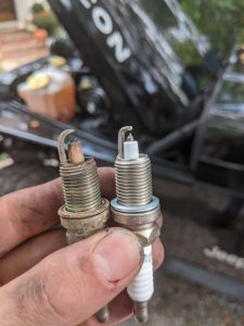

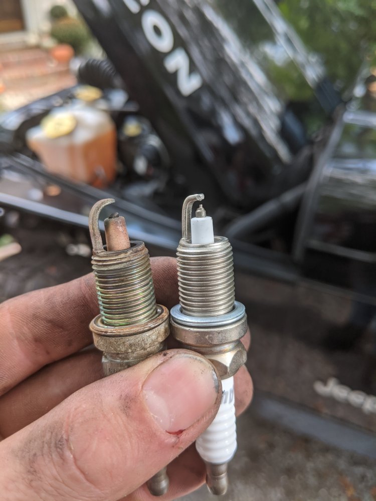

We took it almost immediately for a 2000 mile road trip and it did great except for kicking a code for an O2 sensor that I changed out along the way. Gas mileage was awful, but that turned out to be due to original plugs at 136k.

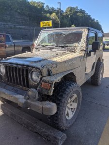

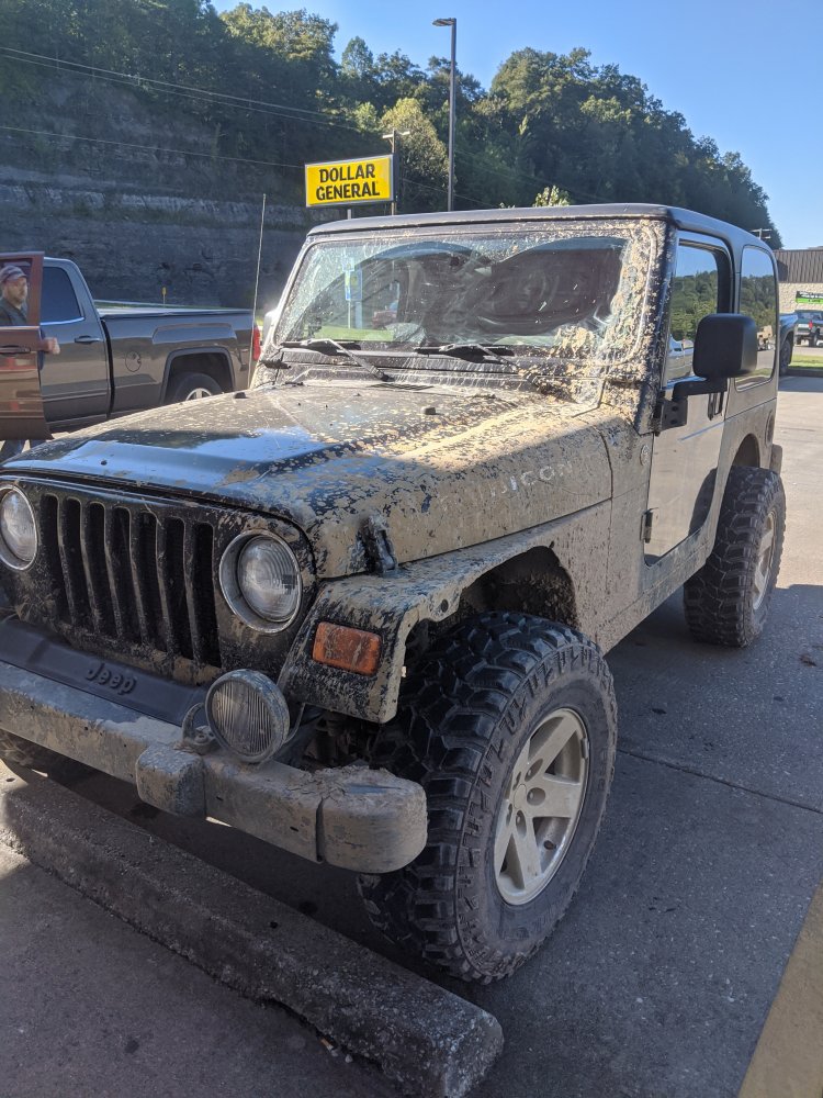

After that trip, I turned around and took it wheeling to Hollerwood park in Kentucky. It did great with the new set of Cooper STT pros, and it was a blast to have the top off of, minus all the mud.

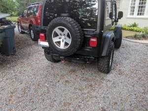

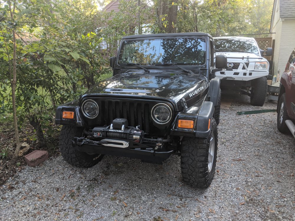

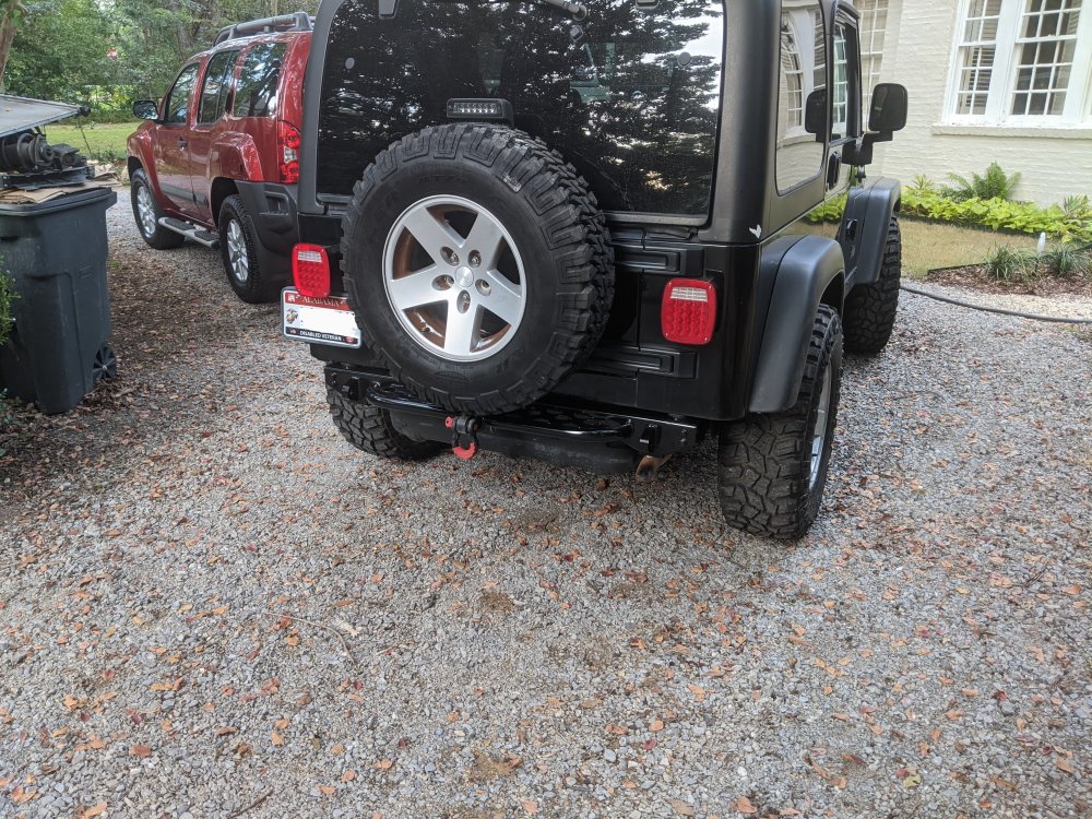

Also, I finally received the ruffstuff rear bumper and got it painted/installed. Just waiting on the front winch bumper so I can install it and the steering box skid.

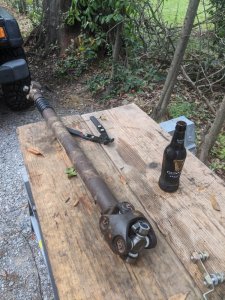

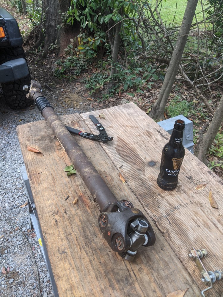

Tonight's project: installing my rebuilt front driveshaft. New u-joints, cardan yoke and ball, and replaced that split slip joint boot.

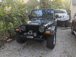

Finally received the Ruffstuff front bumper and installed the SB 10k. Looks pretty good, but I'll have to keep an eye on trees at the front fender as they're completely exposed now. After I do tube fenders it won't be an issue. Also installed the steering box skid.
