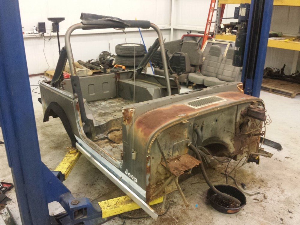

Basically, we are going to take this:
Which is a ragged out 1981 CJ7 body that the floor pans are rusted, damaged, tweaked, etc and go apeshit with it.

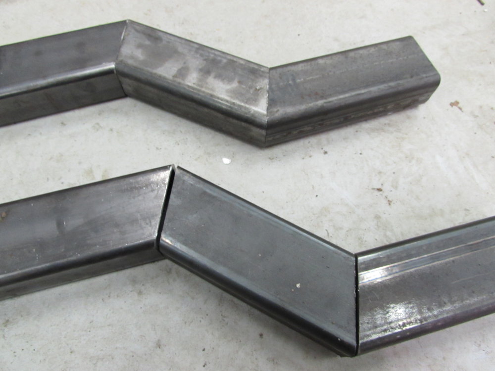

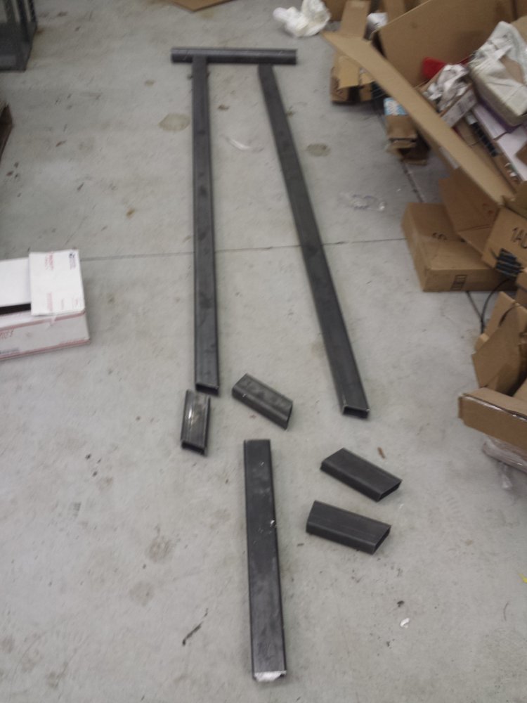

So the "frame" got here today. The pics I saw when I ordered looked like the side rails were welded, but of course I just got a pile of cut steel. No big deal, just a little extra work. I was planning on plating the joints anyway, so no huge deal. Just a little pissed that I could have saved money by just buying a couple of sticks of steel and doing it myself, but whatever.
Man, this frame kit is pretty crappy. I'd like to meet the asshat who cut this thing. One rail is flush cut and nicely done. The other is cut at a slight angle and won't sit flush. Right now it is 1/4" shorter overall, and once I true it up it'll be sitting at about 1/2" shorter.
Might do that. I'm going to take some measurements of the frame vs the body, we may need to lengthen that rear short section of rail anyway. If I end up having to modify it anyway, I'll just keep it and chalk it up to a "if you want it right, do it yourself" which I should have done to begin with.
Send it back and THEN do it yourself! Cutting steel isn't rocket science. I ain't saying anybody can do it, but it's obvious whoever was manning the saw that day couldn't!
I left some feedback for the place I got it from, since I bought it on eBay and it was kind of late when I got into it. Probably should have waited to call but I was kind of pissed. I left them neutral feedback, not even negative. My feedback said "Kickups are NOT welded like pics look like, cuts kind of rough". They responded "It is a kit U WELDED IT not me, not my fault if you can't weld."
:lol: Seriously. Good business manners there.
Really just dumb on my part. I was trying to save some time and measuring. Very easily could have done it myself. Lesson learned.

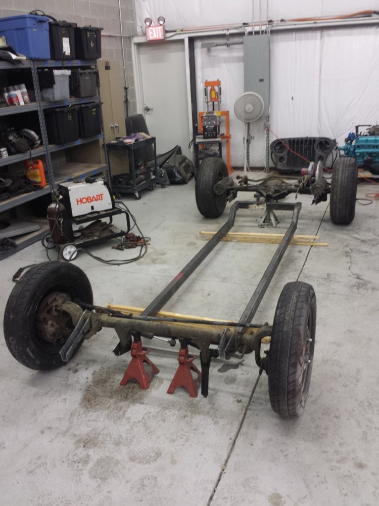

OK, so got a bunch of work done tonight on this thing. The frame is a total disaster. If anyone wants to buy a T-bucet frame, do nto buy it from Ron Pope Motorsports. Not only is the guy a complete dick, but his kit is crap. None of the cuts were square so it took me forever to get the rails straight and matching. Then the front and rear crossmembers are not the correct widths, the front is like an inch too short and the rear is about 2" too wide. This was a "ready to weld" kit. Seriously, if this is your business how hard is it to make a couple cuts straight?

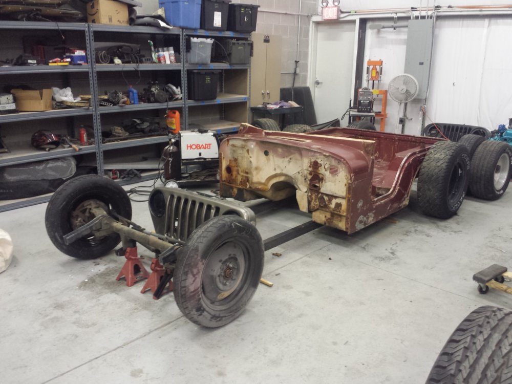

Anyway, realized I am going to need to rework the rear of the frame anyway. Gound to need to kick it up a lot more to get the Jeep as low as we want to. We're going to order a stick of 2x3 this week and rework some things next week. I also think I figured out the steering, but we need to look at it a little more. Since we are running a 2wd front axle with all new brackets I rotated it around and am going to just swap calipers left to right. That puts the steering behind the axle instead of in front of it. We'll need to rework a few things but I think we can make this work.
Mockup pic.
Got the body aid out on the frame. We are going to have to cut out the floor in the back and raise it way up to clear the frame once we kick it up. We also realized the ZJ axle is not going to work at all. Going to try and find a Ford truck axle with 5x5.5 and at least 64" WMS to get the fires outside and make it sit like we have it mocked up.
