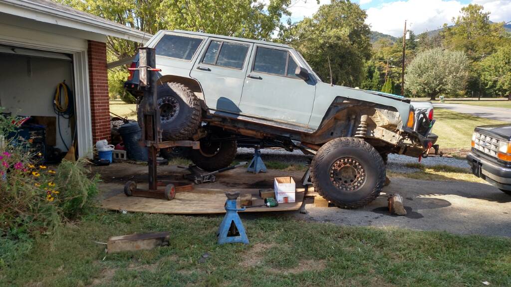

finally got the driver seat all finished up. Guess I'm ready for the flats not going to have time to do passenger until after. Like always day late and a dollar short
Had a blast at the flats Saturday. Beat on it hard. Came up the right side of easy street no problem, and came up zig zag fairly easy for how wet it was. Felt good to watch a group of "big" buggies struggle up it and one not making it and another not trying it. Later on in the day I also got called a shit box of a Cherokee. Then watched them winch what I just drove up. Was a little put off by it but then realized it really is a shit box nothing on it is done "right or the professional way" hell I can barely weld and I've done most of the welding on it and the welds do look like hell, but I gotta learn some how.

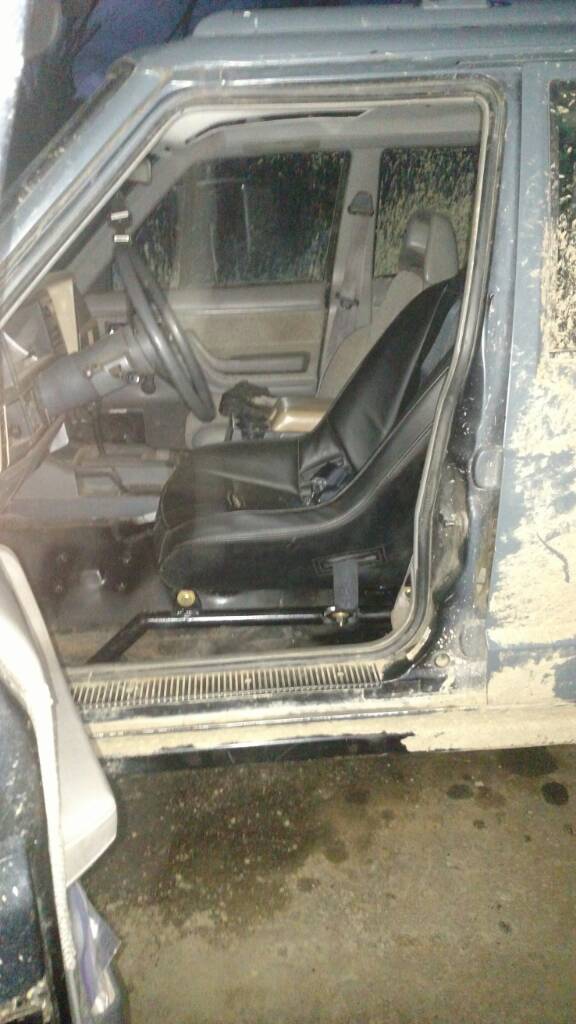

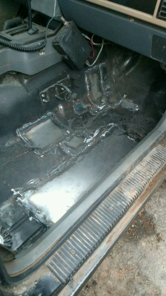

Any ways only damage was to passenger seat surprise I broke the floor mounts again so I yanked it and was half way surprised to see how bad the floor was rotted so I fixed it and started on the seat mount.
probably should have replaced the whole pan.

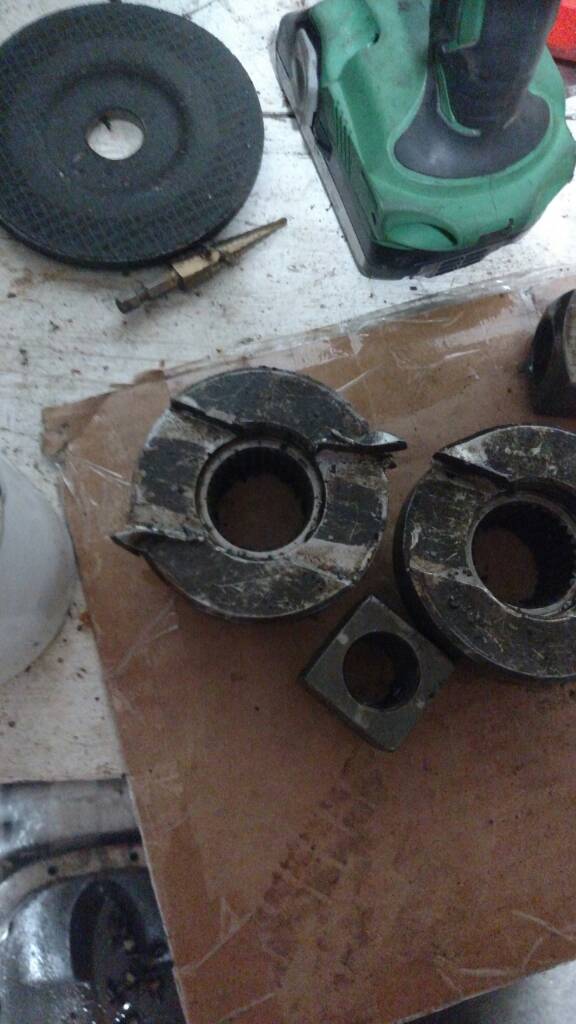

Plan on clicking my 231 transfer case any common problems to look out for. Already have an aftermarket transfer case shifter.

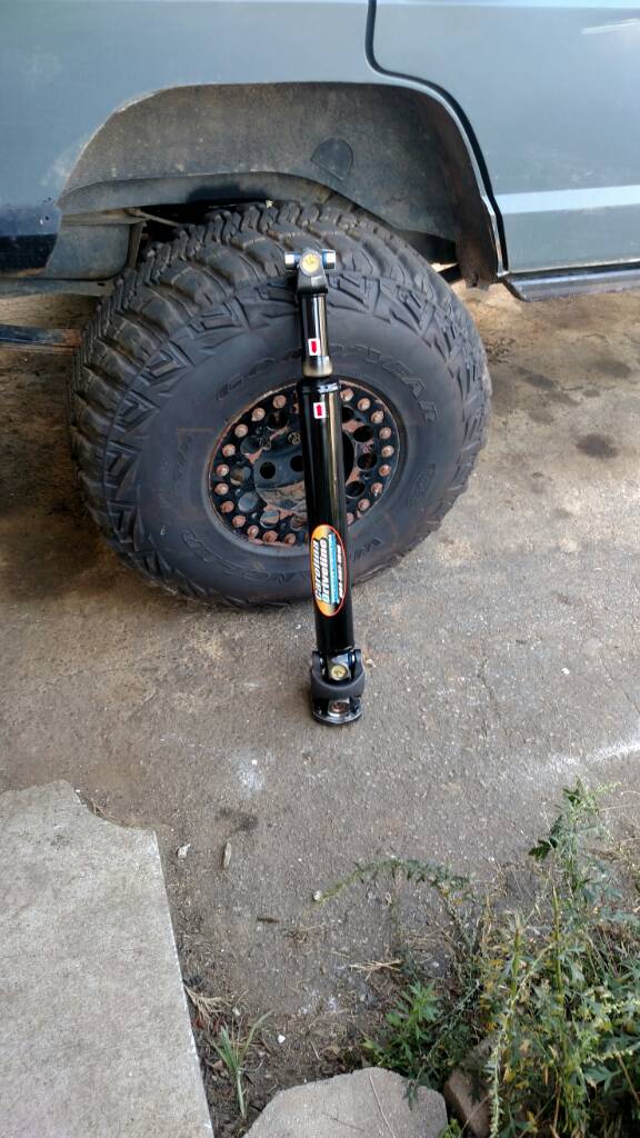

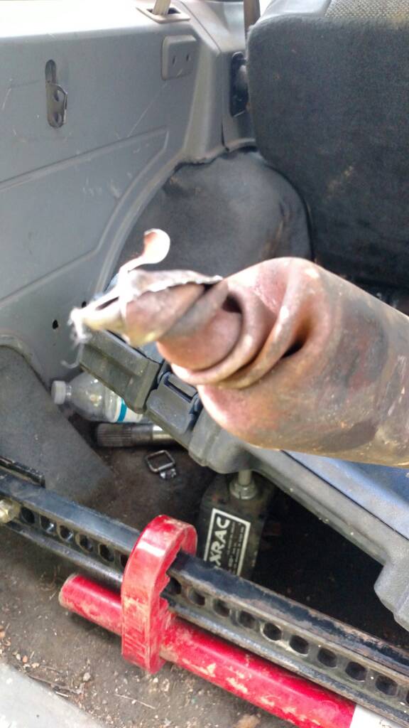

So put off doing work on this for a while but I spun a driveshaft in half at the shop. Came home and got to work.

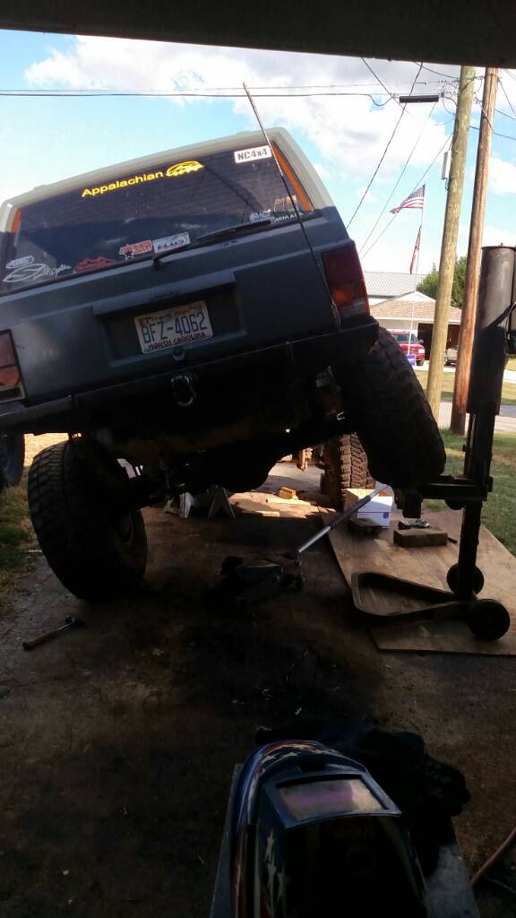

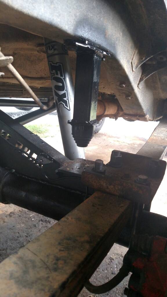

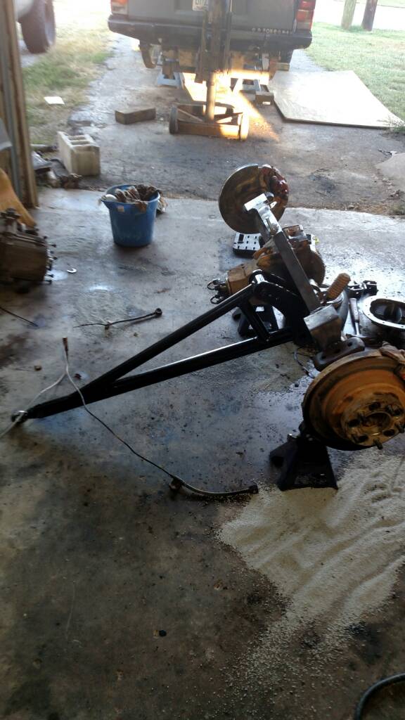

I made a new cross member and installed my 231 with a hack and tap on it, also added a clocking ring to flatten out the underside. Didn't work out exactly how I wanted but will work. I also took the axle out to put new axle seals in it and install a truss. I've also added an anti wrap bar. Hopefully that will help with the axle roll. Waiting on a new rear driveshaft to show up. Have to reinstall the axle and weld on some mounts for the fox shocks I picked up. If everything goes right I'll be at the shop for the toy ride.

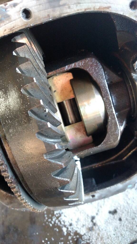

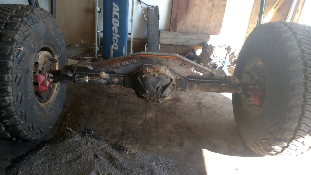

When I pulled the cover saw my mini spool was trash... so new one went in and I'm gonna give it hell and see what happens.
Driveshaft showed up and found out my shocks are to long so will be changing them out when money allows for some new ones.
Went wheeling in windrock.... Over headed my transmission with a kinked cooler line.... Figured that out and beat on it all day.
Finished off my steering box and possibly the pump and figured out I gotta redo my cross member

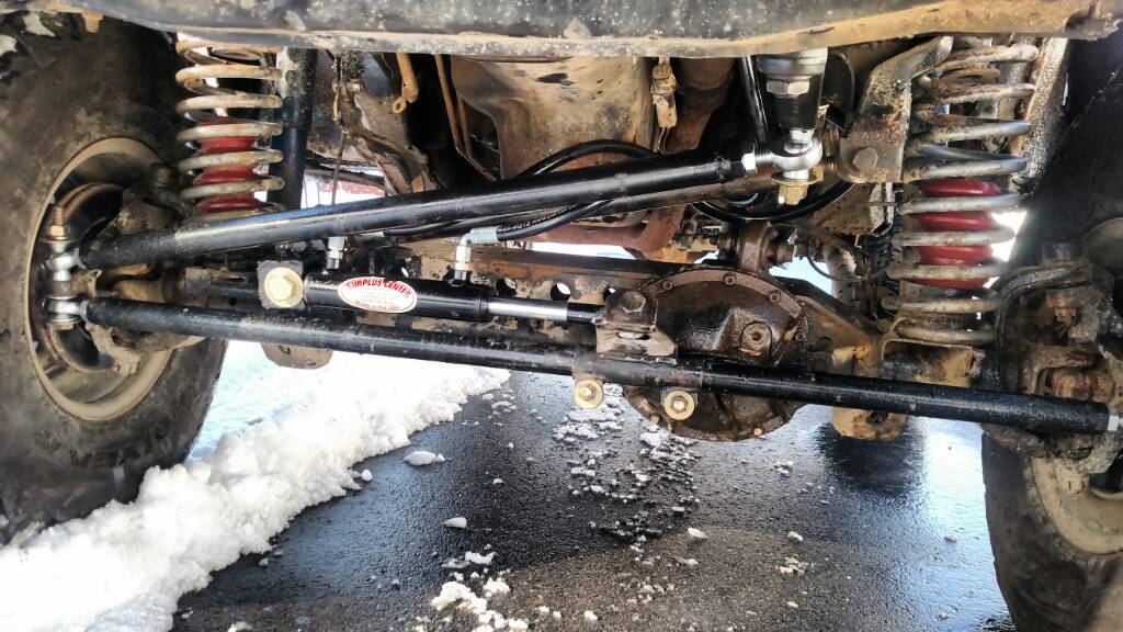

Started my new steering and hydro assist and got lazy and finished it the morning the last time it snowed when it was in the teens at my house. Took it to the shop and tried it out and it worked pretty good. Had some clearance issues but I think some offset hiems from Barnes will fix them. They are sitting on the table so probably work on them tomorrow.
