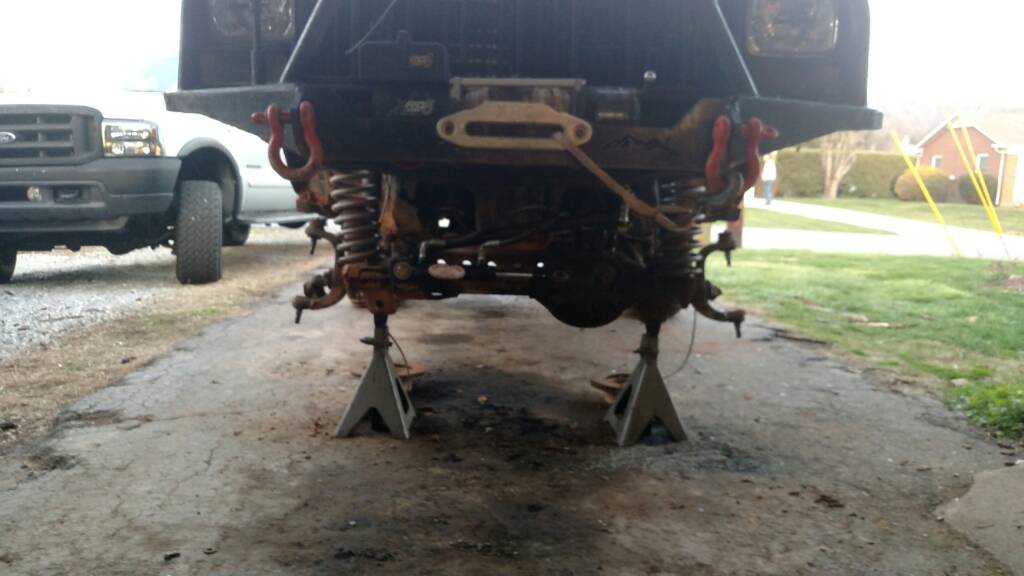

Pulled the front apart for some r&r

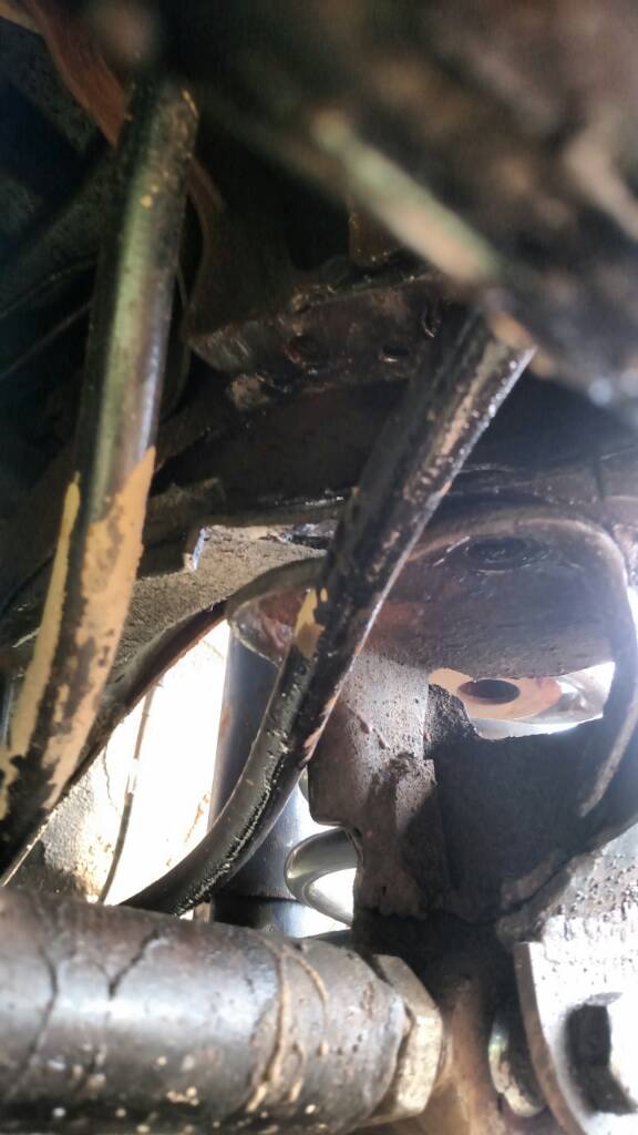

Got some new knuckles, inner c trusses and found out I'm getting new ball joints as well.
Well shit.... Good thing it broke on the last trail of the day... I also lost oil pressure and still seems like it's not keeping pressure where it should be

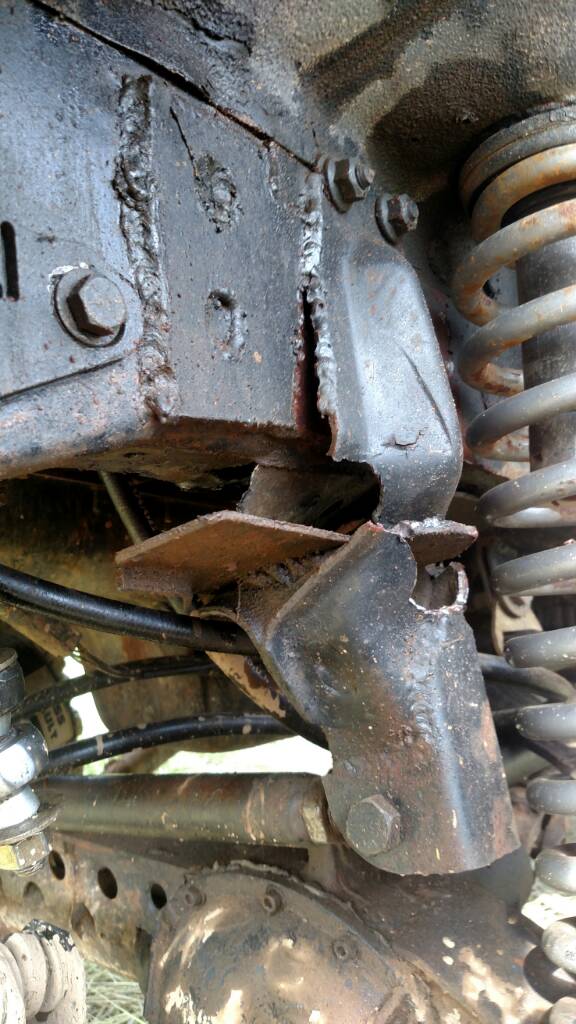

Somebody downhill mig welded that T bar bracket.
There you go, learned something else! Cut that stock junker off, plate the crap out of it and use the entire Barnes bracket!
That is the basic plan... Barnes has one for a TJ that raps both sides and bottom of frame and ties it all in. Think the xj frame is to wide so going to copy it but make it wide enough for the xj.

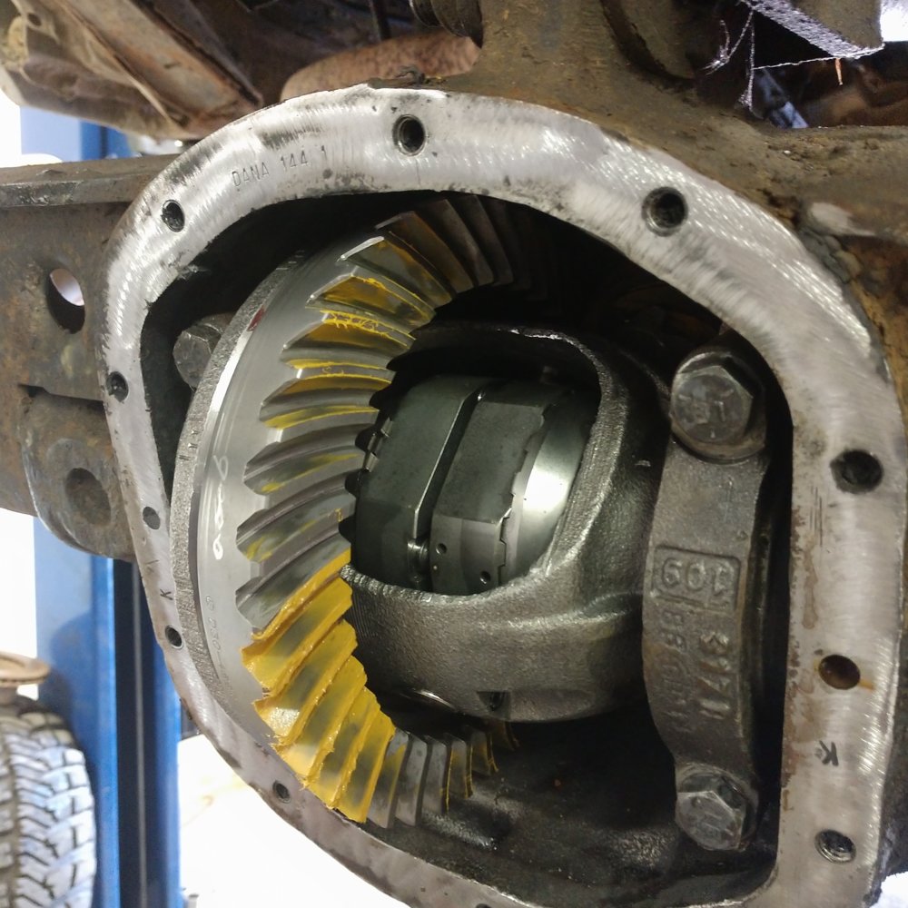

I'll update for @Loganwayne cause he's too much of a loser to do so.
At our Appalachian 4x4 trip to Harlan in August, he grenaded his front ring and pinion. I had the privilege of seeing to it that it didn't happen again.
I took it apart and made some measurements. The measured pinion depth was way, way off. 14 thousandths off. There was zero carrier or pinion preload and the pinion was loose in the housing.
I set it up to spec, replaced the ring and pinion and even added a Yukon ubolt yoke for him.
He's ready to rock and roll again.
