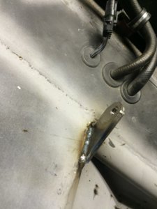

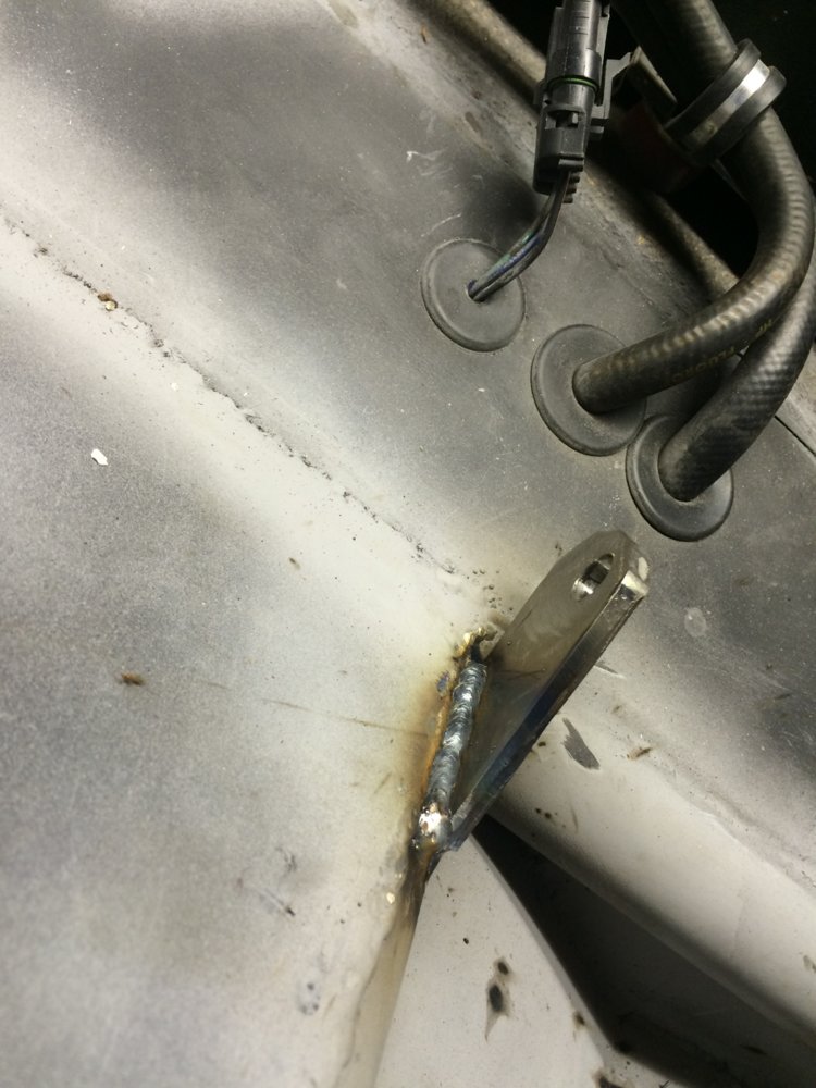

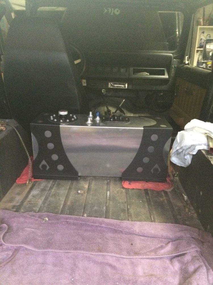

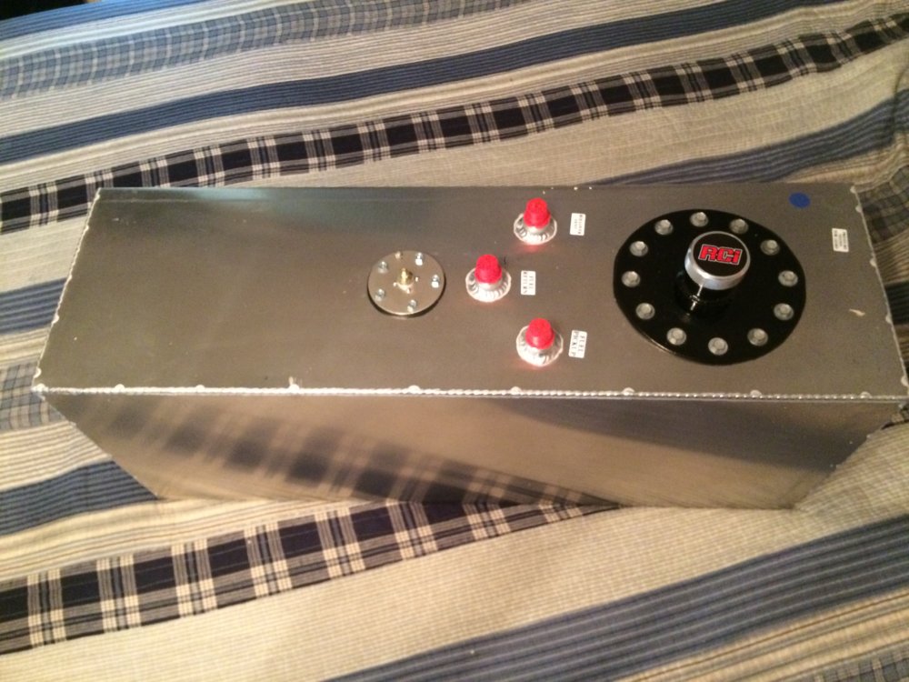

Fuel cell should be here Wednesday!

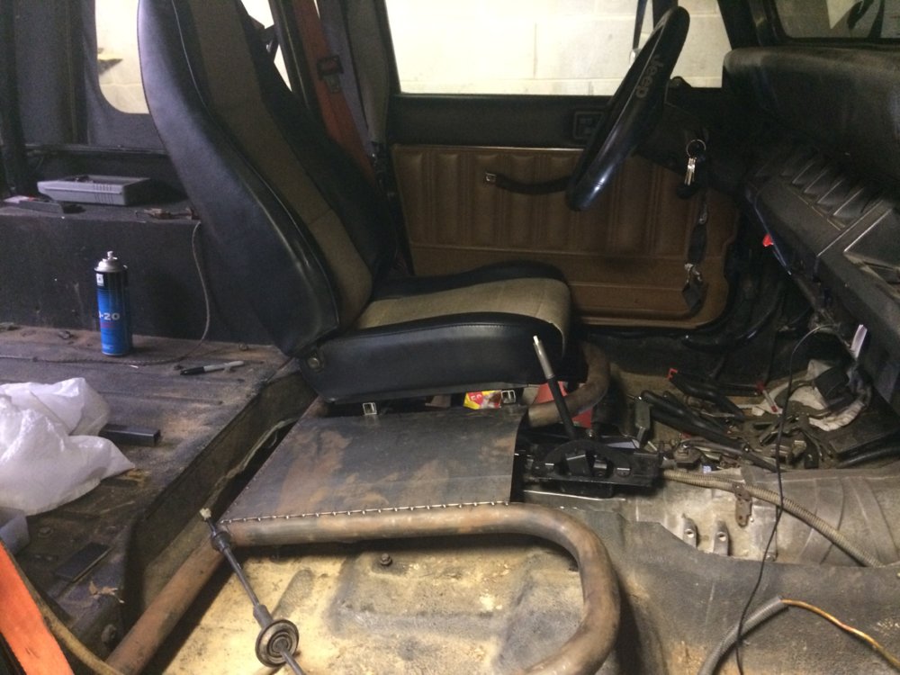

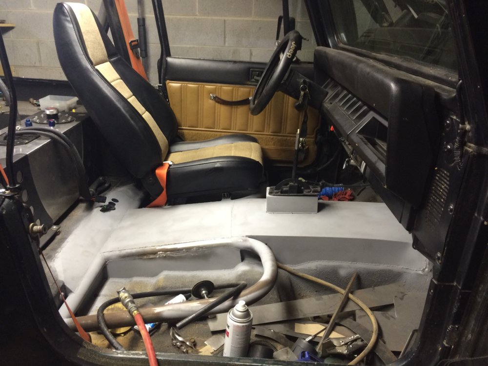

got a little bit done today, hopefully will get the driver seat mounted tomorrow and finish plating the frame.

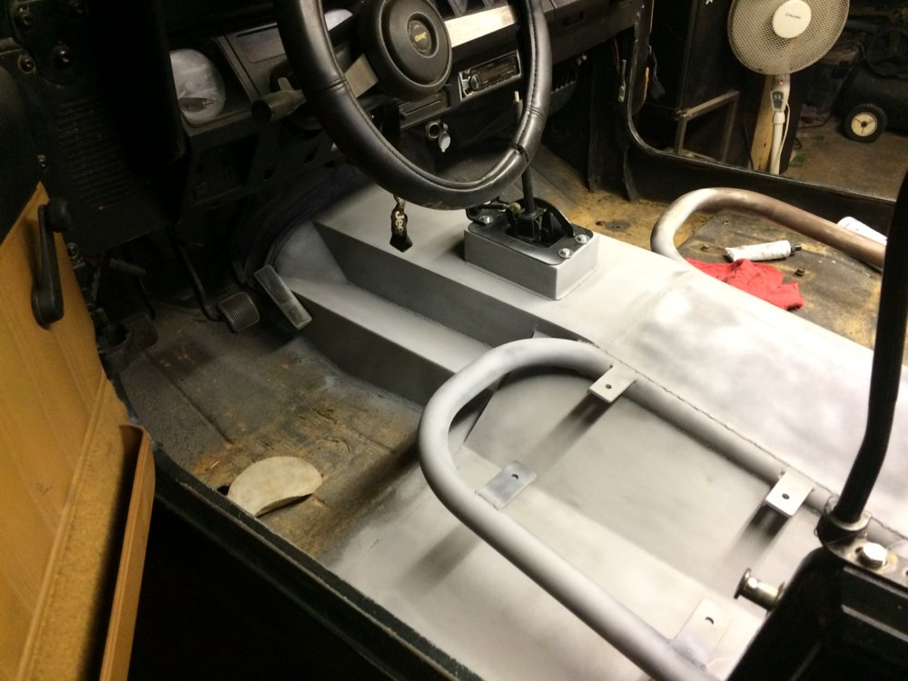

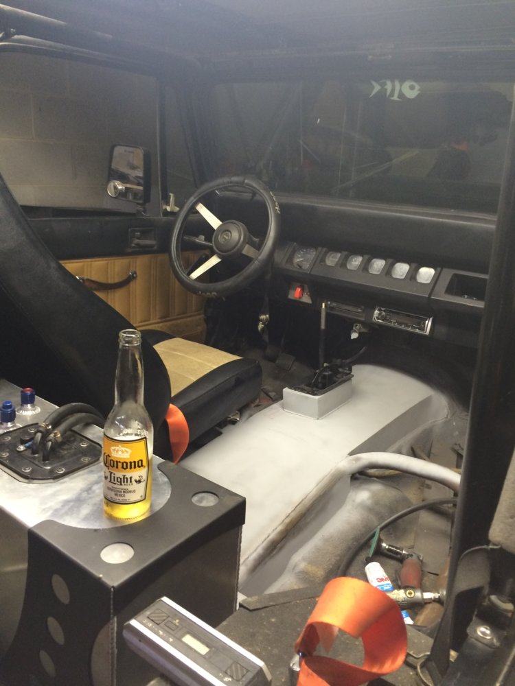

Drove it around the yard for the first time today was awesome for it to finally move under its own power! Eventually there is going to be a full console built over the new trans tunnel and shifter. However once I bleed the brakes and all I'll be able to drive it on the road.
One main thing I learned from this swap is to never v8 swap your daily driver... At least its almost finished and I can get the ol' Jeep back on the road.

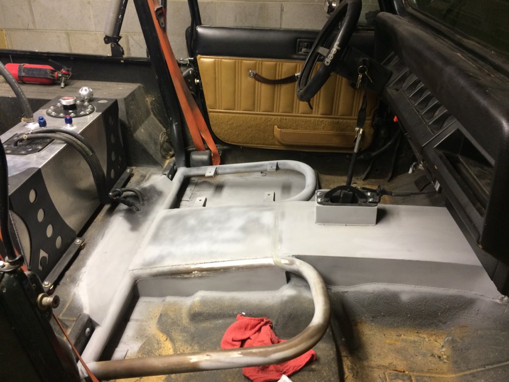

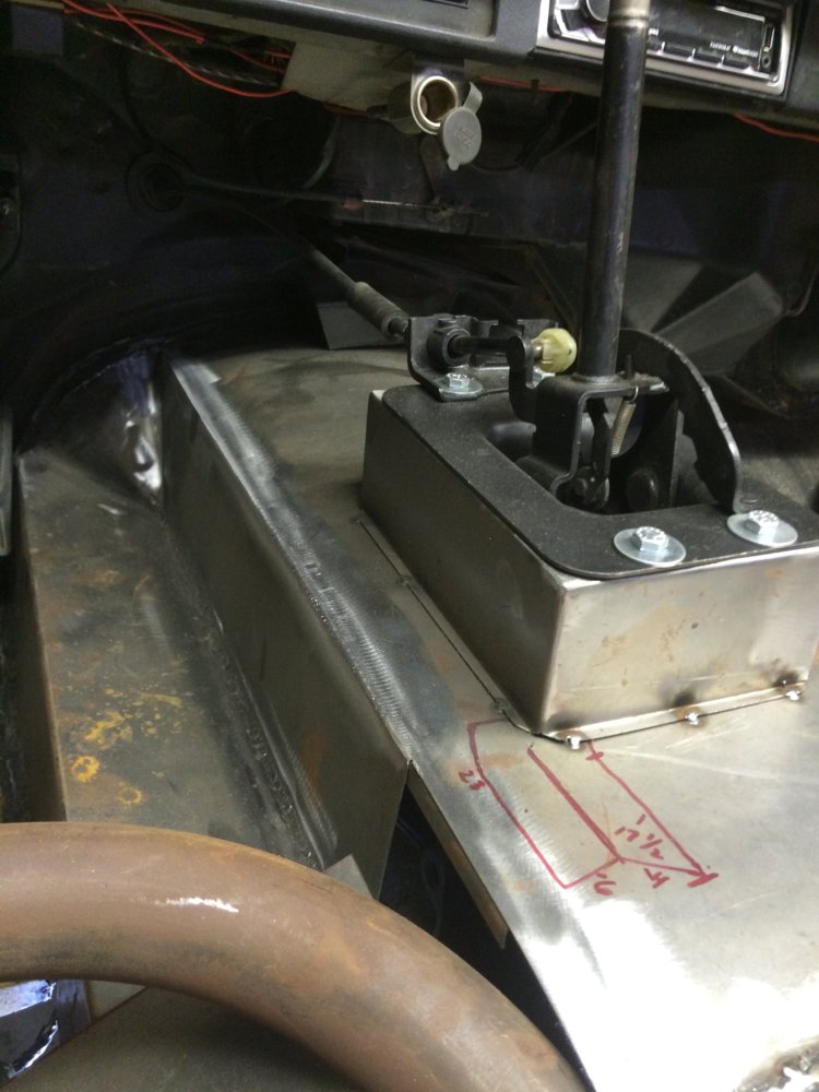

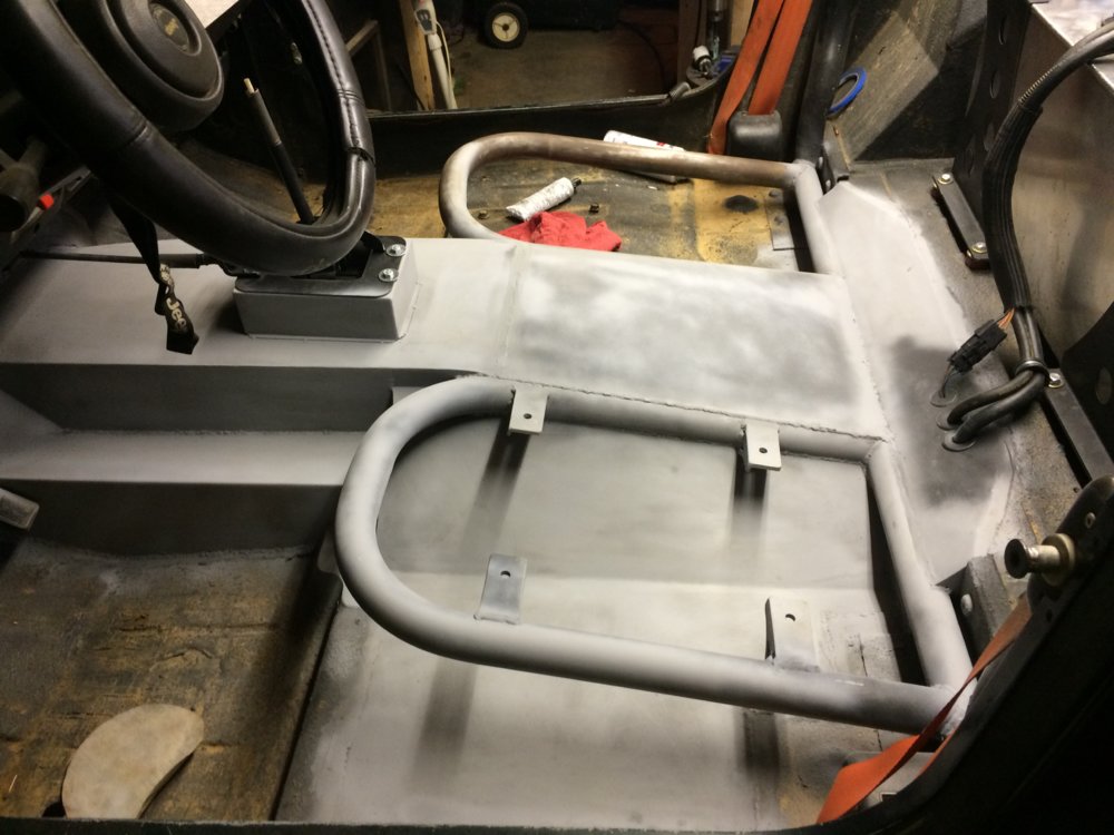

Little bit of seam sealer and maybe some more grinding and the floor will be mostly finished. Still gotta make seat belt tabs and passenger side seat mounts. Not sure if I already said this but there will eventually be a full console type thing over the shifter and all the way back closer towards the fuel cell.

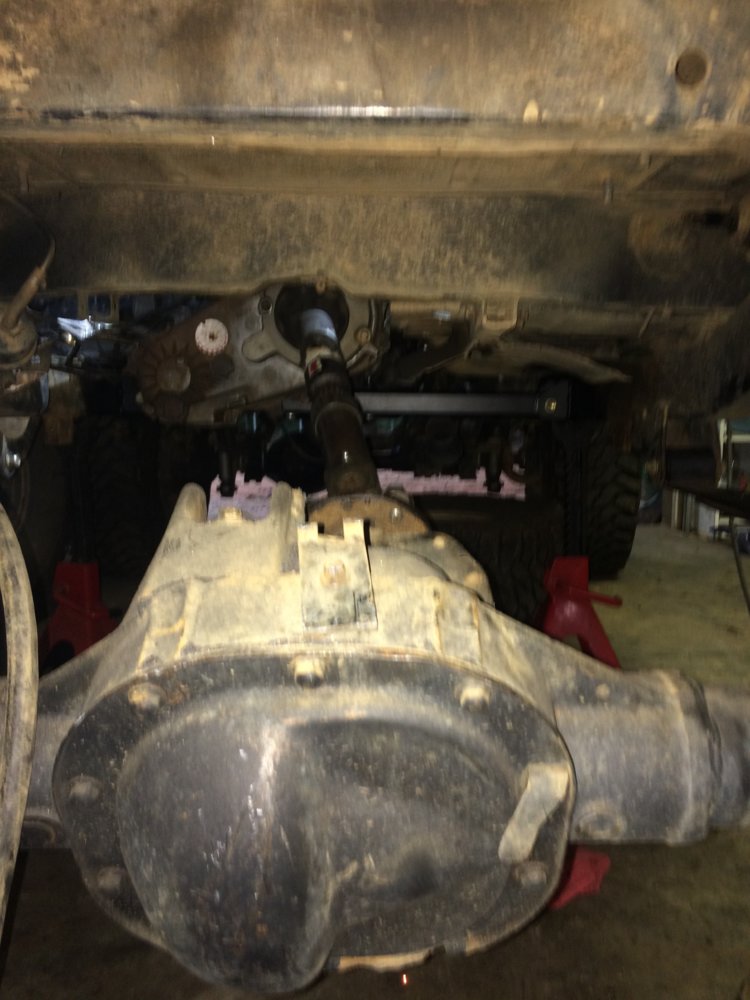

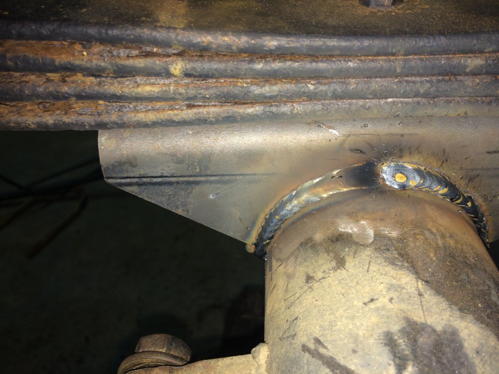

Also got the traction bar built and mounted today, took it for a spin around the yard it's got a lot of power. I would've taken a video but it was dark out.

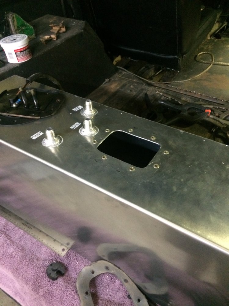

At certain RPMs the artec fuel cell mount on the fuel cell vibrates really bad so I'm going to add some type of rubber or foam between the two to deaden the sound.

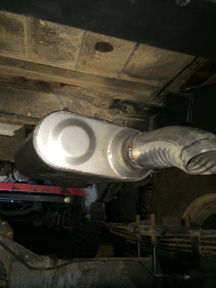

This is the only pic I took today.. Flowmaster muffler was given to me so I'm not too sure what kind it is specifically but it sounds good.

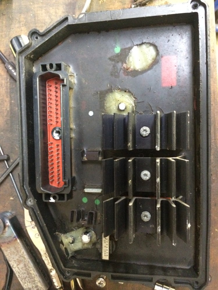

Took it to Uwharrie Friday afternoon hit a few trails and headed home. The Jeep did alright. Still having a big problem with it stalling out. Most of the time when I start it I have to give it some gas otherwise it'll start then just stall out. It'll also stall out sometimes when coming to a stop. It happens more often when I stop really quick after giving it lots of throttle. I changed the IAC it didn't help. Also tried removing the Air intake I had because I thought it may have not been getting enough air but neither helped.

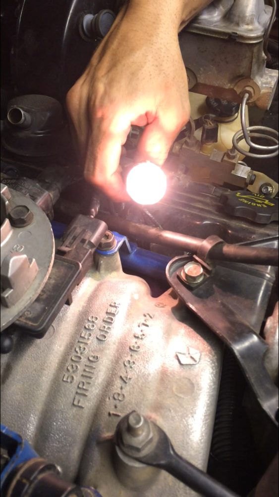

After messing with it a lot more this past weekend we found out that the computer was messed up. WE hooked up noid lights and the first injector wire was all over the place for one second it would have constant power coming to it, then it would cut off, then occasionally it would look normal. After looking through the whole wiring harness again I finally figured out if you start tapping the PCM it would start messing up.
Opened up the old PCM someone has messed with it before...
Went to the Junkyard the next day bought a new PCM hooked it up and everything seemed perfectly fine besides it still running very rich for about 30 minutes. Then on the way to Charlotte it started to misfire really bad again. So I changed the spark plugs last night and it hasn't misfired anymore since then however it is still running very rich and smoking out then exhaust a little bit when driving. Also when ever I stomp the gas while driving a small cloud of black smoke comes out... One of the only things I haven't changed on this engine now is the injectors, I know they're all working and sound fairly normal when using a stethoscope.

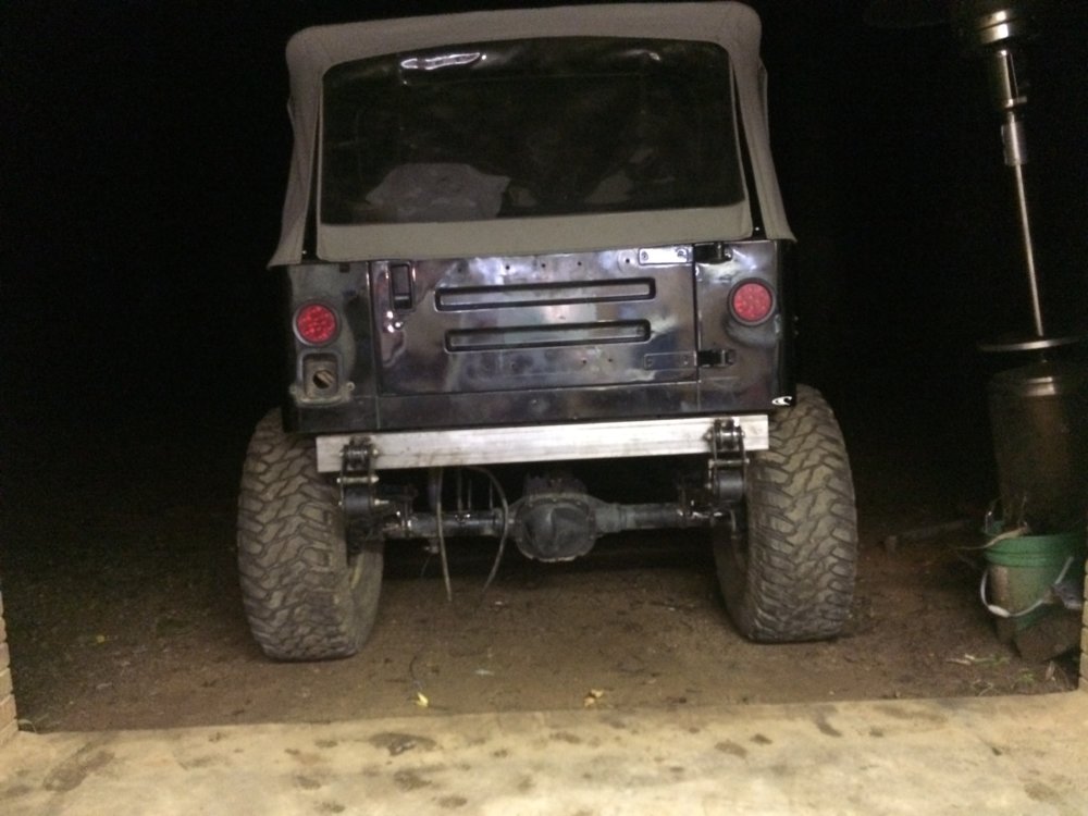

No real updates just a few pics I took over Thanksgiving break.
Still need to get build some rear corner guards to make the rear fender well look better. I also kind of miss the stock front fenders, regret cutting them now even though they were dented to shit.
Or just through some tons, 40s, and comp cut the rear???
