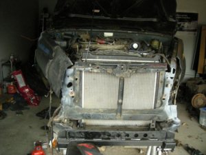

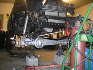

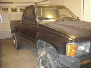

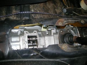

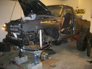

HERE ARE SOME PICS ALONG THE WAY.FROM FACTORY TO NOW.TAPPERED FRONT END AND THE DUAL CASES. MARLIN 23 SPLINE.WITH AN V6 TO 4CYL ADAPTER. BUD BUILT CROSS MEMBER AND SOON TO COME BEARD BUILT SHAFTS AND MUD PRO BEAD LOCKS.FOLLOWED BY AN EXO. AS OF NOW SOLID AXLE SWAP ALL PRO SPRINGS. LONG FIELD AXLES. SPOOL REAR AND LOCK RIGHT FRONT 38 TSL. MORE PICS TO COME.

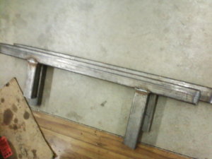

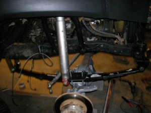

well im going up to budbuilt to get my cross member friday so the duals will be done then. i think im getting my rear drive shaft made this weekend and mud said he would have the beadlocks done prob friday. so as soon as my front leafs get here i can install that and make the front drive shaft. i ordered marlin springs but they are back ordered so i have allpro springs on there way so hopefully some time next week or weekend.
allpro springs are prone to bend easily
well i would like to have marlins but the 4" were on a 4 week back order and i was not waiting and im NOT going to run trail gear so allpro was the next best thing.

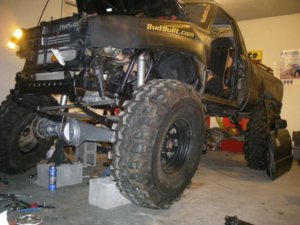

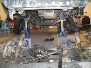

more pics

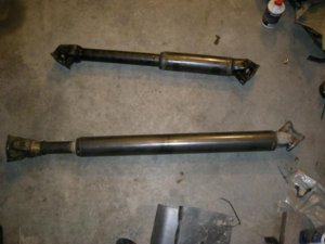

the beard built shafts with a stock rear slip yoke and a 10" long spline front. beefy. pics of duals installed and another pic of the truck.

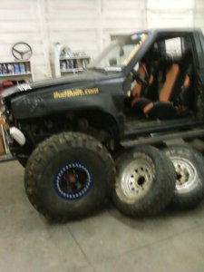

close to being done

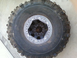

just fixing a few loose ends and getting ready for the front bumper,rock sliders, and exo. here are up to date pics. no nothing is broke tires are just chillin on the wheel studs just so i could take the pic getting ready to tear them down and install the bead locks.
Glad to see that you're making so much progress. I rocked those same sweet jackstands till a few months ago when I bought big boy ones.:Rockon: Why don't you come out here sometime and check my shit out.

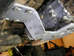

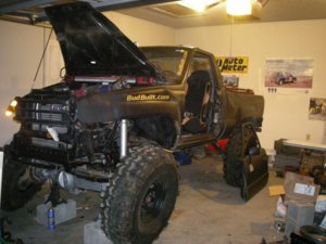

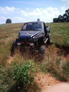

SOME MORE PICS

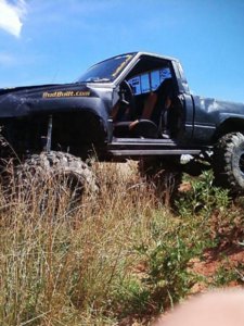

ILL HAVE THE EXO CAGE PICS UP SOON I HOPE. YES ANDREW ITS GREAT TO FINALLY AIR DOWN ALOT MORE CONTROL AND NOT ALOT OF BOUNCING. THE DUAL CASES HELP THOUGH. IM SURE U RECOGNIZE THE DITCH.AND YES THE REST OF THE BOLTS SUCKED TO TIGHTEN. I GOT ONE RING TO TIGHT BUT IT SEALS THATS ALL THAT MATTERS.
Nice rig! Can you turn the CAPS LOCK off? My ears are ringing.
No biggie, is it ready to go?
i hope so i fixed one oil leak but i think i have another starting i hate the 3L v6 but my exo will be done tomorrow or maybe thurs day. im going to take it to tenn this weekend. there are a few of us going up.
