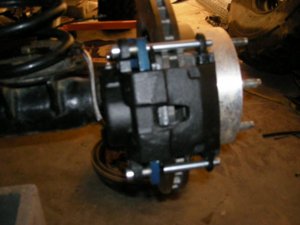

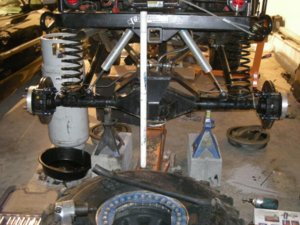

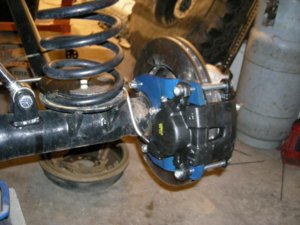

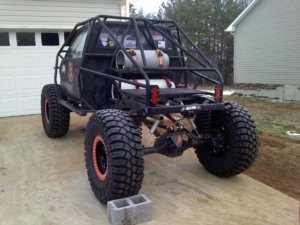

rear disc brakes
finally put the rear disc brakes on.and all for less than $200
aslong as i dont have to change anything else.

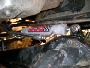

psc

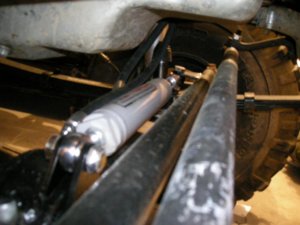

i got my psc hydro ast ram and lines from brandon at rides now

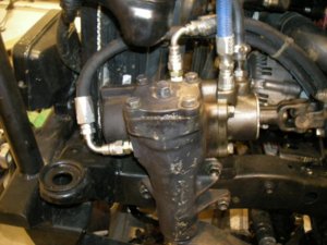

just waiting on my psc pump to get here.also upgraded the tie rod to 1.5 250wall tubing.
Well I drilled out the restrictor and it works but after u run it for awhile it starts to get very hot and gets hard to steer. (yes I'm already running a cooler). Instead of burning the pump up and it leaving me stranded in the woods I would rather just go ahead and do it right the first time.
