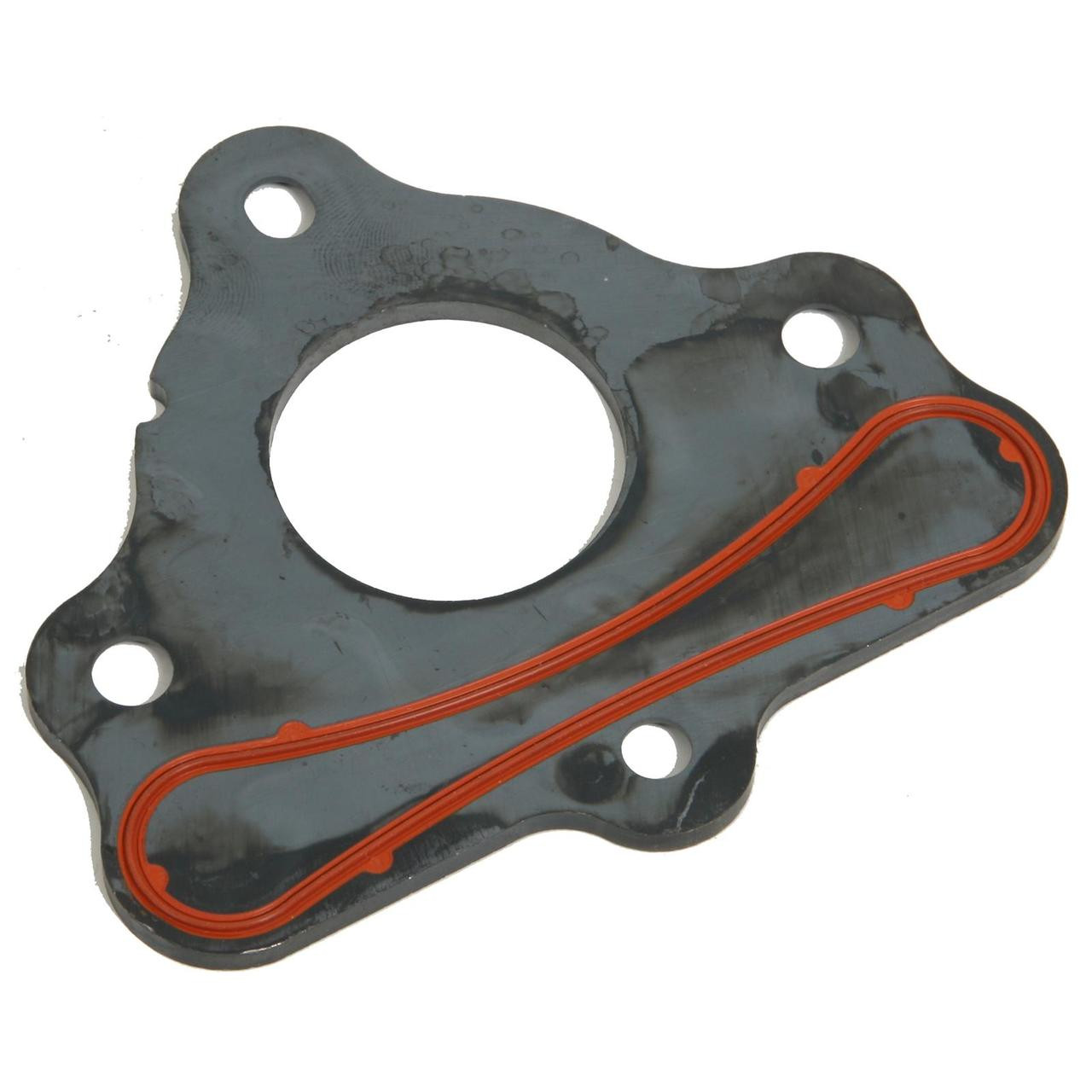

I’ve read a lot about the cam retainer plate having a seal that fails. It’s a cheap part and should be replaced if you have the motor out. Not speaking from my experience, but its common failure on track raced motors. https://cdn10.bigcommerce.com/s-vyv.../12589016__29259.1406319798.1280.1280.jpg?c=2
