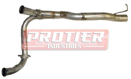

Y pipes.....

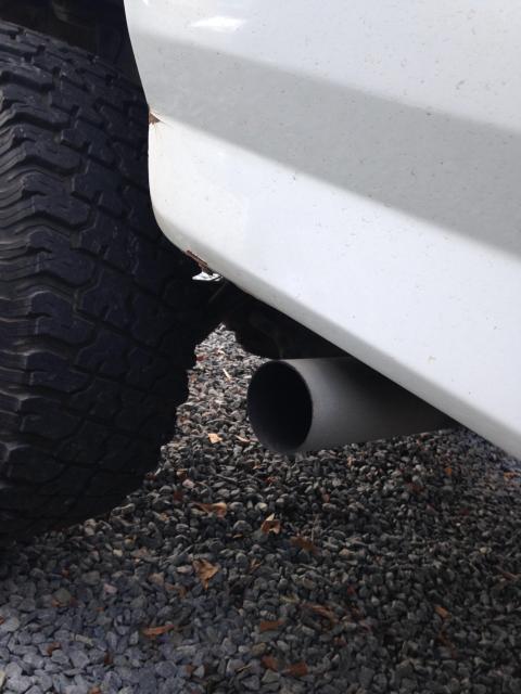

My exhaust shop wanted to do dual exhaust but I believe that on most engines large single exhaust makes more torque so I needed a new Y pipe and I wanted stainless like the factory one. I found what I needed on ebay. I got it on the way and also got a high flow Magnaflow 3" cat on the way as well.
The Y pipe install happened easily thanks to the truck being so high off the ground. I used a little Ultra copper on the manifold/pipe joint. I started the truck up, sounded like thunder. The neighbors were not impressed but now I was ready for some exhaust shop goodness. I went to "The Muffler Shop" in Selma NC and Wilbert Shirley who has been in business 25+ years was happy to do the work for me.
After talking it over, we determined that people my age do not appreciate cab drone and cop calling. But, I do like a little growl when I stand on the skinny pedal. Flowmasters need not apply. He recommended a Magnaflow Muffler. I was hesitant, this is a straight though muffler. He assured me it would be quiet at cruise and idle but sound snarly when racing Hondas from stoplights. He installed my cat and muffler and I decided to turn the exhaust out in front of the rear tire instead of going over the axle. Nothing worse than exhaust in your face when trying to hook up a trailer. The work was complete and Wilbert offered me a love it or change it guarantee.
Well, I am happy to report that it is perfect. It is as quiet as a stock muffler at hwy speeds and just barely rumbles at idle if you are standing outside. It opens up and sounds pretty when you stand on it and chicks (my wife of 21 years) dig it.

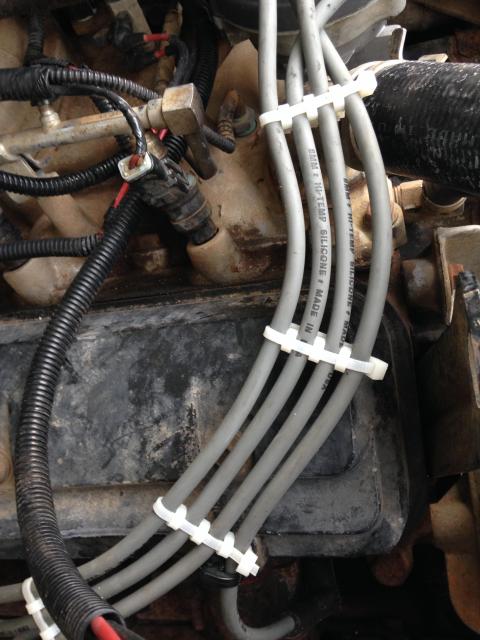

I bought new plug wires, plugs and 3 miles of vacuum hose. I went to work on the vacuum lines as the old plastic stuff was rotten and would break just by handling them. Easy enough to run new lines and eliminate some leaks. I did the tune up and considering the previous owner had bought and installed a new distributor and ignition controller in an attempt to fix the miss o_O the ignition should be good now. I spent a lot of time routing the wires and making nice looms from zip ties. I saw this trick years ago in Hot Rod magazine and I still use it today. You wrap one tie around the wires and then put a tie between each wire and tighten it all down evenly.

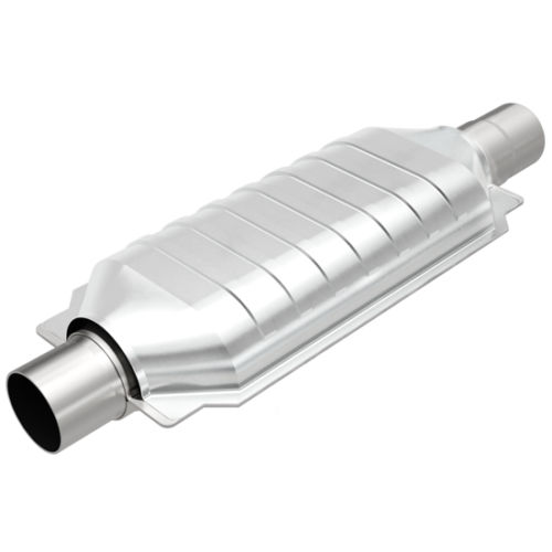

Why go back with a Cat after deleting the other emission equipment?
Just a NC inspection deal?
No, I cannot stand the smell of raw exhaust. It gets all in your clothes and gives me a headache. A good cat burns this stuff and cleans up the exhaust so it has no smell. You will get a little pungent odor when cold for a few seconds until it lights off but unless you are standing beside the outlet it isn't an issue. I actually am a fan of catalysts, a good high flow one has no negative impact on performance and to me the plusses are worth the $100 ebay admission price.

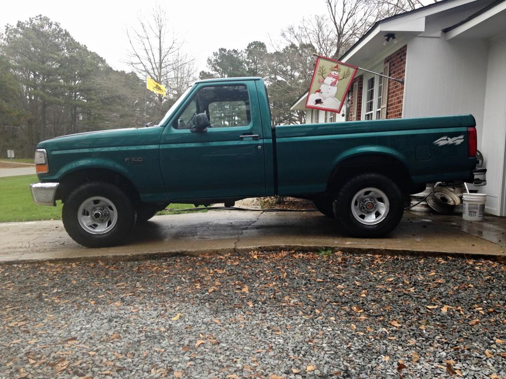

During all of this, we bought my daughter a truck. We found her a very clean 96 F150 4x4. It's a short bed regular cab with a 300 six and 5 speed. It had a painted front bumper and black grill, we decided to take the chrome bumper from my truck and install it on the F150. My daughter's boyfriend had gotten her a chrome grill too so we started swapping parts. I also found her a really nice chrome rear bumper. I painted the wheels and put on a set of used 31s. Her truck is really nice. We plan to put on some chrome mirrors and wheel well trim but other than that it looks fantastic. She wants a 2" front level for now and maybe some 33s. She named it Lafawnduh.....
So now I had nice straight front and rear bumpers to paint to match my grill on the F350.

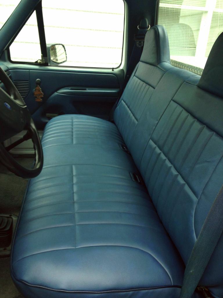

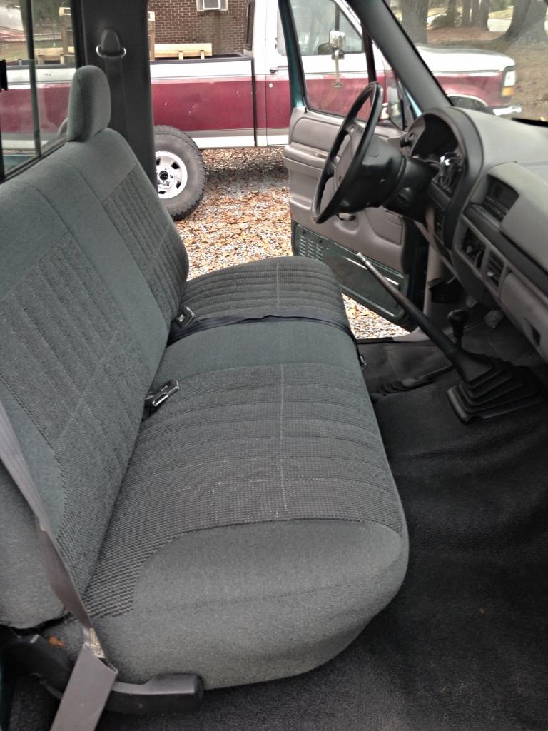

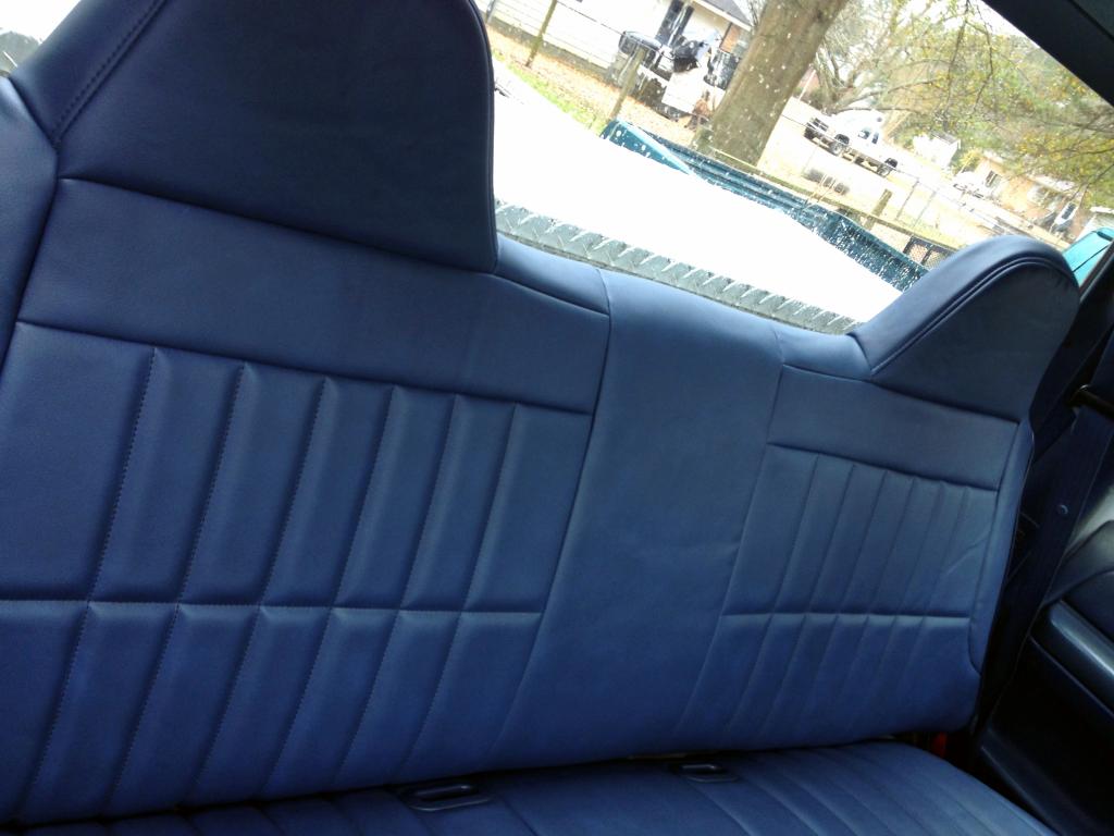

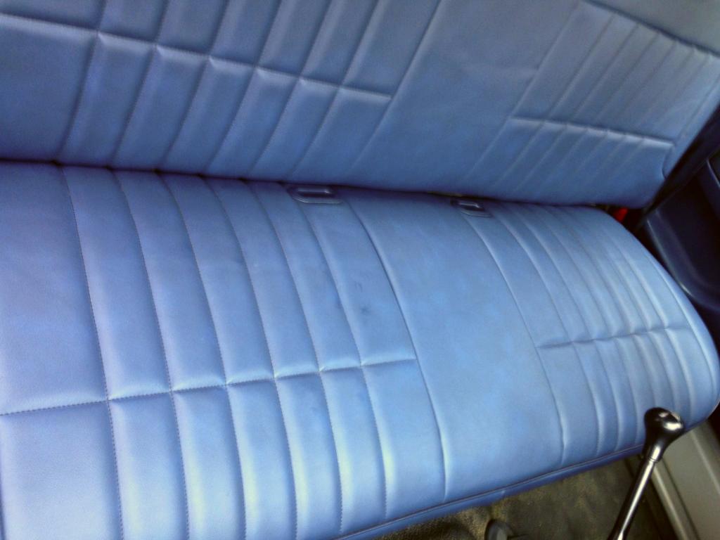

We took the seat from our "parts truck", a 92 F150 4x4, which was very nice with no tears and cleaned it with purple power and the pressure washer. It came perfectly clean. We pressure washed the seat belts and cleaned up her interior. It looks fantastic.
Now I had a good high back bench from Lafawnduh to have covered for my F350. The F350 had a dodge split bench installed. This is a popular swap in these trucks but I wanted the factory style seat. I took the bench from Lafawnduh to the upholstery shop, Glen's Seat and Top here in Smithfield. I wanted vinyl and they recommended a heavy duty material called Endurex. They ordered it in the right color and I thought I was close to getting the truck like I wanted it.

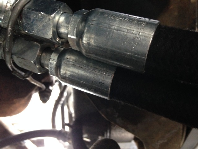

I decided that I wanted to get a new radiator rather than getting tanks put on the old one. It just makes no sense to fix one when a brand new one is $139. I found a coupon code for Advance Auto which saved me 35% by paying online and picking up in the store. I also decided to eliminate the factory oil cooler. These coolers are known to fail and put a few gallons of coolant in your oil. A ruined engine would make me want to kill an engineer so I researched the options. Most folks remove the cooler and install a remote filter kit as the cross member makes it impossible to mount a filter directly on the block and a remote filter will keep oil from running all over the frame when changing the oil.

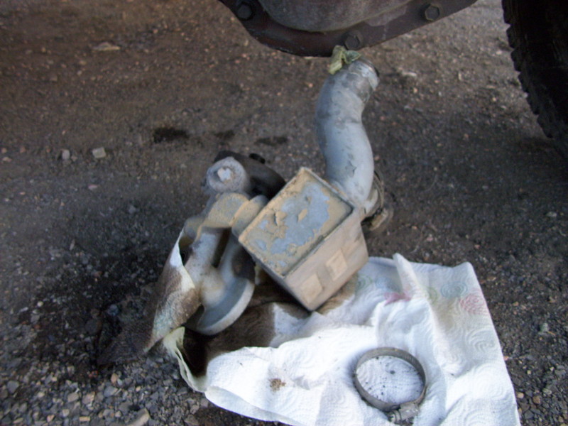

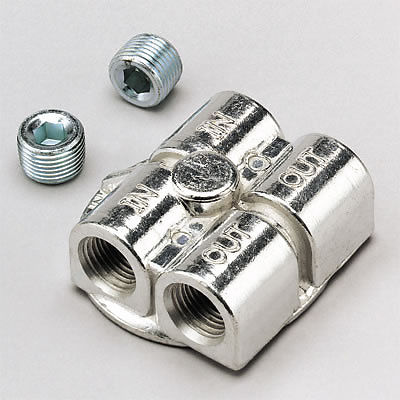

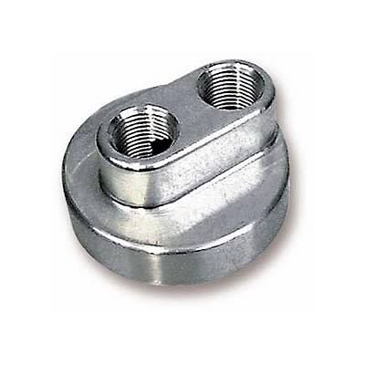

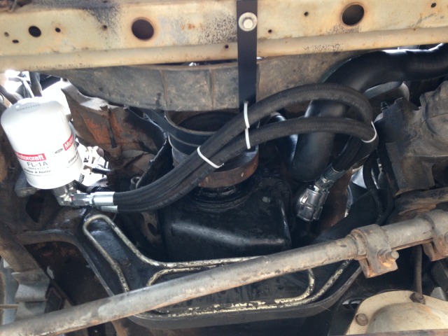

The factory cooler which connects to the lower radiator hose and has the oil from the filter running through it.
This turned into the biggest project yet with the truck. I ordered a new radiator, all new gates hoses, new belts and a 180* Tstat. I ordered a oil filter relocation adapter for the engine block and a remote filter mount. I planned to use custom hydraulic hoses to connect the two.

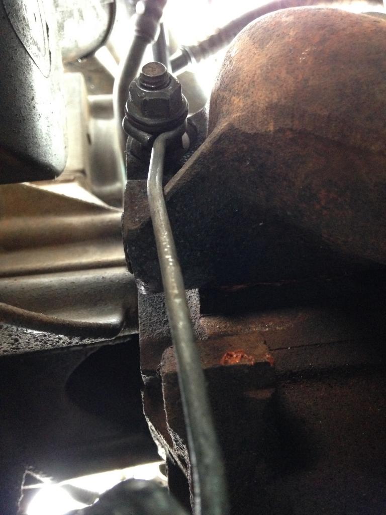

Problem #1 turned out to be that the straight out block adapter did not leave enough room to install JIC 45* adapters for the hoses.
So I ordered a 90* adapter and it allowed plenty of room.
I put in all the new parts. I found that the heater hoses were original Ford as well as the lower hoses that connected to the oil cooler! I went to the Parker hose store after some measuring and had my oil hoses made. I used really nice sheathed 2 wire hydraulic hose with JIC ends. I really recommend the Parker store over ordering hoses with the relocation adapters in a kit. You get the perfect length for your truck and much better quality. These hoses are rated at 3000 psi, 300*, are 34" long and should last the life of the truck. I mounted the filter on the right side of the chassis, it is up out of harms way but easy to get to for oil changes. I made a little bracket to keep the hoses safe and another little bracket to keep the block adapter from ever loosening on the block. It connects to a stud on the exhaust manifold and to the adapter as a safety precaution for my peace of mind.
While I was down there I replaced the slightly weepy front timing seal and after the above picture I cleaned the oil pan and cross member with Gunk Engine Brite.

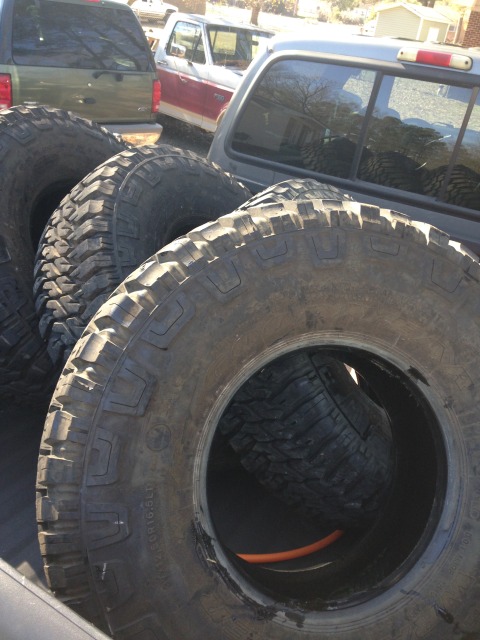

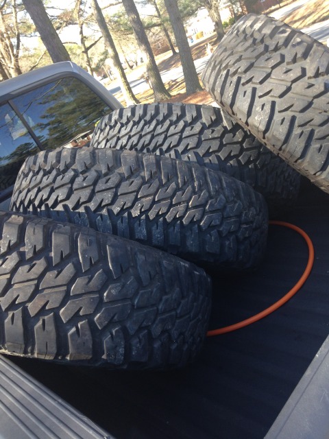

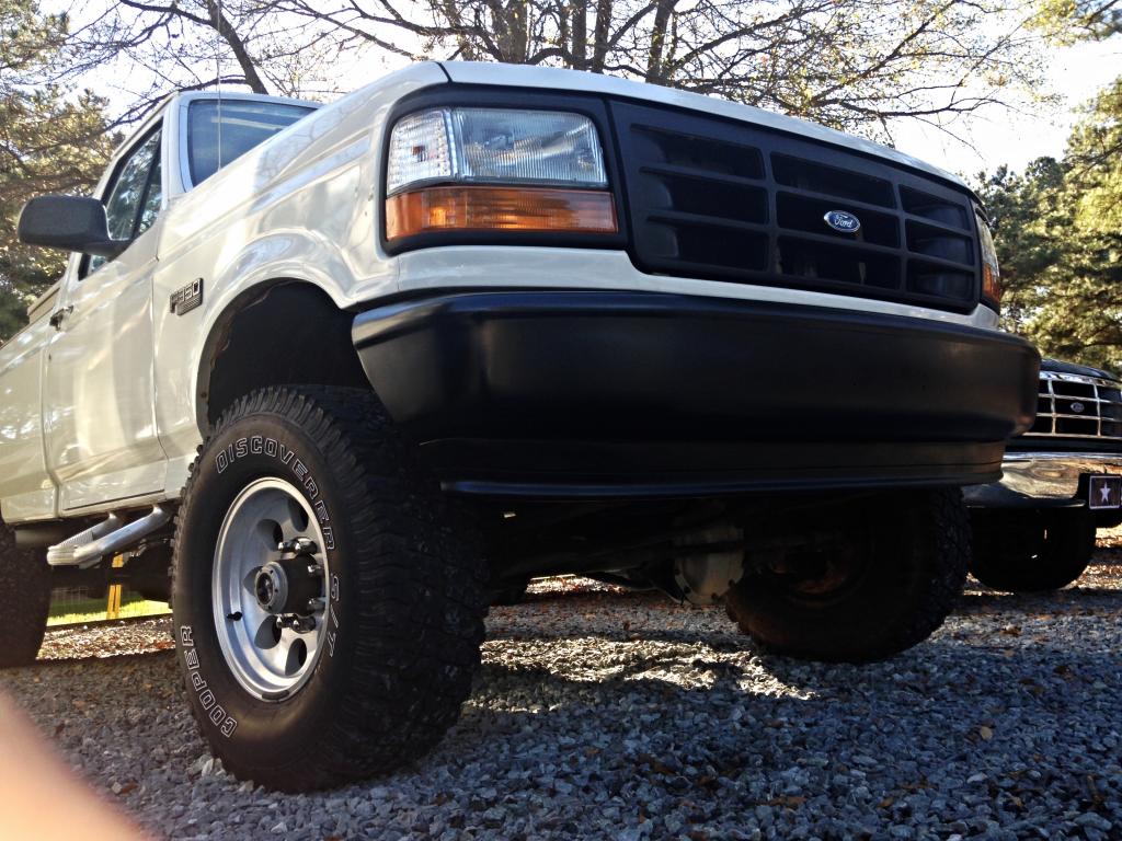

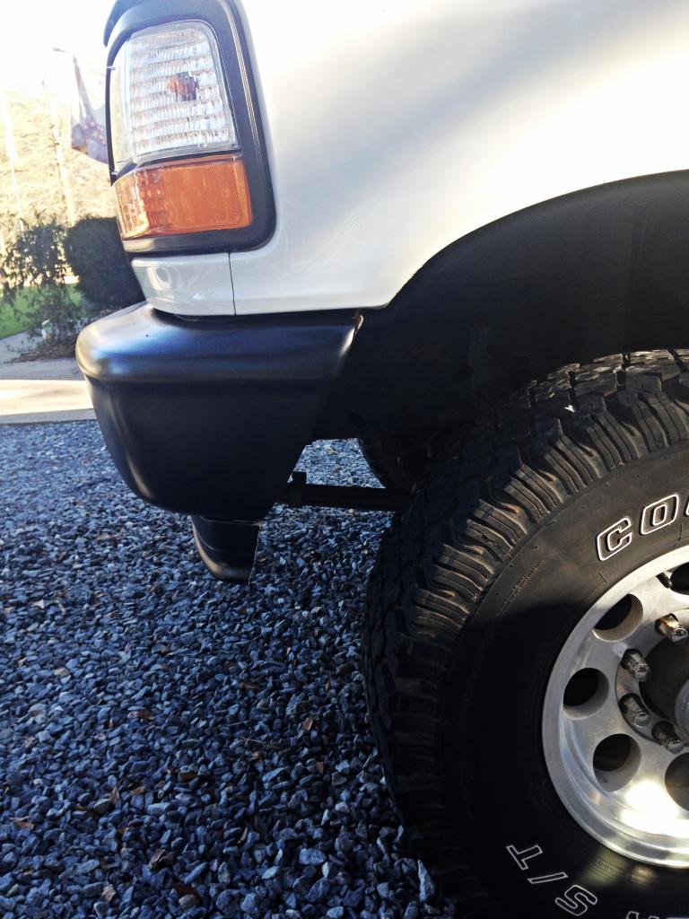

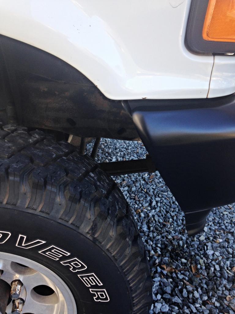

I decided when I bought the truck that I wanted to run some 37" surplus Hummer tires. I contacted Jeff in Lillington who sells these tires cheaper than anyone and is a good guy to boot. The wife and I went down there and arrived early on the Saturday he got some in, he usually sells out in one day. We were first! and I hand picked my tires and we brought them home.

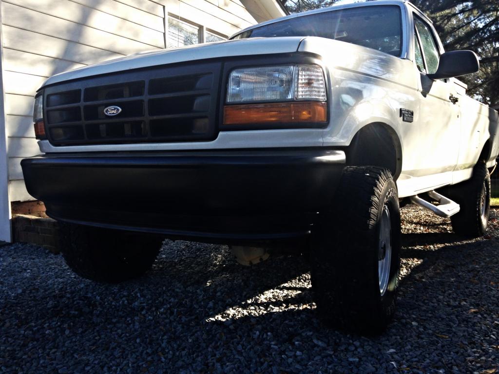

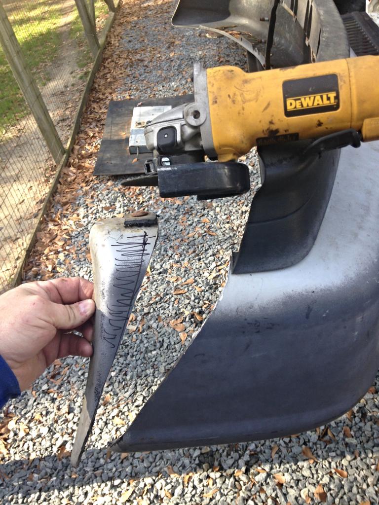

Well, I have these $300 military surplus 37" MTRs to go on my truck so that means I need bumper clearance. People have run these tires on this body F350s with no lift and just some bumper cutting. Since I am a fan of big tire/low lift and like the way that looks, I decided to get to work on a bumper.

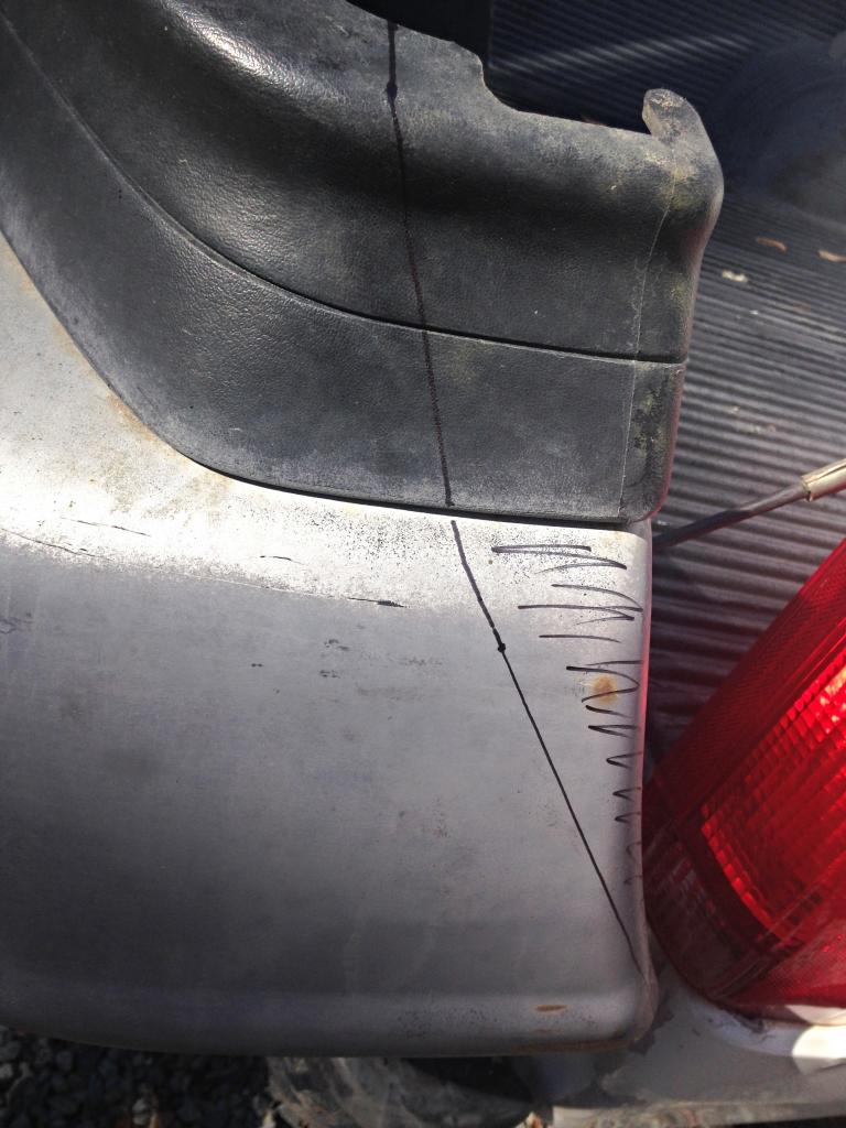

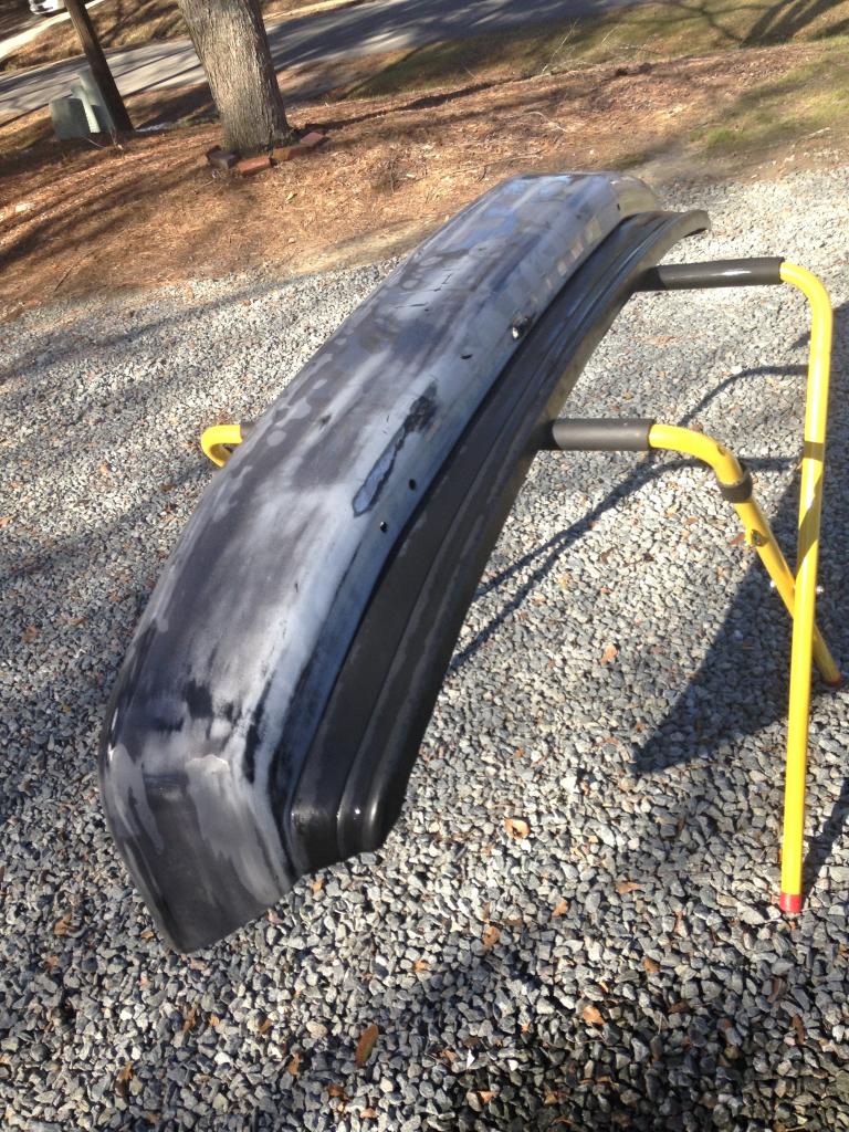

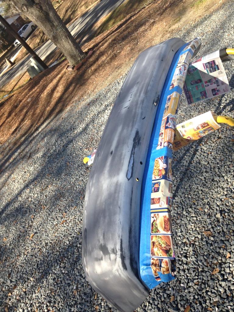

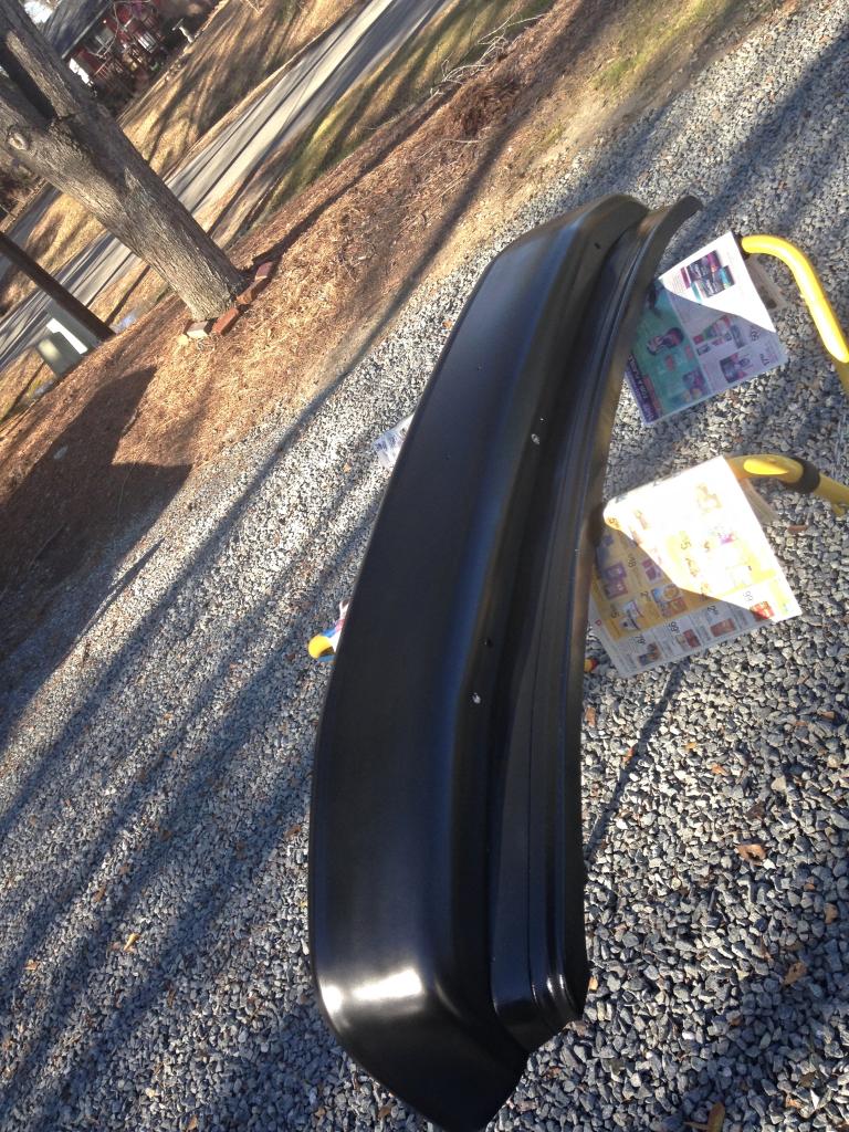

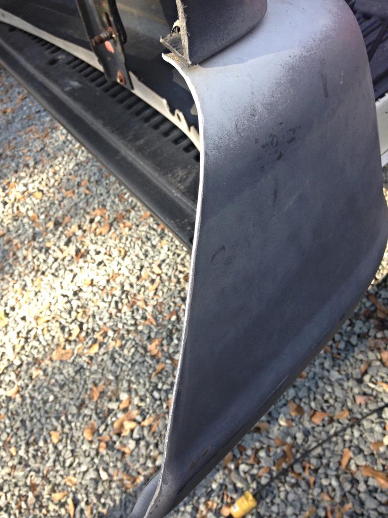

So, I have this painted bumper from my daughter's truck. I get it on the workbench (tailgate) and measure my angle to get me about 2 inches of added tire clearance (at bottom edge of bumper, air dam is cut back around 4") . Sharpie and a straight edge....
Break out my DeWalt 4.5" grinder and get to cutting. I used my jigsaw to cut the plastic air dam. Easy Peasy
Use the orbital sander and some 80 grit to smooth it up and not cut my fingers off later.
I get it sanded all over with the orbital, then wet sand it with a red scotchbrite and purple power degreaser. Blow dry with compressed air.
Tape up the plastic air dam.
I primed with Duplicolor self etching primer and painted with Duplicolor satin black wheel paint. Supposed to resist weather, sun and detergents. After untaping the air dam, I painted it with flat Krylon plastic paint.

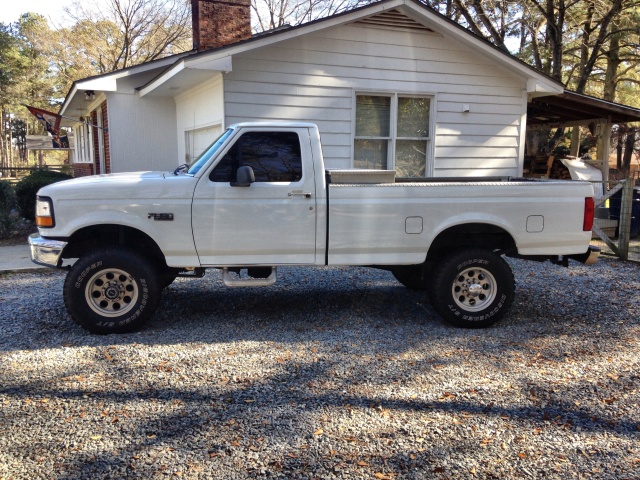

Got it bolted on, looks good. Went from chrome bumper to black, I think it looks pretty tough.
This was an easy and fun project. I am not sure I love the air dam and I may decide to remove it later, but I do like how it hides the spring hangers and radiator support. 37s here we come.

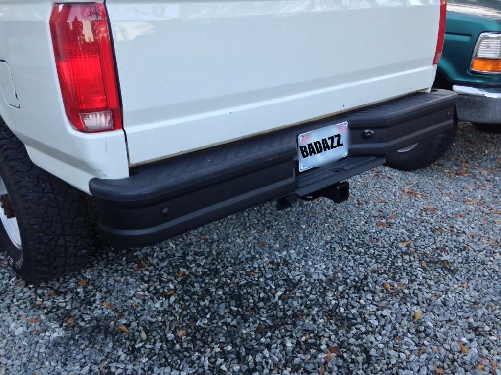

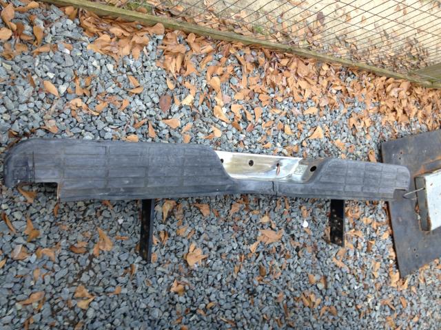

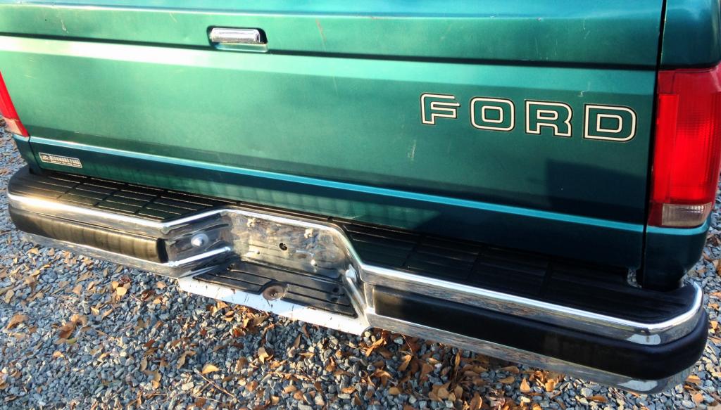

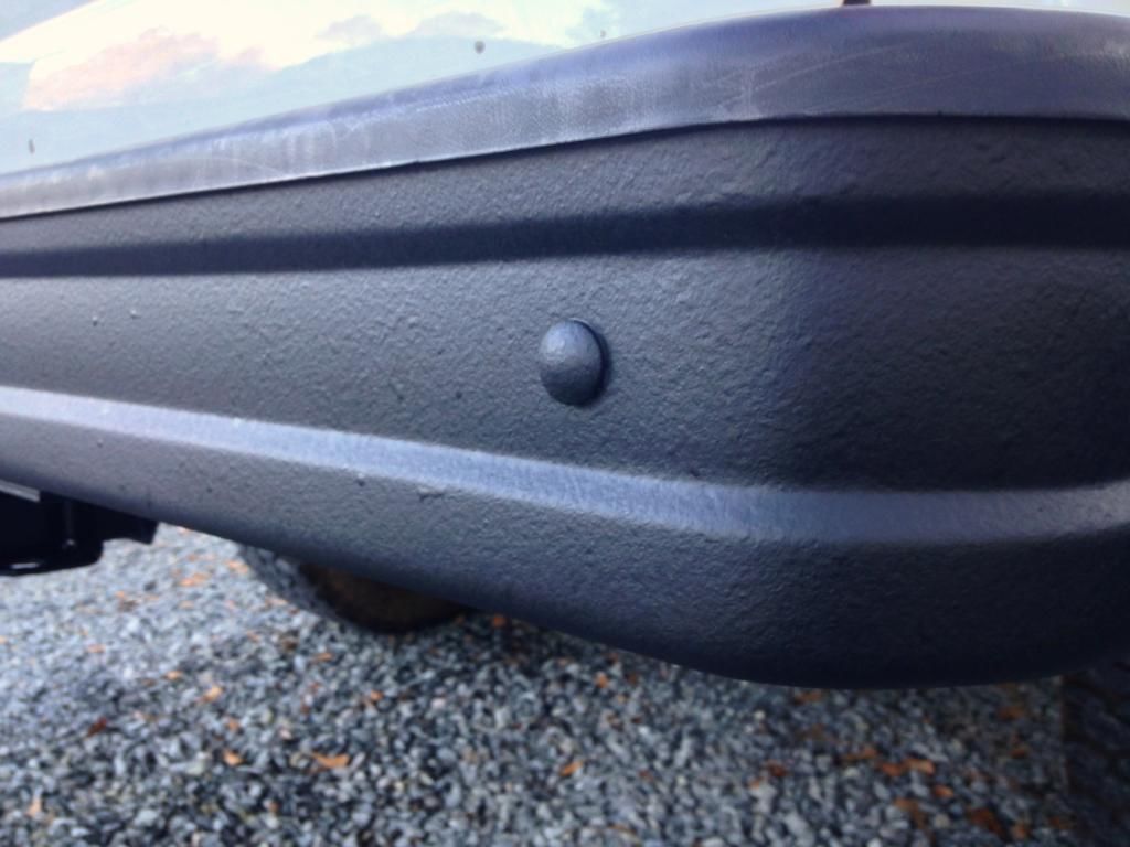

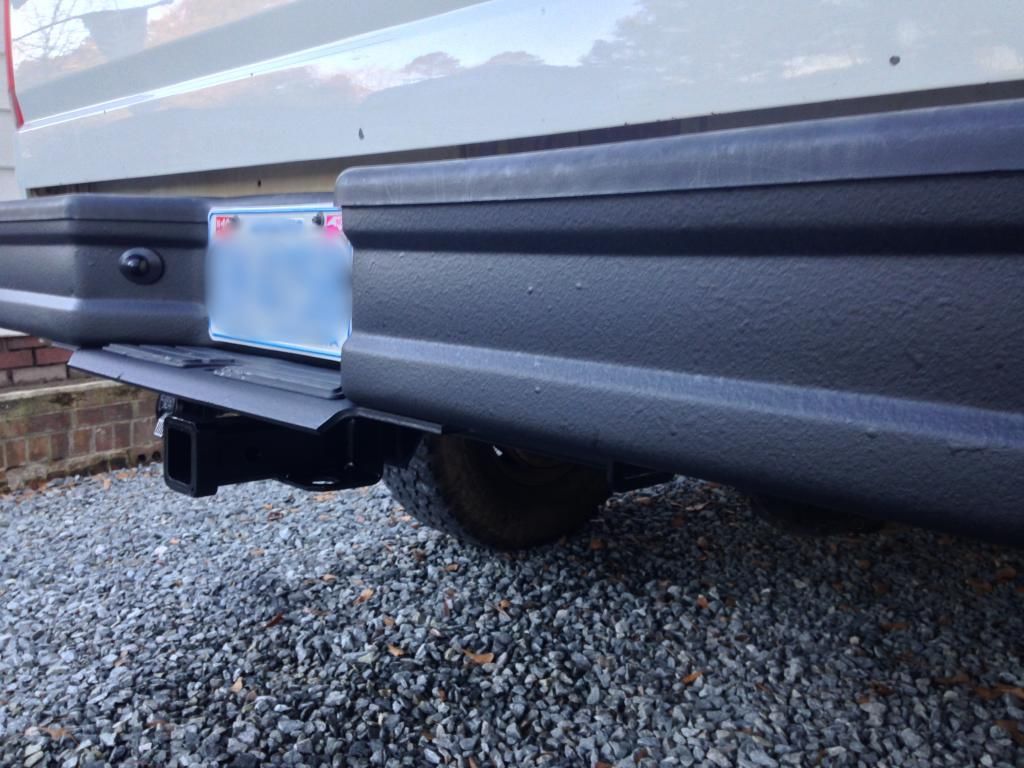

My original rear bumper was chrome and bent up like a snake on methamphetamine. luckily I had the perfectly straight rear bumper from Lafawnduh
Well after refinishing my front bumper, the new rear bumper was ugly as a fart in church. I had planned on using the same Duplicolor satin black wheel paint I had used on the front but once I got to the parts store, I had another idea.....
Bedliner. I looked online and people had nothing but good to say about this stuff, Duplicolor Bed Armor. So after removing the plastic cap from the top of the bumper (pain in the butt!), I used a 120 grit sanding sponge, water and Purple Power to sand it thoroughly and remove any contaminates. I then went over it with a red scotchbrite and more detergent. When I was done, I rinsed it with high pressure water and blew it dry with compressed air.
I then used Duplicolor self etching primer to prepare it for the coating. After it flashed off, I shook the Bed Armor for a couple of minutes and started to spray. It took 4 light coats to cover it completely and create a good texture. I was glad the primer was green as it allowed me to make sure of even coverage of the Bed Armor. The coating requires 20 minutes between light coats to avoid sags.
I am VERY happy with the result. It looks great and should be very durable. I will use this product again for sure.

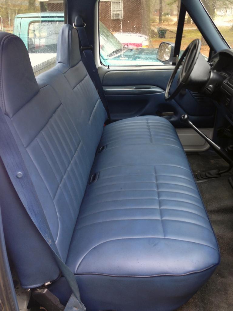

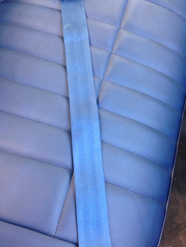

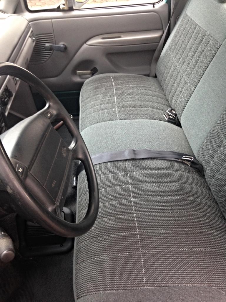

Kay from Glen's seat and top called me to let me know my seat was ready. I shuffled over there and picked it up. They did a great job on the sewing and I love the vinyl. It matches the color very well and I have always said these are the most comfortable bench seats ever. I soaked my seat belts in laundry detergent over night and then pressure washed them. They look like brand new. Riding in style brothers and sisters :driver:

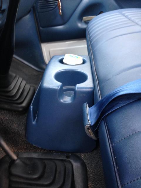

I have a Ford cup holder from some truck or other. It took some trimming on the bottom but I got it fitting good and now I can sit my mint julips down while changing gears.

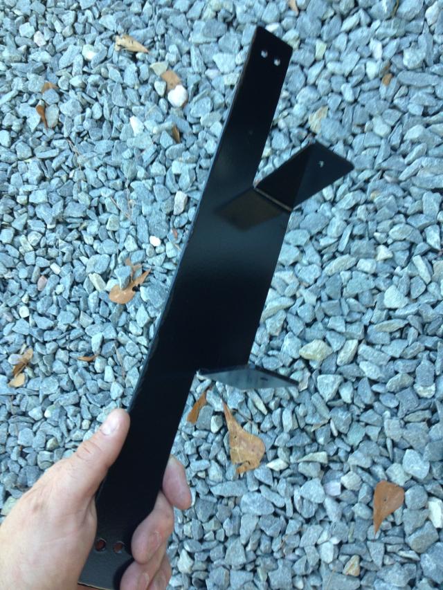

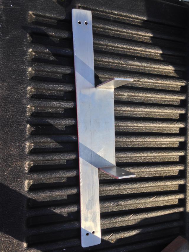

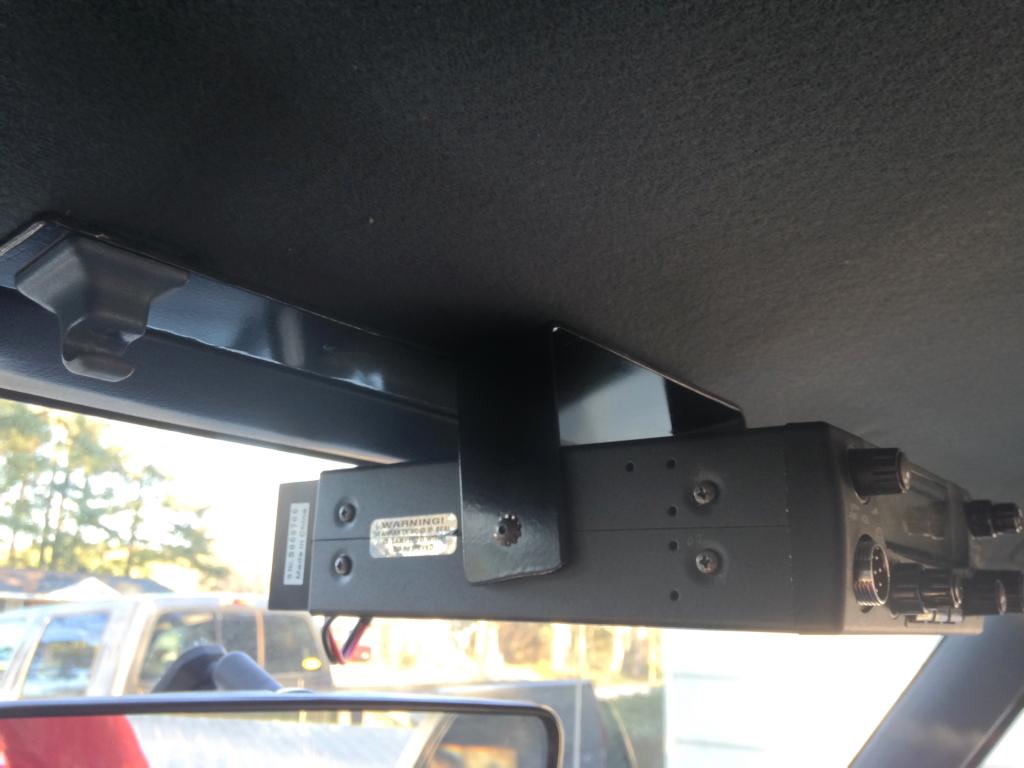

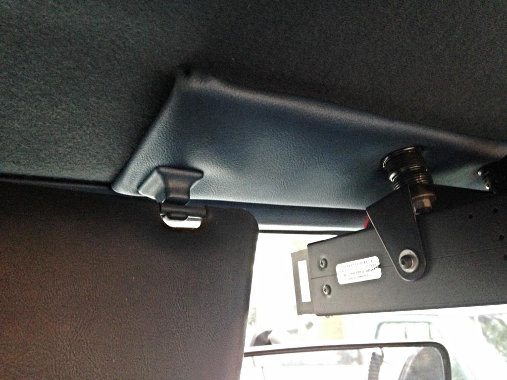

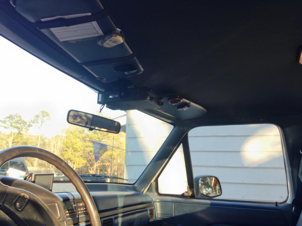

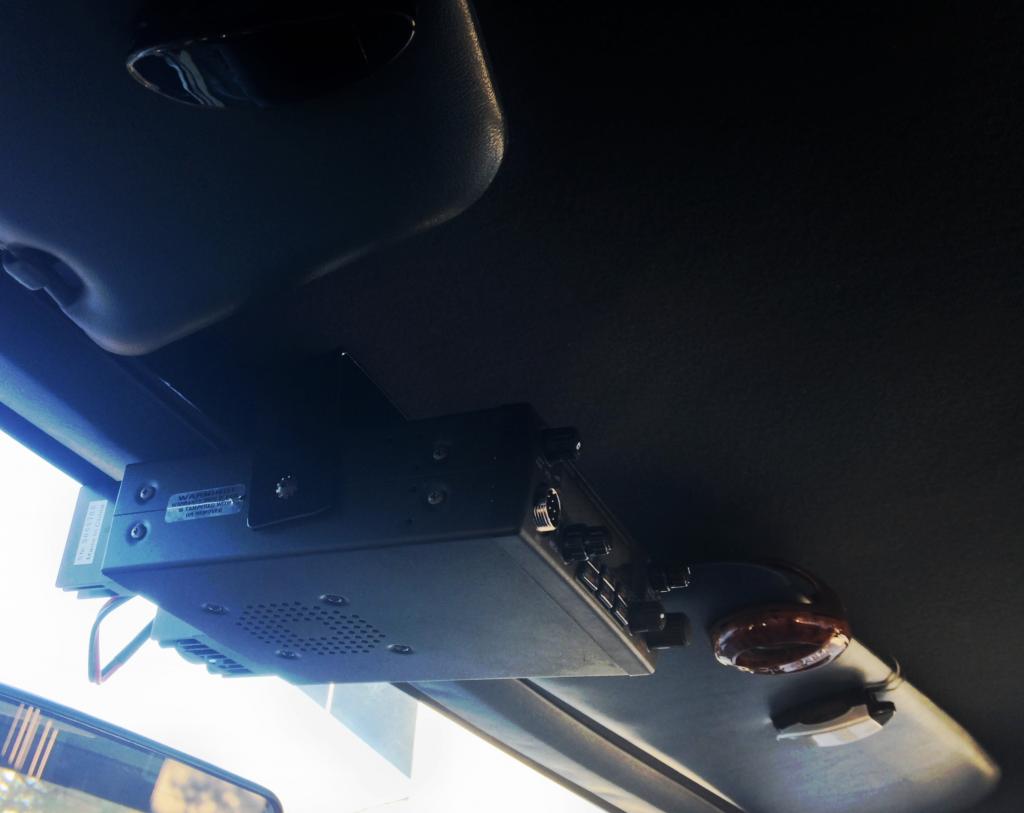

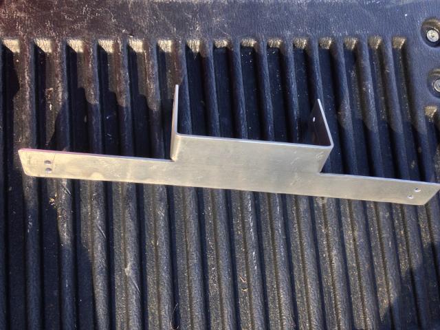

I wanted my Ham radio mounted up on the ceiling between the visors. I did not want to damage my headliner by drilling through it so after some thought I hatched a plan. I made an aluminum plate and mounted it by using the visor clips and their screws. It was covered in vinyl and worked but I was not happy with it overall, I wanted something better.
ai7.photobucket.com_albums_y252_ponykilr_1CB9193D_6B3D_4A85_A632_A66FFC1C055C_zpsrsxdmlro.jpg

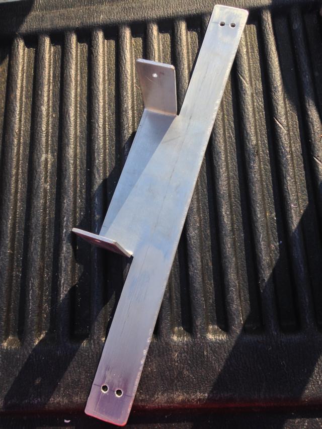

I started by cutting another piece of 1/8" aluminum 3" by 17". I cut some radio brackets into it, cut them to length and bent them between 2 pieces of oak in my vise.
Some holes drilled to line up with the visor clips and a couple for the radio mount screws and it was done.
Then I primed it with etching primer and painted it. I decided on black even though I have the correct blue. It just seemed to go with the radio better.

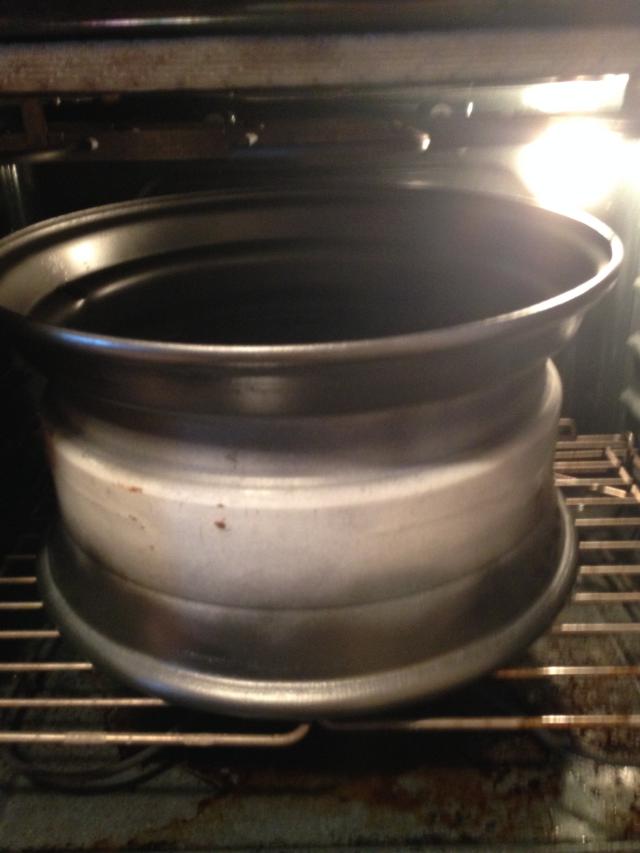

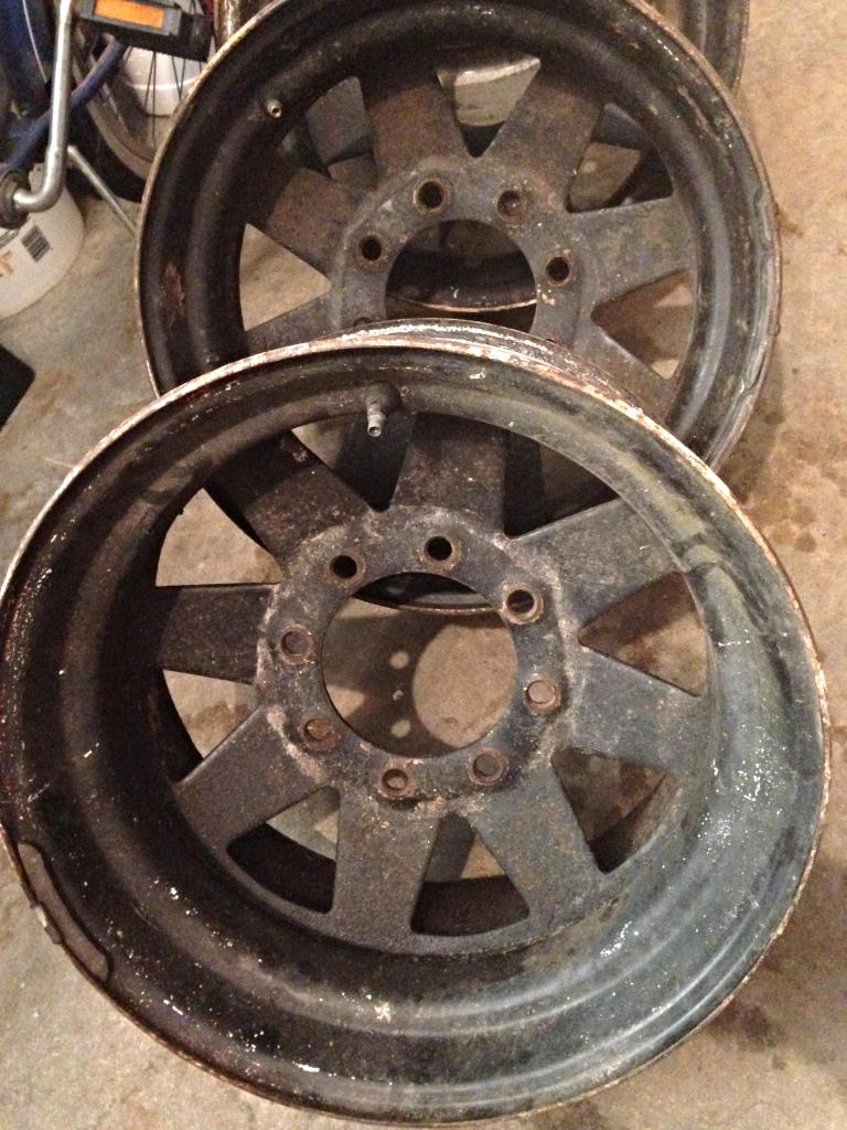

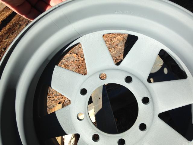

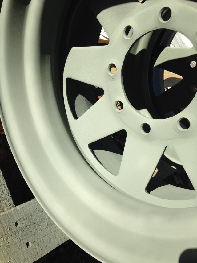

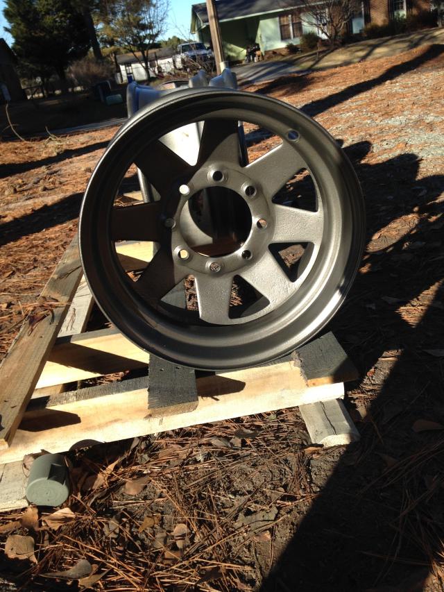

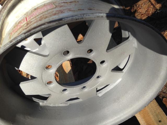

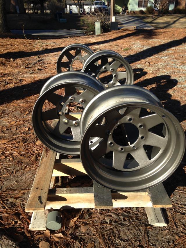

So those crappy old wagon wheels I scored for a Franklin got the royal treatment today. I took them to Gainey's Sandblasting in Linden NC today to be prepared for paint. (Gainey's does great work for reasonable money and is a heck of a nice guy to boot, (910) 980-0621)
At the blaster
ai7.photobucket.com_albums_y252_ponykilr_E4FDFAAC_451C_4451_A1C1_C554841D43F2_zpstgjxfrmx.jpg
All cleaned up
ai7.photobucket.com_albums_y252_ponykilr_34B3A6B9_B108_4638_B3E9_6870DF61CAEA_zps2wxspekt.jpg
In Rustoleum etching primer
ai7.photobucket.com_albums_y252_ponykilr_1D24EB2C_3497_4D3A_97E9_52A9B64E4D5A_zpszt8rmddh.jpg
Sealer by Rustoleum
ai7.photobucket.com_albums_y252_ponykilr_FD1D6EB3_E32C_42BF_B4EE_E48685D95243_zpssasiqh60.jpg
VHT Cast Iron Gray enamal
ai7.photobucket.com_albums_y252_ponykilr_DD88552B_8F3C_4DDB_8AF0_EEE42DFC7D65_zpsj8iu41vm.jpg
ai7.photobucket.com_albums_y252_ponykilr_EDD0740D_1B24_4187_86F0_8544521FF0E7_zps3cmh7nty.jpg
In the oven one at a time to cure at 200* for an hour. The wife did not like my baking and I had to clean the oven when I was done. It involved turning on the self clean....but still I didn't like her tone :D
ai7.photobucket.com_albums_y252_ponykilr_DADB1E80_F489_4011_A988_D990B10D1793_zpsrrvicf38.jpg
Not bad for wheels that most people didn't think were worth saving.

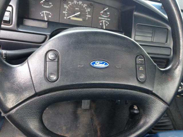

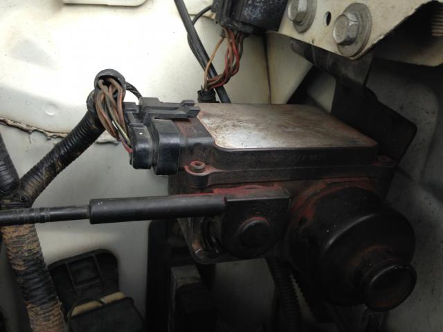

I forgot about adding the cruise control. The 92-97 trucks all come wired for cruise whether they have it or not. All you need is the servo/cable assy and the controls I.E. steering wheel (with airbag) or horn pad (without air bag).
I located a servo and a horn pad and had it shipped in. Took all of 10 minutes to install, simply plug n play. Makes trips much nicer.
