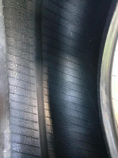

Run flat grease...... :poop:
I used the wife's large silicone spatula to get the biggest of it out. I set up a block of wood on some newspaper to wipe it off of my borrowed tool.
I got it down to a thin skim and it just was not coming out by wiping. I was about to just decide that balance beads were not in my future.
I came in and read some online posts about it and voila! it seems the grease is soap and water soluble! Purple Power, Dawn and a stiff brush with plenty of water and it came clean as a whistle in just a few minutes. I got as much water out as I could by playing the tire flip game and then a couple of old towels got the rest.
They are all cleaned out and ready for mounting except for the plug I found in one. I wiil patch that and then mount em up this weekend I hope.

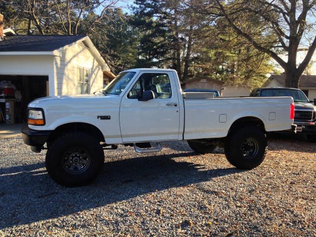

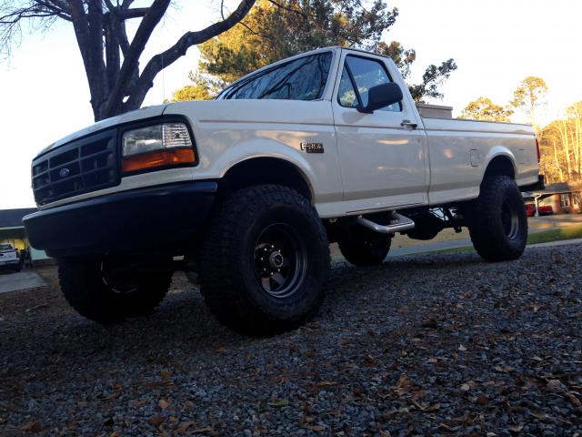

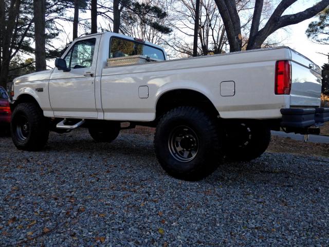

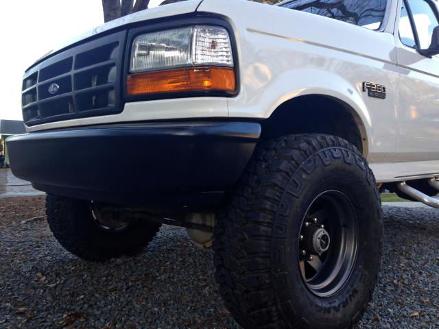

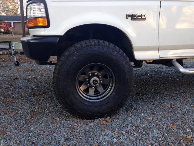

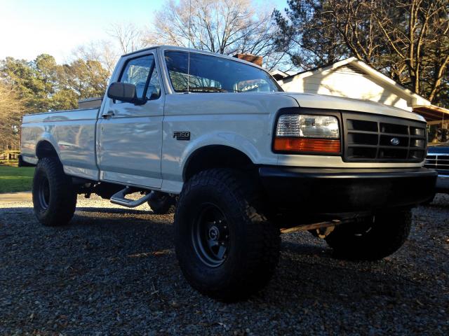

Well, I got my tires on the wheels and on the truck today. I am really happy with the color (Cast Iron Gray) and the tires look awesome. I think I will put an add-a-lead on the front or do a shackle reversal. The tires rub nowhere and it rides better than before. I adjusted my rear brakes while I had the wheels off and found that some of the brake hardware was not installed correctly. So now I have new wheels/tires as well as rear brakes/parking brakes that actually work :)
Thanks man, I didn't want black but the theme is dark so gray it is. The color seems to really make the black of the tires and hubs look good. I think I want to get some plain cadmium plated open lug nuts for it. The chrome ones aren't working for me.
Gray toolbox and whatever color is easiest to touch up on the bed caps.

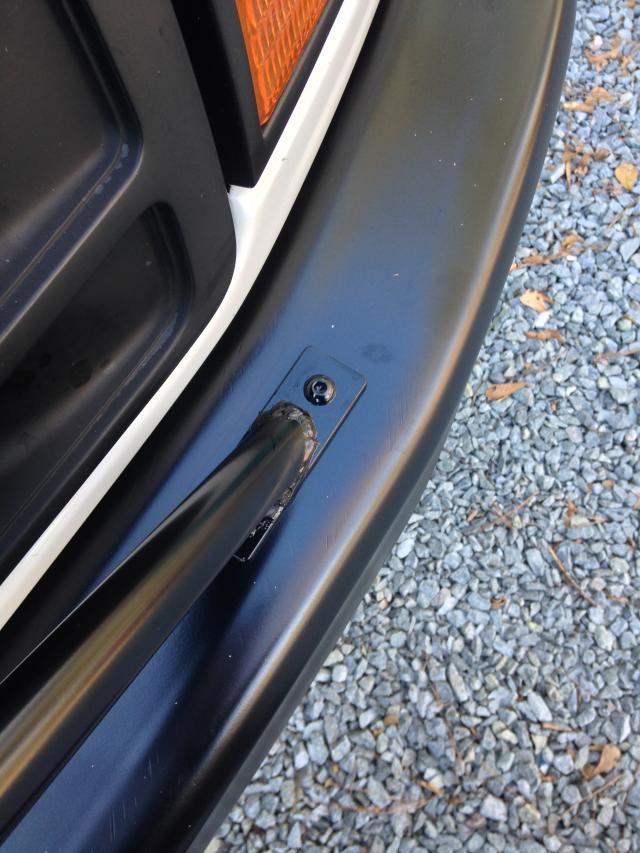

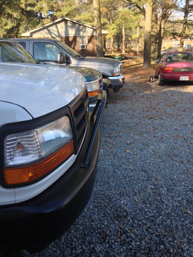

Bent up and welded together a light bar hoop for the front bumper yesterday.
Got it sanded and primed/painted this afternoon. Will hopefully put it on and take pictures tomorrow.

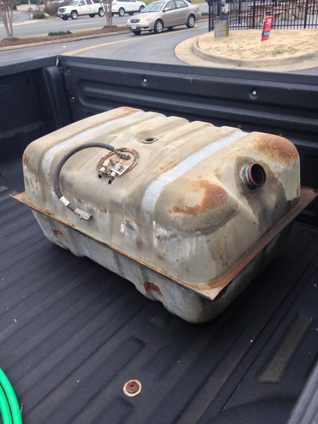

Went to Chesapeake and picked up a Bronco fuel tank to replace my rear tank.
This replaces the stock rear 19G tank with a 32G. Got tank and fuel pump module complete.
Updates soon.
Fuel is old and stinks like only old gas can. Will clean it out with an old chain and some soapy water to make sure no trash.
Paint it with zinc paint and slap it in. It will be nice to have that much fuel reserve.
The Bronco pump hanger is discontinued and impossible to get separate. Glad I found this thing.

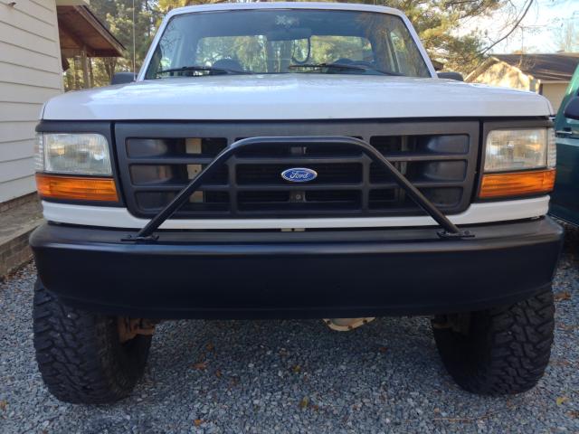

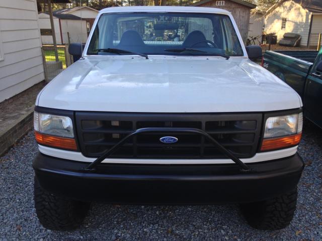

Well thanks to some advice here, I got my tube light bar bent up and mounted. It is 1.25 HREW tube and has a mount tab the length of the top.
Will fit round 6" lights. What are some good for the money lights in black I should consider?
