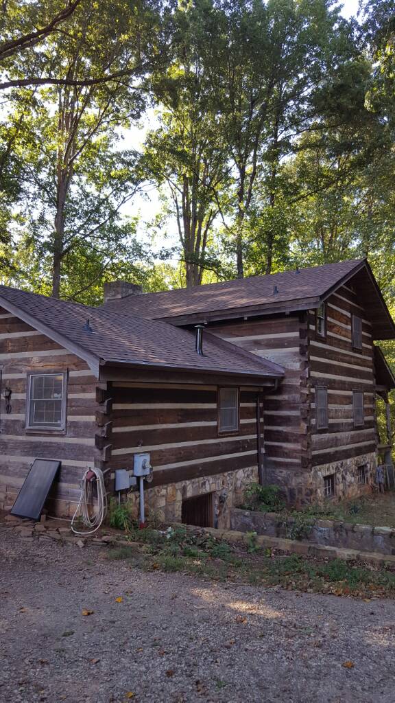

I've lived in one my whole life. Hugh flat cut logs. What you see on the outside is what's inside. Love it other than the bugs bees trying to eat it. Basement with two floors.

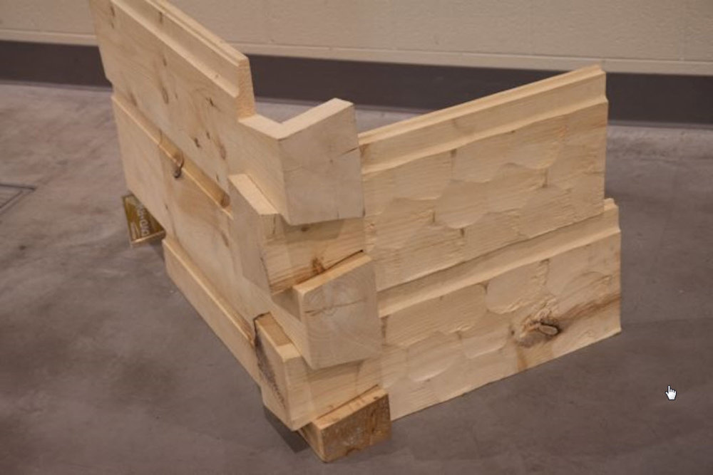

They are called 'false corners'. I am using them on my storage building/shed/cabin. They are VERY expensive compared to the siding. The false corners were about $4,500, and the siding was only about $2,000 for my 14x24 building.
Here is a random picture I found on the internet to show what I am talking about:

I don't have my wood yet, or I would take some pictures of it and post them up. I put in my order about a week after the big snow. It should be ready by the end of February. I paid $1/ft extra for actual hand hewing by a guy who lives up around Boone. Gary at Boone Custom Forest Products can probably put you in touch with some builders who specialize in building log homes. It would definitely be worth your while to go up there and talk with him and tour the place.

Maybe it's just me, but it seems like the ends of the false corners would split like the paternity test result just came in.
