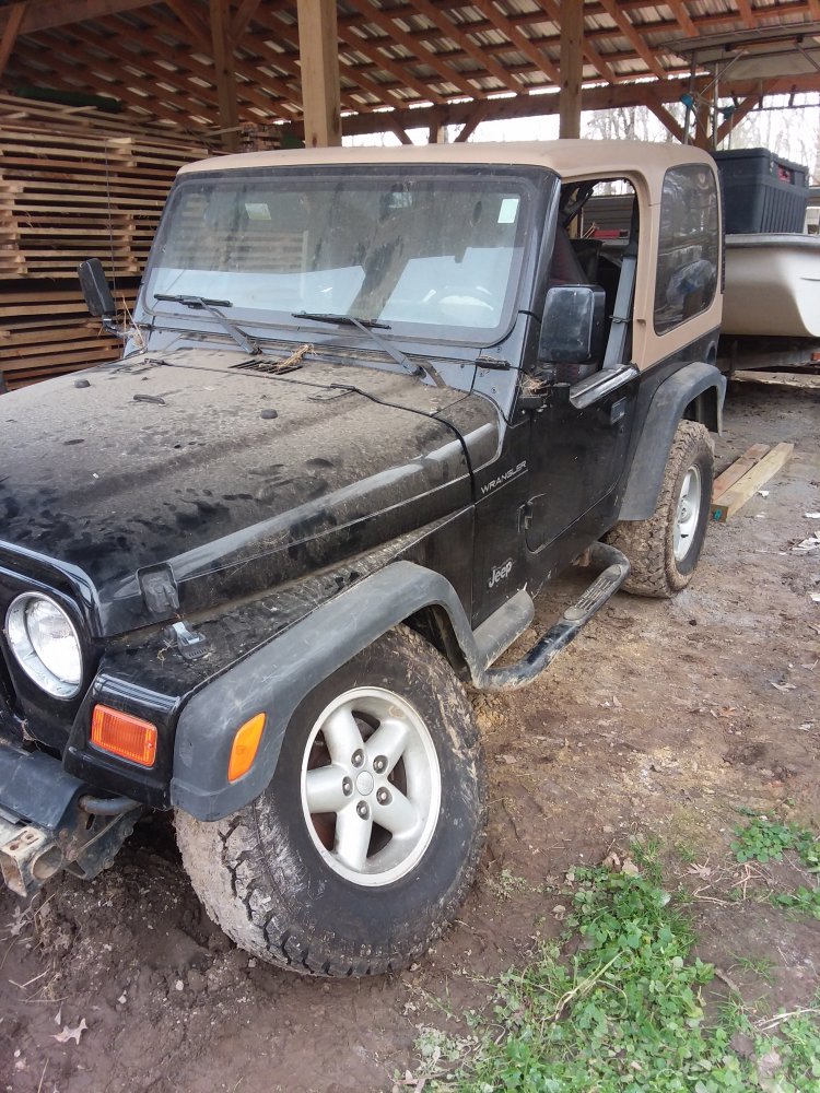

OK guys let me know your thoughts. My daughter is going on 14 and is having a fit for a jeep. I like the idea of fixing a CJ up together, she likes the new 392 Hemi Wrangler. So possible compromise I found a wrecked 4 cylinder TJ on 33. I have not seen it yet, my buddy bought some farm equipment from a guy and it was in the barn. Wrecked about a year ago. Hit a culvert with right front tire. Very slight body damage to fender, front axle housing broken, transfer case busted, body lift shifted and both airbags popped, back glass on hardtop busted. Nothing that scares me in any of that as long as the frame survived. What is everyones thoughts? I think I can get it 2k or so. No idea about the title status. What do I need to look for specifically to a TJ? Frame rust, cracking? Motor was replaced before the wreck so should be tight. Mainly looking for some insight and opinions on the whole deal.

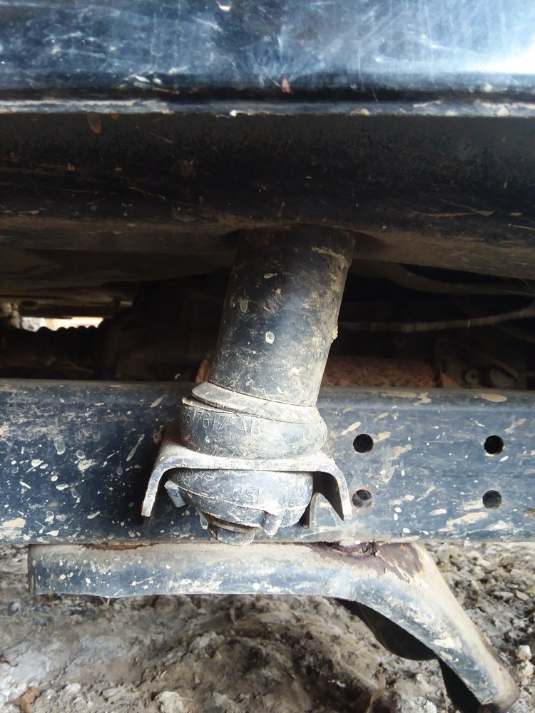

Check the TJ frame just behind the door where the lower link mount attaches. There are some holes in the frame where you can inspect inside for rust.

I wheeled one just like that for a while, the 4 Cylinder isn't that bad, but the AX5 transmission and Dana 35 rear are weak points, probably not terrible for the street though. Frame rust is the biggest thing to watch out for, as Shawn described, check around the rear lower arm mounts carefully.

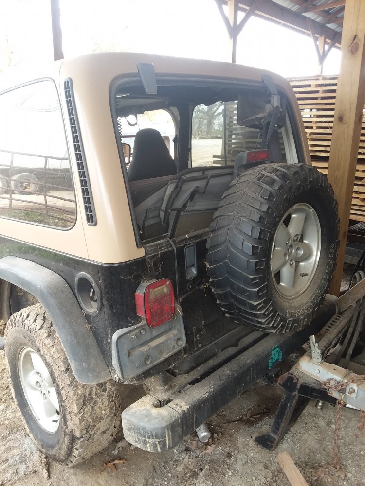

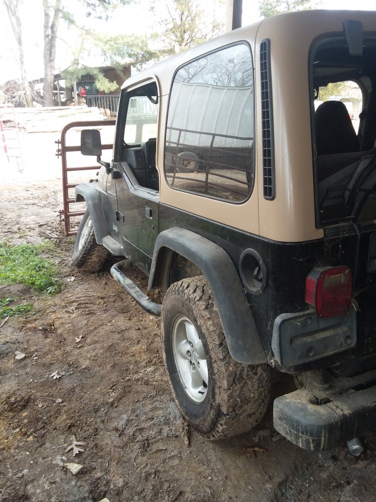

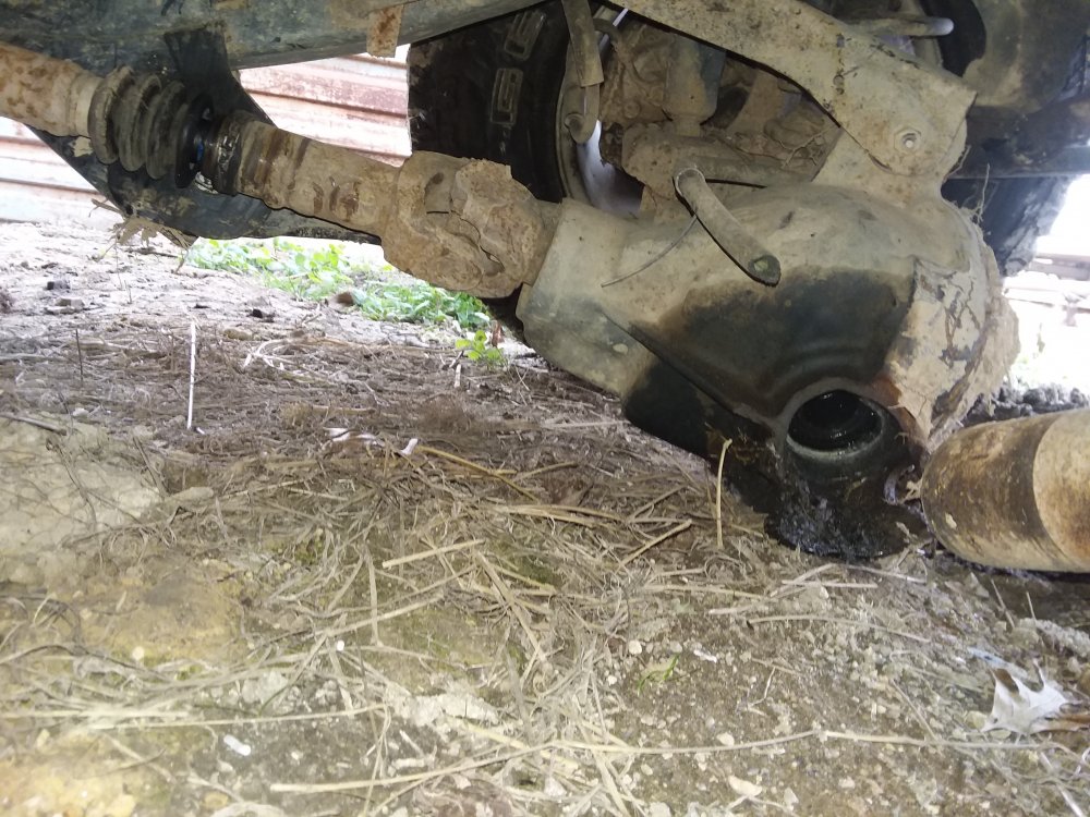

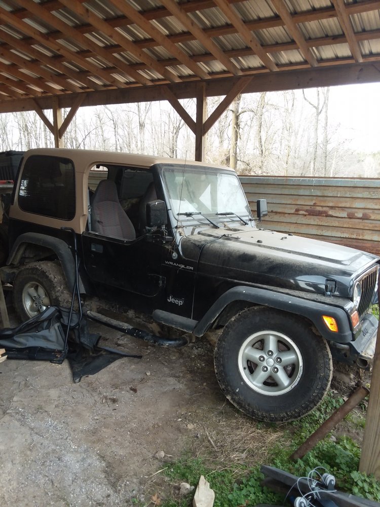

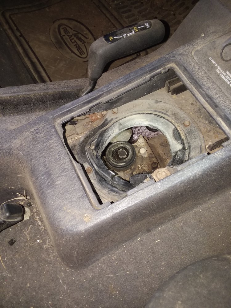

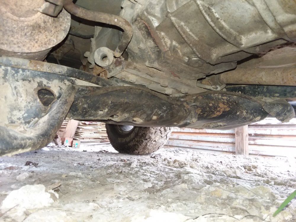

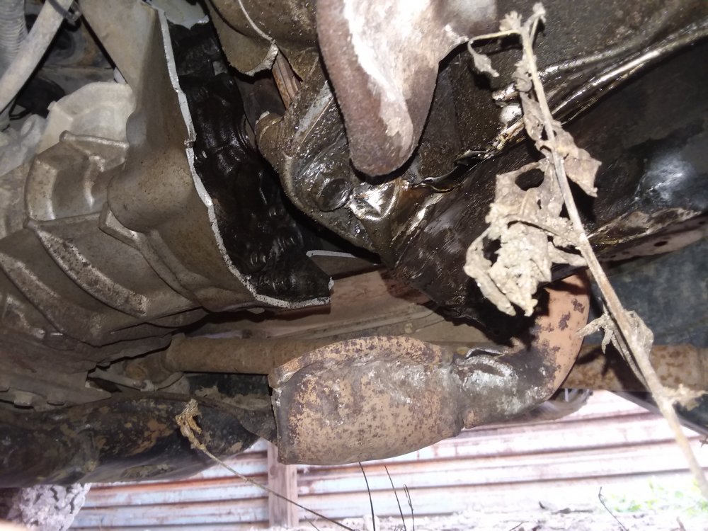

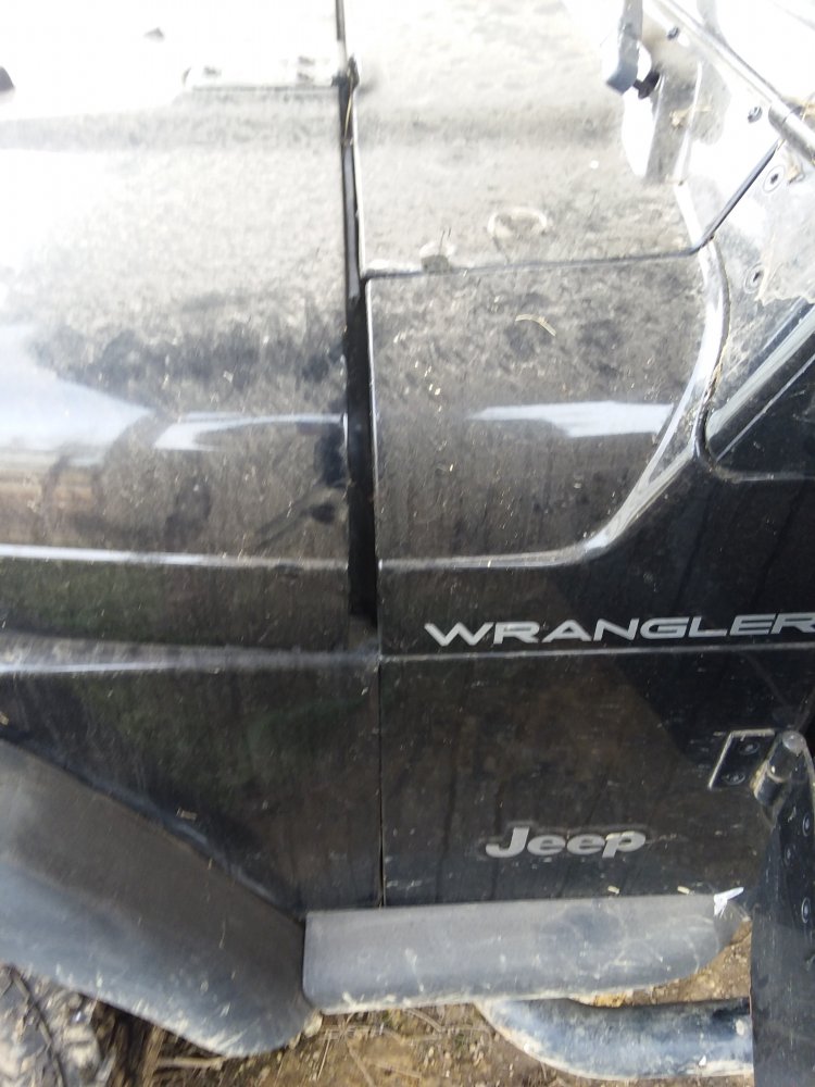

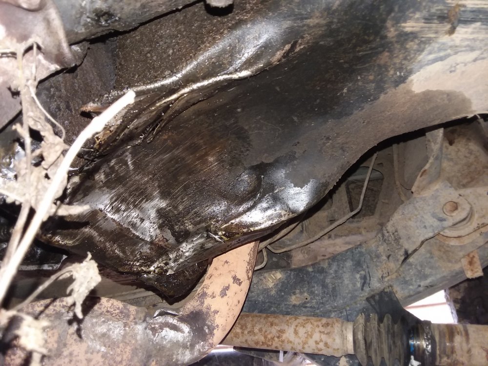

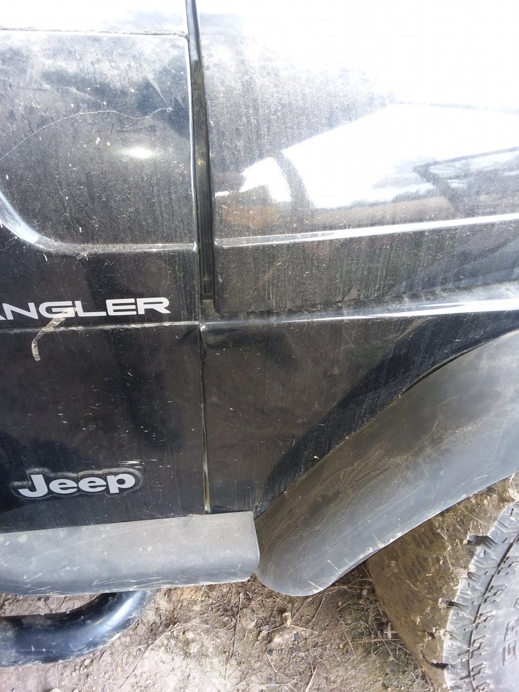

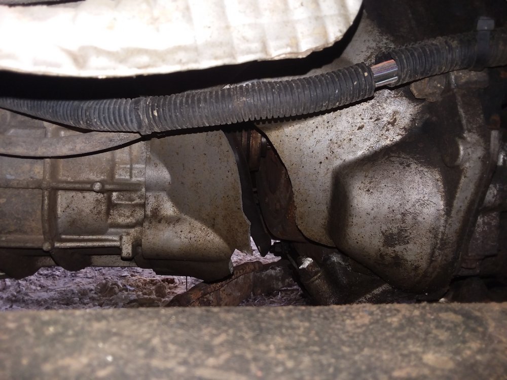

Well ended up getting by there a little while ago. $1500 was the price. It has new 31x10.5s on it. No frame rust that I could find and no buckles or cracks in the frame. Oil pan crushed against crank, bell housing busted, shifter broken off in trans, hood would not latch and a few other odds and ends. I think its too far gone for us.
Good call on that one!
Ouch!, Whacked that culvert hard! Yeah, I'd pass on that for anything but a parts jeep.... On the other hand there is good money to be made parting it out, The frame's can bring $1500 by themselves up here!
I think the frame is bent upwards judging by the fit between the fenders and the tub

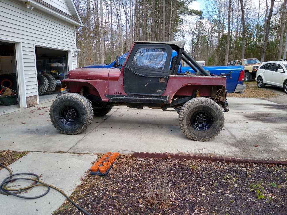

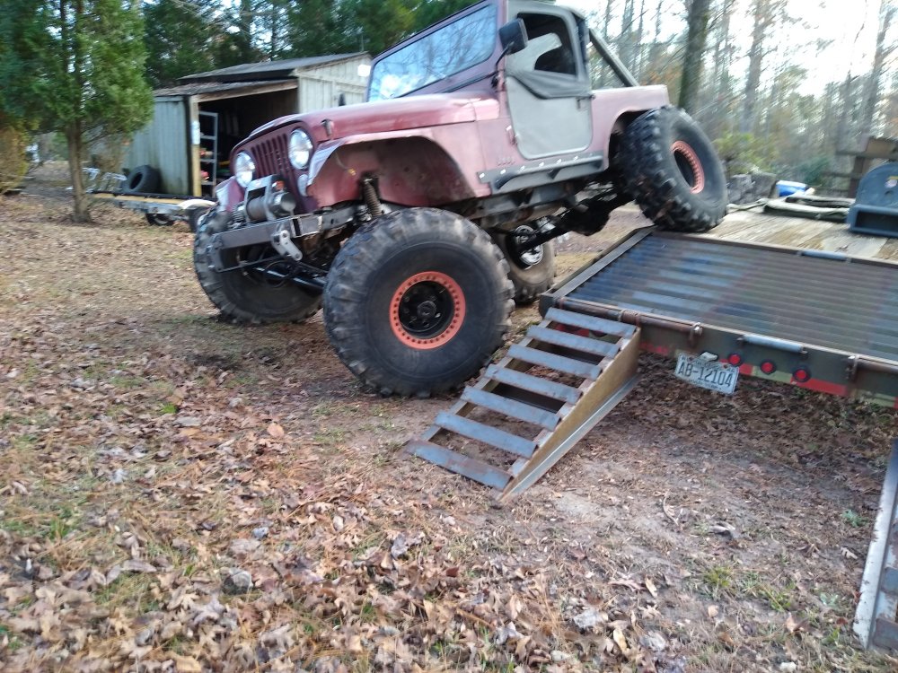

For what it's worth my son is 14 and will be daily driving the old cj when he gets his license. He's been wrenching and building things with me for the last 10 years including the latest little one ton swap project on the cj. But, we live out in the swamp, there's no highways, and very little traffic. Highest speed limit near me is 55. Had we lived in suburbia around people in crazy amounts (12 or more) the old cj wouldn't make the cut. And it will be fully caged with 5 point harnesses by time he's motoring around. Even with modern-er brakes, steering, fuel injection, and the stability of the full width 1-tons it's possible I'll "share" the cj with him and put him in something safer... TBD. But for now:
Weekday mode:
Trail day mode:
