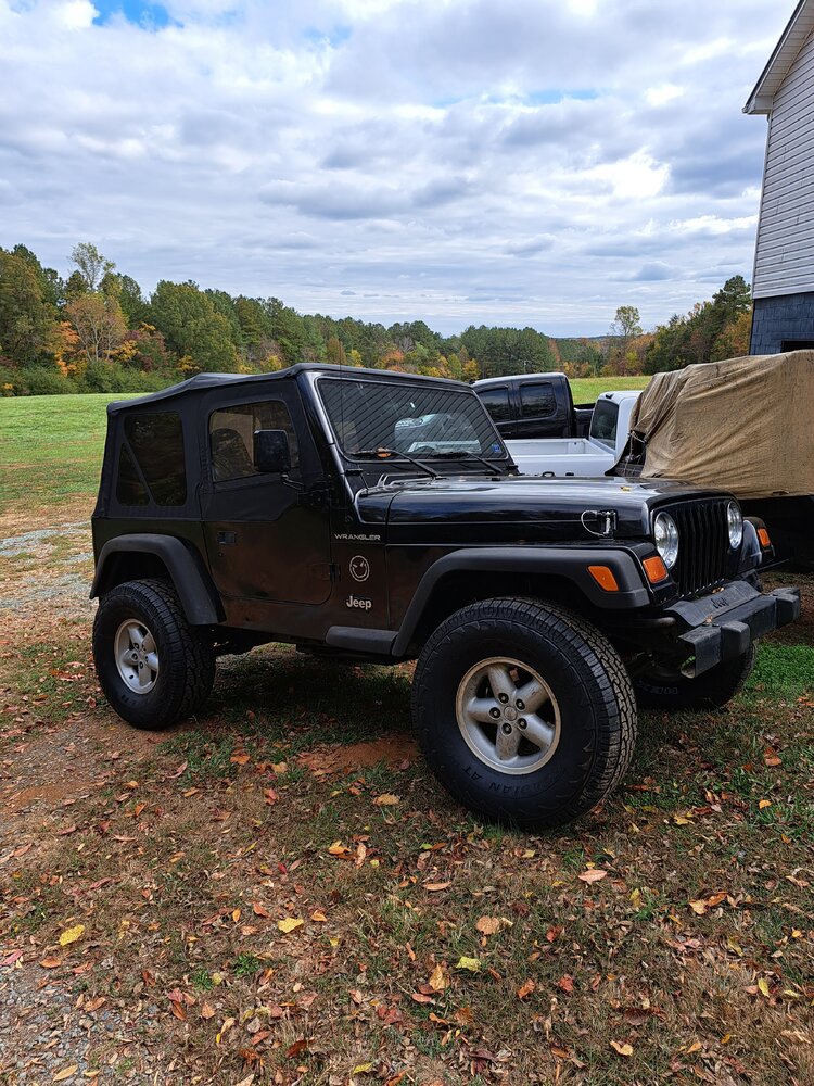

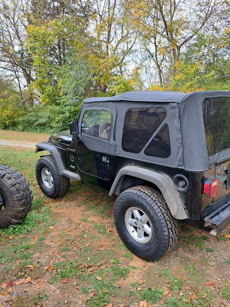

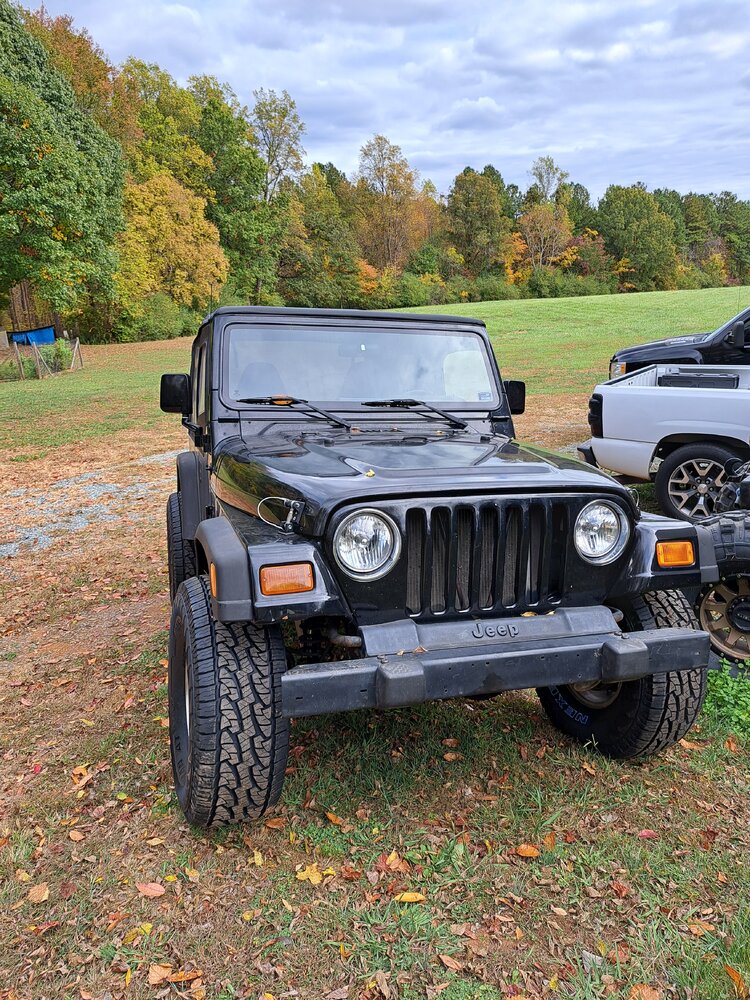

Well thought I would update this thread..... kid talked me into buying that wrecked TJ posted earlier in here. Been a lot of work and alot of parts swapping (thanks to everyone on here who helped us) but it's on the road. Turned out pretty decent and we both happy with the end result.
