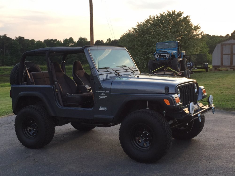

Couldn't be happier with my zone 3" lift on my tj. <$500 and clears 33s perfect

Zone lift on 33's as well with metalcloak front and rear tracks & disconnecting sways.
Springs slipped on and off with ease doing it the way Jody said
^^^that's a very nice lookin TJ there sir!!
