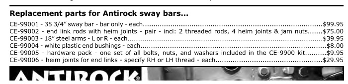

The tie rod ends themselves are only like $50 if you go to curries website and chat with a specialist. They'll give you a PDF of the parts and their number. then CALL. On their website the ends are $74 but I know I saw them for $50 on that PDF when I was looking up the part# for the rod I bent
Currie's parts are expensive as hell. The rod ends for their sway bar are $40/ea if you buy from them. A good-quality studded end from anyplace else is $11. I'm betting you can do the same thing for the steering with a little bit of research. I know Andy's tie rod uses standard Moog ends. I bet Currie is the same.
Cheapest I found them was on Summit, the Drag Link end was 149.01 and the LH TRE was 67.97, 50 bucks may have been the price when they first came out. When I was searching some the price on the whole kit was $400ish years ago but now is $500+.
I was wrong....$29.95...and that was a month ago

They told me $40/ea for 99006, same price that's on their website.
Price of being you I guess.
I placed a call both times. First for info on part numbers, and they sent me that PDF (which I can forward to you...just can't upload the PDF to the site) and then I called and spoke with someone personally on the part number search and purchase. I debated getting both the rod AND new tie rod ends (which were exactly as above) or just the replacement rod, and settled on the rod only. This was on April 7 2017
