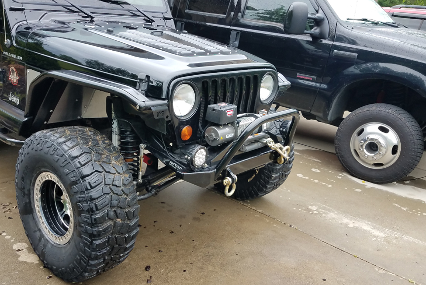

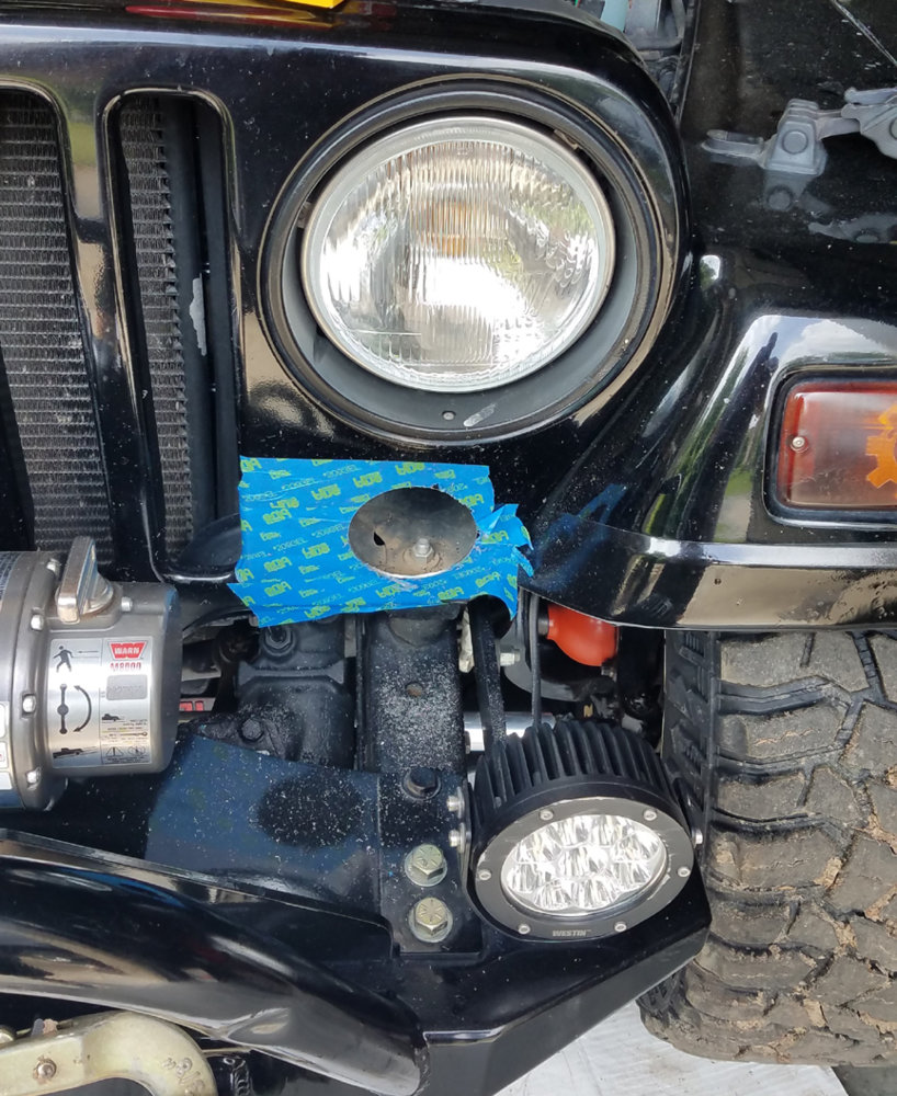

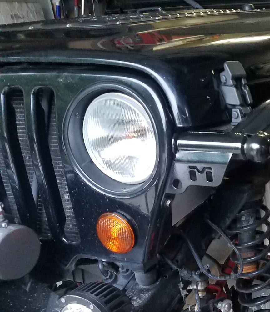

View attachment 269811 View attachment 269812 View attachment 269813
Yeah its kinda of a pain. They replaced it with these trailer lights and the bulb went out and of course you can find a matching replacement.
I have the small ones on the fender and ones on the grille, so I am doubly douche :D
you're not in the douche club...you have to have metalcloak to be considered :p
