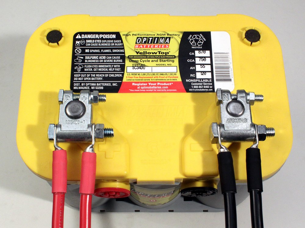

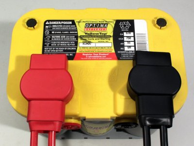

Winch Must be [my opin] straight to the battery, as it pulls more amps that your engine starter. The CB & other accessories should be going through a fuse block, & sometimes a relay. Relays depend on the amp draw.

6 circuit with cover. You can get the one with the neg bus bar if you'd like to run all the way black for non chassis grounding. The winch will need to stay on the battery buy a pair of mil-spec terminals would be best for it.
This (IMHO)

I've used a 7 circuit auxiliary fuse block (3 constant hot, 4 switched hot) from Painless Performance on my Jeep and my previous tow pig. Easy set up and never had a problem with them. The winch on my Jeep is wired direct to battery with mil-spec terminals, as previously stated.
This is for the TJ right? While not the easiest, but certainly the cleanest route is to get the correct wire terminals to re-pin and use the empty spots in the factory fuse panel under the hood.
But as stated, get the mil-spec terminals, and run the winch straight to the battery.
