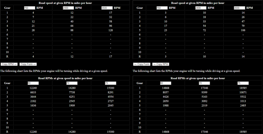

Tow rig axle gear ratio
3.54 vs. 4.10

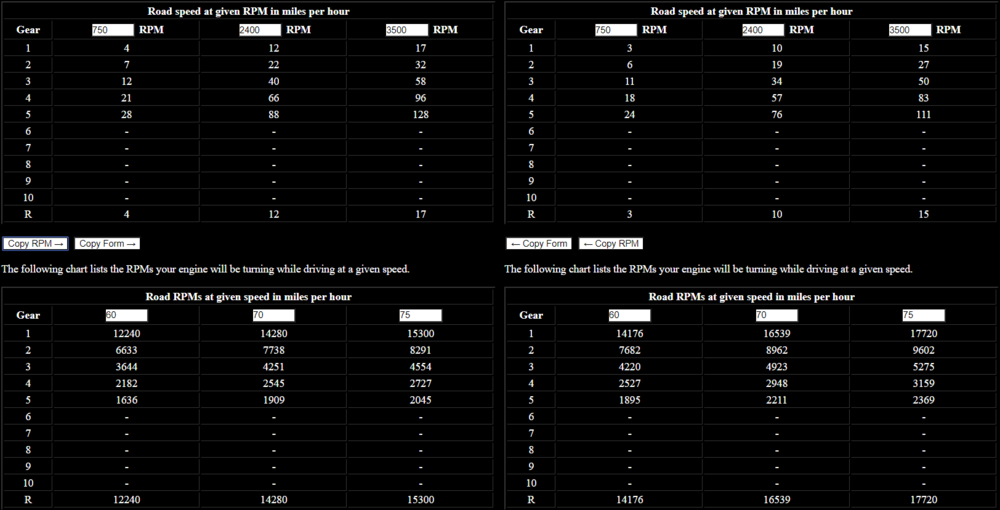

3.54 vs 4.30

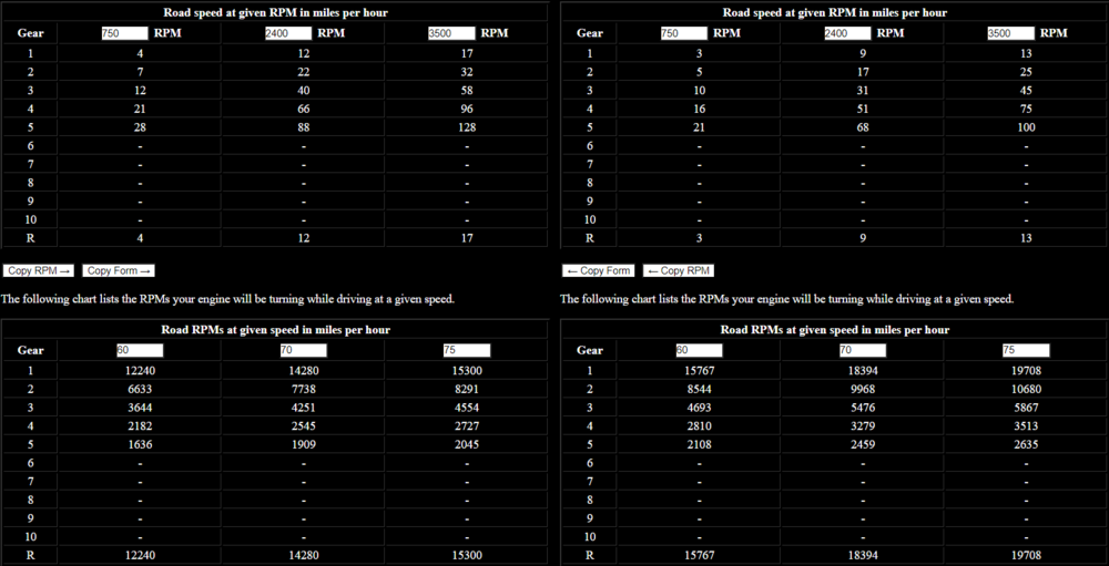

3.54 vs 4.56
@BigClay I'm not sure where you sweet spot is on that truck but I'd assume good cruising at 2400-2600 Rpms? and good hill killing power above that? Personally I'd be looking at 4.30 or 4.56, the deciding factor would be you feel the truck likes to be at rev wise.

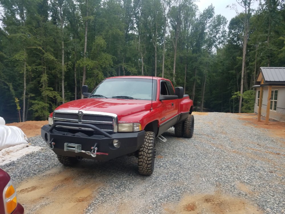

besides...yours is the meanest looking Dodge evah!
Is that a powered mirror?
