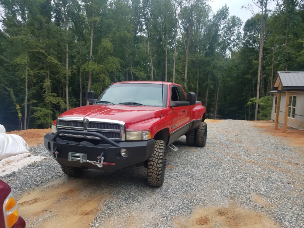

In my tow rig (dodge V10 with 5 speed manual) I currently have 3.54 gears. Tire size is slightly larger with 285/70/17s.
I use it like a truck, mainly towing and hauling. It is not a daily driver and sees very little unloaded drive time.
Would there be any benefit to swapping the 3.54s for 4.10s?
As far as towing now, it makes it, just like it did when it was a SRW... I didn’t know any better until it was a DRW, now it goes better. I am just wondering if re gearing will make it any better

Yes lower gearing will help

See how it does in 4th compared to 5th. That will be a solid indicator of 3.54 vs 4.10 gearing.

You're going to spend half that regearing it, and it's not going to make any more power. It's just going to move the gears closer together.
For what it's worth I just regeared my suburban from 3:42 to 4:10 and pretty big difference unloaded. Never comes out of overdrive now, torque converter stays locked in always now, pulls hills in OD like butter compared to before (always hunting for gears) so I'd say do it. I've not lost any gas mileage cause I just slowed down to keep rpms close to where they used to be (2100). Thought it might help you out.

My wife has a v10 Excursion (I know the power bands are a little different between the 6.8 liter ford and the 8 liter dodge but just giving my experience) with stock size 265/75-16 tires and 4.30 gears. It tows great. We've been looking at putting 35's on it and I will definitely regear to 4.88 or 5.13 if we do. I think gears are well worth the money on a tow rig.
If your currently towing in 4th, at 70mph you should be running 2553 rpm. If you regear to 4.10, in 5th you would be 2210rpm at 70. I believe I would go 4.56, that would put you 2459rpm at 70. Thats close to what you have now in 4th, like Jody said. I believe it would work well with your combo. I also doubt you will loose much fuel economy. (all the above info was found using grim jeepers calculator with your combo entered in).
I'd have to run the numbers on it but I'd be going for 4.10s or 4.56s depending on what the rpms work out for 5th at 75ish.

besides...yours is the meanest looking Dodge evah!
