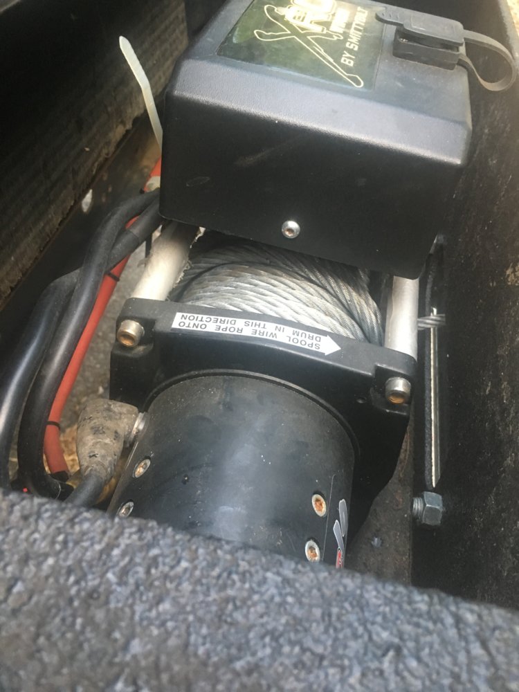

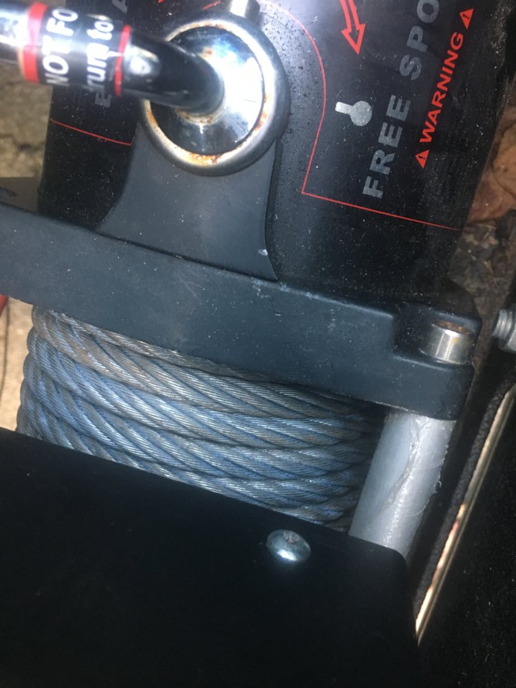

That was originally my thought for keeping cable but after this extended length pull, the cable tearing up the box and the other rods around the drum since while pulling it did not pull back in uniformly. Maybe a shorter cable would work with bubba rope on the end. I couldnt even respool the entire line, so now I have to take it all out and respool
That sounds like a normal winching experience....it's never going to lay perfectly on the drum while you're using it.

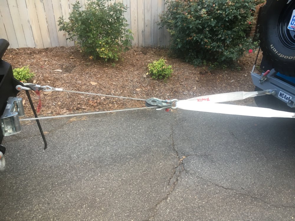

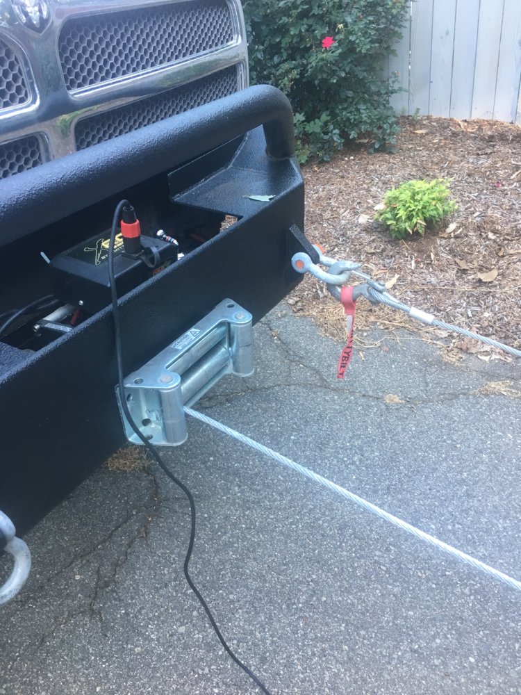

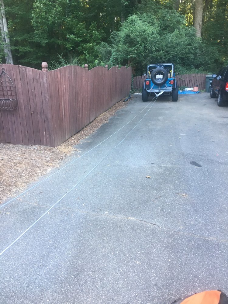

Part of cleanup after a wheeling trip is cranking the jeep in neutral, pulling out all the cable, and hooking it 100ft behind the explorer slightly uphill as an anchor and spooling in the winch as i walk in front wearing gloves guiding the cable back on neatly.
I agree; however, this was not a huge non-uniform wrap, meaning when I put it in exactly uniform, the last complete spool (from one end to the other) is gouging the control box. I either need a shorter cable or rope.

So which one of you SOBs wants to give me the "I told you so dance"?? Haha @Croatan_Kid @CasterTroy
I was meticulous with making sure each wrap was perfect. It has never fit this well on the tow rig.
I guess the jeep doesn't have this long of line because I have never had to be this precise with it.
