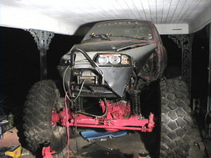

well i got it out.
well i squeezed out of the car port. i had about 4 guys sit on the back to get it out.

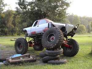

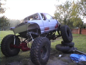

pics
more pics
Why do i feel like a little kid on christmas morning?
Once again I say....that thing is freakin huge
